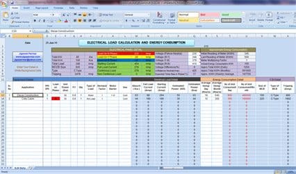

Electrical load calculation and energy consumption
This MS Excel spreadsheet calculates the following //
  • Continuous and non-continuous electrical load of panel
  • Total energy consumption (KWH) in daily/monthly of panel
  • Size of MCB of each branch circuit of panel
  • Voltage / Voltage difference of each phase
  • Unbalanced load in neutral wire
  • Expected temperature rise in each phase
  • Load in each phase
  • Starting / full load / continuous / non-continuous load
  • Size / type / tripping setting of main MCCB

    i find the same error that other people find previous me, Y and B in the amp calculation is wrong. can you send me the password for fix this?

    There is some mis formulation on sheet in Ampere of Y phase and B phase is same
    Please verify it and correct it

    In this sheet updated sheet there is minor mistake in B phase & Y phase calculation. If you enter load on Y phase automatically it will increase in B phase also . So please check it and correct if I am right than.

    You are kindly requested to check your definition of diversity factor. In electrical engineering there is no diversity factor less than one but you use 0.80. This will totally affect your whole computation. if you find any diversity less than one please email me where you got it.
    • Inns
      Oct 01, 2015
      Just noted the reference in the comments made to diversity factor: the article and associated spreadsheet is correct in using a diversity factor of 0.8 (diversity of 1 (unity) is possible in theory). If the case that a diversity factor was never less than 1 than there would be no need to ever apply a diversity factor!

    It is great and handy calculator with one exception. That is when calculating the total monthly consumption, the number of hours per day is used twice in the calculation. Please see below for details.
    Average Using/ Day (Hours) Average Using/ Month (Hours) No of Unit Consumed/Day No of Unit Consumed/Month
    18 540 900 486000
    10 300 350 105000
    • icarus51
      Mar 16, 2013
      EEP4JOE: Like you, I believe the formulas in Column “U” (# Units Consumed Per Month) are incorrect.
      For example “U13” formula is “=P13*S13*R13”. The value in Cell “S13” is already calculated as a monthly value. Multiplying “S13” by “R13” results in “U13” multiplying the daily use twice.
      Since the cells in Column “U” are protected, only the author can correct the problem..
