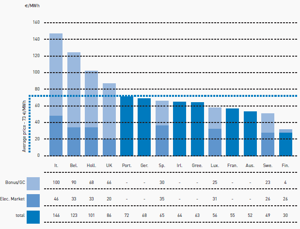

In some countries there are specific incentives given to investment in electricity production using RES. According to these special schemes, hydro, wind power and photovoltaic projects can apply for special loans with low or even zero interest rates, or receive other types of investment subsidies. Prices paid to MHP producers vary considerably among European countries. In the tariff structure different components can be found, according to the country: a market price, an avoided carbon price, a green certificate price or other forms of promotional elements.
Figure 9 illustrates some of the differences between countries. The different support schemes can affect greatly the development of micro-hydro plants. Whereas a fixed feed-in tariff reduces uncertainty and guarantees cash flow for a determined duration, market-based schemes can sometimes reveal themselves too uncertain and therefore unattractive to developers. Even if price alone is not the only factor to take into account for an investment decision, the detailed summary of individual countries’ situation found in Appendix III might prove helpful.
To estimate his revenues, the promoter of an MHPP has to estimate the production and sales during the different periods defined in the tariff legislation. Usually the tariffs have an hourly and seasonal structure to take into account the shape of the load demand curve and the marginal costs of electricity production during every period.
figure 9 - Differences in tariff structure amongEuropean Union countries
