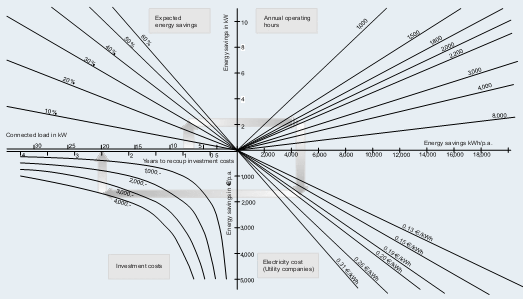

This technical article first of all shows the maximum potential savings achievable with lighting and heating controls. Using a cost table, the period for recouping the investment for a controlled office system is shown. The savings are based on the graphic”Fördergemein-schaft Gutes Licht“.
The potential savings of individual light management components adds up to 82%.

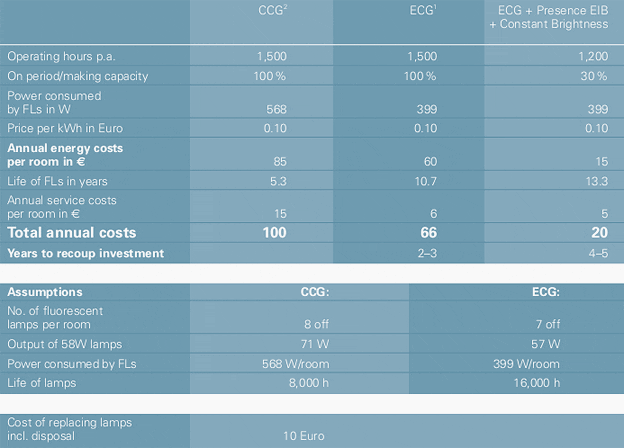

The calculated potential savings refer to an office building with a 20 m2 user area with 4 switched or controlled 58 W light units.
The life of the light units fluctuates due to the use of the control gear. Lights with conventional control gear have a lower life (8,000 h) compared to lights with electronic control gear (16,000 h). Due to the low number of operating hours of a controlled lighting system, maintenance costs are also reduced so that the cost of installing ECGs is quickly recouped.
Calculated potential savings of building
1 Electronic control gear
2 Conventional control gear
