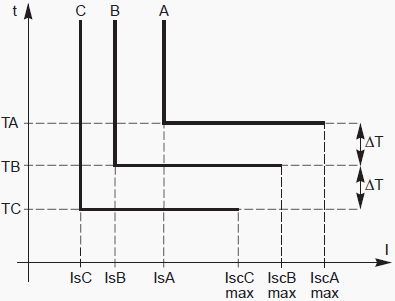

Definite time relays (fig. 5)
The conditions to be fulfilled are: IsA > IsB > IsC et TA > TB > TC.
The discrimination interval ΔT is conventionally in the range of 0.3 seconds.
Time-based discrimination with definite time relays
Figure 5 – Time-based discrimination with definite time relays
