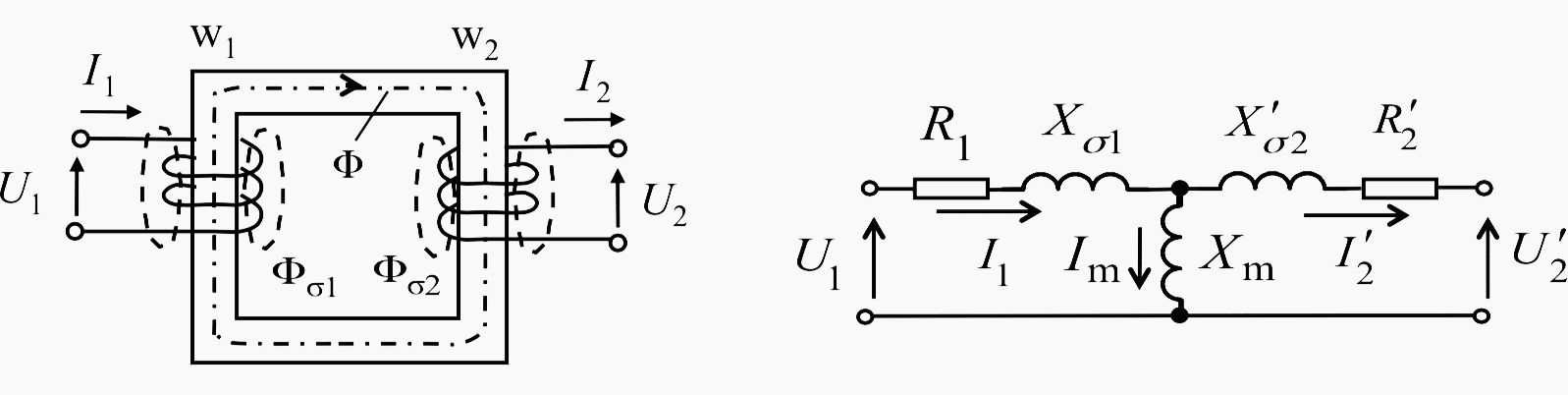

The primary and secondary winding are linked via a magnetic core by means of the main flux Φ Figure 1. To obtain the flux, the magnetising current (excitation current) Im according to the magnetising curve is required.
Equivalent circuit of a transformer
Figure 1 – Equivalent circuit of a transformer
In the electrical equivalent circuit, this excitation requirement corresponds to the main reactance Xm. The leakage flux Φσ1 and Φσ2 are only linked to their respective own windings and make up the leakage reactances Xσ1 and Xσ2 .
R1 and R’2 are the respective winding resistances. All currents and impedances are referred to the primary side.
Xm = U/Im corresponds to the slope of the magnetising curve. During load and particularly in the event of short-circuits, the operating point is below the knee-point in the steep portion of the curve.
The magnetising current at nominal voltage only amounts to approx. 0.2% In, i.e. in the non-saturated segment of the curve Xm is approx. 500 times larger than the nominal impedance of the transformer and approx. 5000 times greater than the leakage reactances.

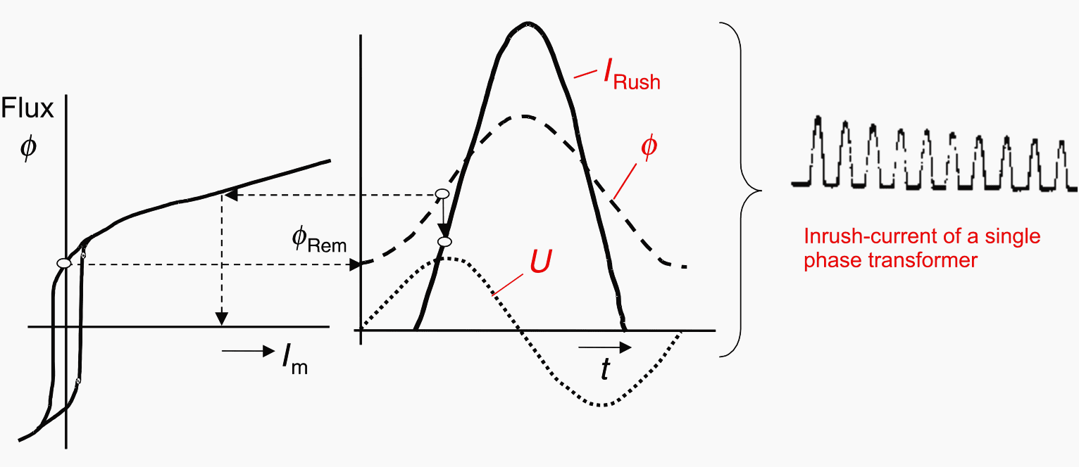

When energizing a transformer, one-sided over-excitation results, due to remanance causing large magnetising current flow (in-rush current).
The flux does not return to zero when the transformer is switched off, but remains at the remanance point ΦRem, which may be above 80% of the nominal induction. When the transformer is re-energized, the flux increase starts at this point. Depending on the energizing instant on the sinusoidal voltage (point on wave), an off-set course of the flux can result.
For the large flux values in the saturation range, a very large magnetising current is required, and cyclic current peaks will result.
The curve form corresponds with the sinusoidal half-waves of a simple half-wave rectified AC current that decays with a very large time constant (Figure 3 below).
Origin of in-rush current
Figure 3 – Origin of in-rush current

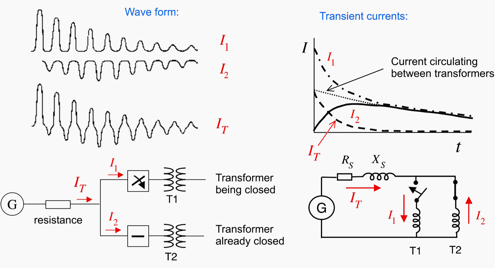

When transformers were connected in parallel, it was observed that the differential protection of the transformer that was in service issued a trip.
The reason for this is sympathetic in-rush current, which results from the rush current of the transformer that is being energized (Figure 6).
Sympathetic inrush current
Figure 6 – Sympathetic inrush current
The voltage drop resulting from the initial rush current across the source resistance of the in-feed affects the second transformer in parallel and causes the sympathetic in-rush current (I2).
The current from the system (IT) decays rapidly. However a current still circulates between the two transformers due to the small damping (large time constant τ =  X/R of the windings).

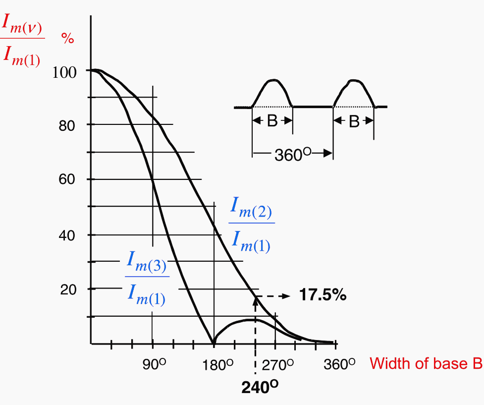

The 100(120) Hz component in the rush current depends on the base width of the sinusoidal caps (as shown in Figure 7).
It decreases as the base width B increases.
Investigations have shown that a base width greater than 240° hardly ever arises in practice, which implies a minimum second harmonic component of 17.5%. A setting of 15% therefore makes sense for in-rush blocking.
The 3rd harmonic may not be used for in-rush blocking, as it is strongly represented in the short-circuit current when CT saturation takes place.
Harmonic content of in-rush current
Figure 7 – Harmonic content of in-rush current
A more sensitive setting than 15% of the second harmonic should normally not be applied as the off-set short-circuit current will also have a second harmonic component in case of CT saturation.
In rare cases, for example with weak in-feed, a soft energization with a very small second harmonic component may occur. Under these conditions, a reduced setting of e.g. 12% may be considered. Preference should however be given to the cross-blocking function.

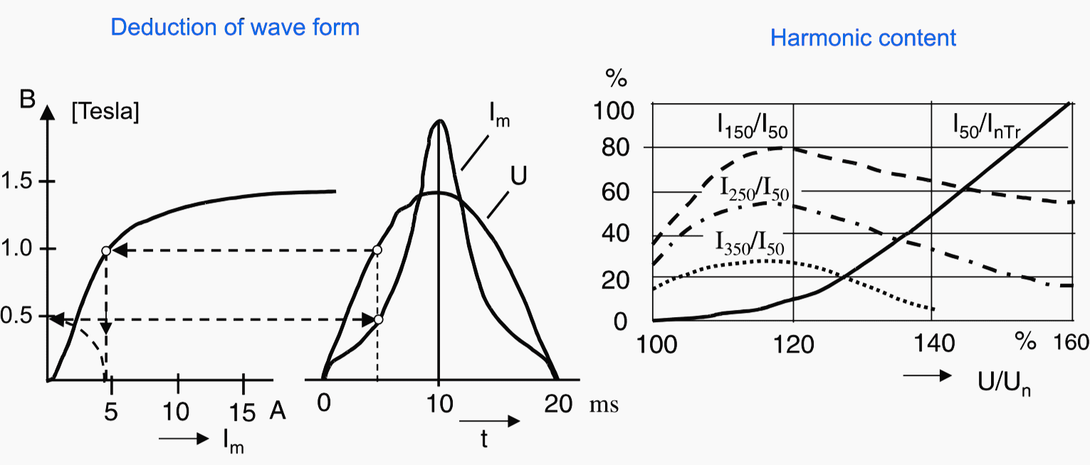

If the transformer is operated with excessively high voltage, then the required magnetization is also increased. The magnetizing current rises sharply when the operating point on the magnetizing curve is close to the point of saturation.
The wave form becomes more and more distorted with increasing odd harmonic content (as shown in Figure 8).
Magnetising current in the event of transformer over-fluxing
Figure 8 – Magnetising current in the event of transformer over-fluxing
The increased magnetising current appears as a tripping current in the differential protection with large overvoltage. This can cause tripping, depending on the con- figuration of the transformer.
