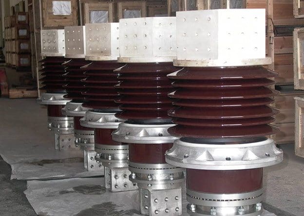

Transformer porcelain bushings spare parts
Transformer porcelain bushings spare parts (Pure porcelain structure, copper conductor, with low temperature rise and good heat dissipation.)
Solid porcelain bushings consist of high-grade porcelain cylinders that conductors pass through. Outside surfaces have a series of skirts to increase the leakage path distance to the grounded metal case. High-voltage bushings are generally oil-filled condenser type.
Condenser types have a central conductor wound with alternating layers of paper insulation and tin foil and filled with insulating oil.
