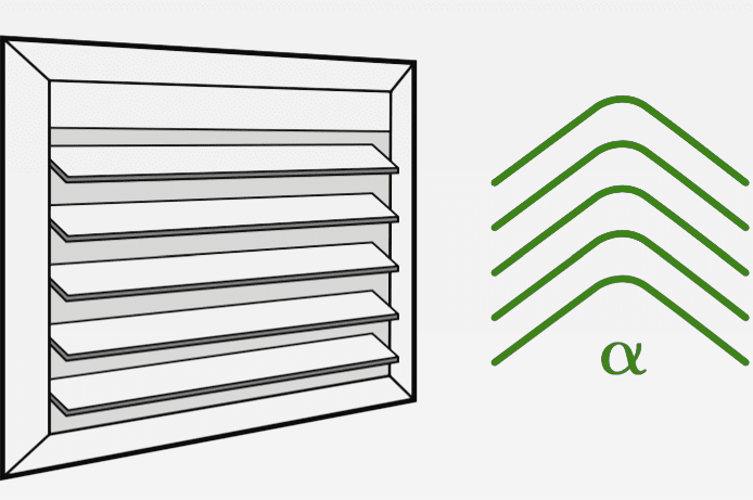

Figure 2 – Coefficient of pressure losses defined by air flow tests
Figure 2 - IP23 Chevrons blade
IP23 Chevrons blade
IP23 Chevrons blade
(ξ = 33 if α = 60°, and ξ = 12 if α = 90°)
Space between blade is extended to the maximum allowed by the degree of protection IP2x so below 12.5mm.
Other openings:
IP43 Additional vermin proof wire mesh with 1mm2 openings using a wire thickness 0.6mm, complete covering ventilation grid ≥ ξ + 5
IP23 38mm × 10mm openings only: ξ = 9
The required ventilation opening surface areas S and S’ can be estimated using the following formulas, with or without knowing the air ow resistance coefficient of the ventilation grids.
  1. Formula 1: Qnac = P – Qcw – Qaf is the dissipation by natural air circulation [kW]
  2. Formula 2:
    S
    = 1.8 × 10-1 Qnac/√H if air flow resistance is unknown
    S’ = 1.1 × S – S and S’ are efficient net area.
    Chevrons blade
    • S = Qnac / ( Kx √ H × (θ2 – θ1)3 ) with K = 0.222 (1 / ξ) see Fig C
    • S’= 1.1 × S – S and S’ are the gross area.
