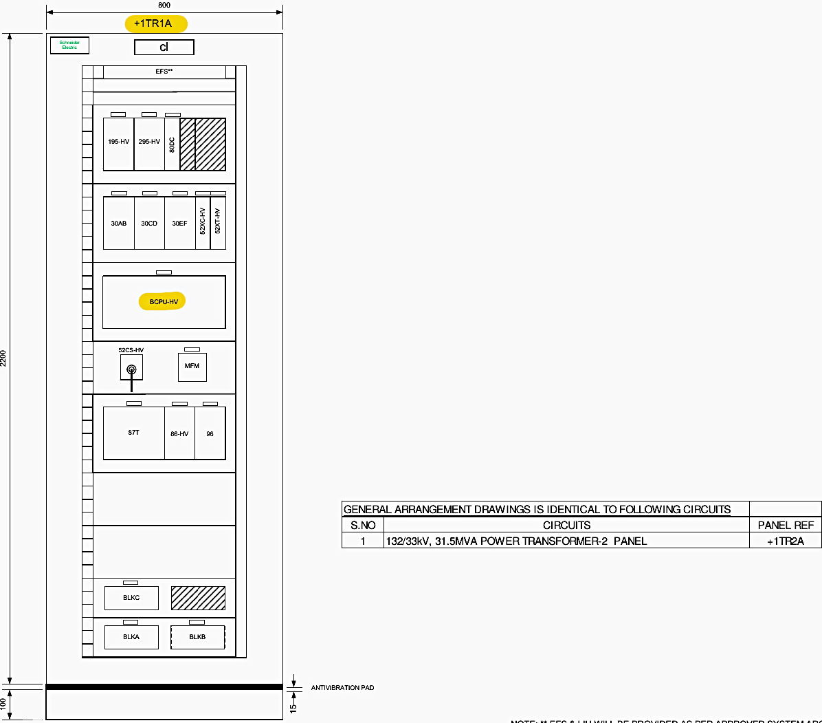

The physical layout of the +1TR1A panel is meticulously designed to optimize operator access while physically separating discrete protection zones.
Front View Arrangement (+1TR1A): As explicitly illustrated on Page 3 (Sheet 001), Row C, Columns 2-5, the front panel prominently features the MICOM P642 (87T) relay. This numerical relay serves as the brain for the Transformer Differential Protection.
The differential protection principle relies on Kirchhoff’s Current Law, comparing the current entering the transformer to the current exiting it. If the vector sum of these currents (compensated for the transformer’s turn ratio and vector group) is not zero, the relay calculates a differential current and trips the system, identifying an internal fault.
Bay Control Unit: Flanking the differential relay is the BCPU-HV (C264P) unit (Page 3, Row C, Column 5). The C264P acts as a substation automation gateway, utilizing the IEC 61850 protocol to communicate via goose messages for non-directional overcurrent, earth fault protection, and localized automation.
Figure 1 – Front view of the +1TR1A protection panel
Electromechanical Trip Relays: Below the IEDs sit the Master Trip Relays (86-HV) and the Local Breaker Backup (LBB) Trip Relay (96). According to the Bill of Materials on Page 4, Row D, Column 3, the 86-HV and 96 relays are Easun GBTR241 high-speed, high-burden trip relays.
High-burden relays are critical because they require a significant amount of energy to operate, which prevents spurious trips caused by induced voltages or minor ground faults in the DC battery system.
They feature a 16-make, 4-break (16M 4B) contact configuration, meaning one trip command can simultaneously trigger 16 separate safety actions across the substation.

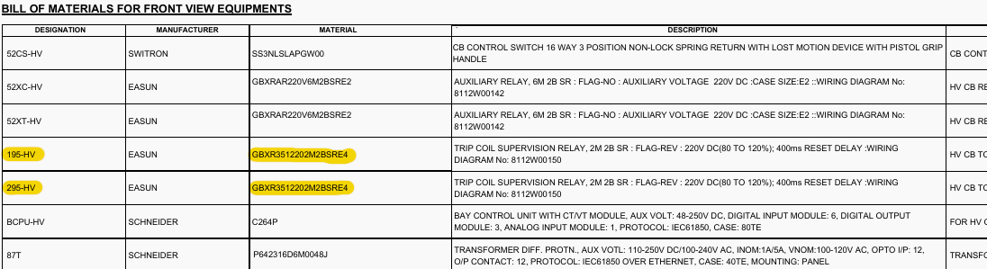

Trip Coil Supervision: The Trip Coil Supervision Relays for the high-voltage side (195-HV and 295-HV) are identified as Easun GBXR351 models configured with a 400ms reset delay (Page 4, Row C, Column 1). These relays inject a tiny, continuous trickle current through the heavy-duty trip coils of the circuit breaker.
If the coil breaks or loses continuity, the relay drops out and triggers an alarm. The 400ms delay prevents the relay from initiating false alarms during the brief moment the circuit breaker successfully opens.

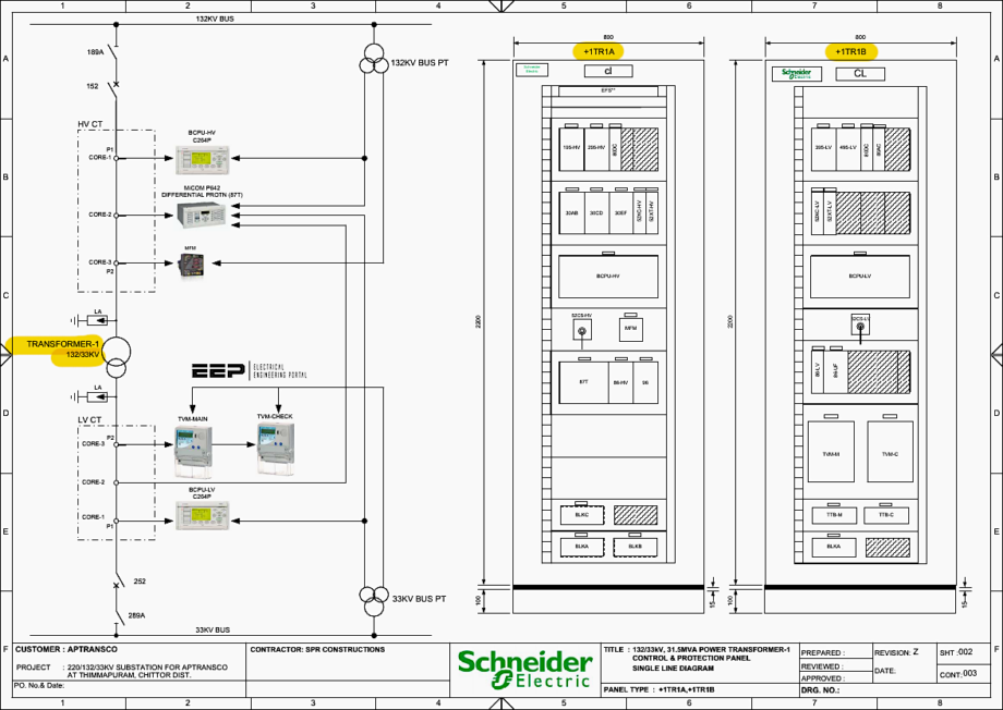

2. Single Line Diagram (SLD) and Power Routing
The macroscopic electrical routing and primary sensing equipment are mapped on the Single Line Diagram (Page 16).

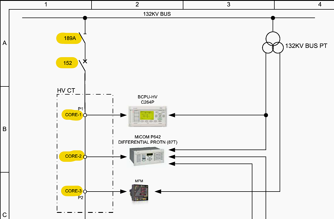

132kV Incomer and High Voltage Switchgear: The power flow originates at the 132KV BUS (Page 16, Row A, Column 1). It passes through the 189A Motorized Isolator (Page 16, Row A, Column 2). Isolators are off-load devices used to physically and visibly disconnect the transformer from the grid for maintenance.
Following the isolator is the 152 High Voltage Circuit Breaker (Page 16, Row A, Column 3). The circuit breaker is an on-load device containing SF6 gas to quench the massive electrical arc generated when breaking 132kV fault currents.
Figure 3 – 132kV side: 189A Motorized Isolator and 152 Circuit Breaker and CTs
Figure 3 – 189A Motorized Isolator and 152 Circuit Breaker and CTs
Current Transformers (CTs) – HV Side: Positioned immediately after the breaker are the HV CTs (Page 16, Row B, Column 2). These step down the massive primary currents to measurable secondary currents (1 Ampere) for the relays. The CTs feature three distinct cores to mathematically segregate duties:
  • Core-1 (Class 5P20): Rated at 300-200-100/1A (Page 16, Row C, Column 6). The “5P20” designation means it guarantees 5% accuracy at 20 times the rated current. This core is wired directly to the BCPU-HV for standard overcurrent and earth fault protection.
  • Core-2 (Class PS): This Protection Special (PS) core (Page 16, Row D, Column 6) is exclusively dedicated to the MICOM P642 Differential Protection.
    PS class CTs have highly specific knee-point voltages to ensure they do not saturate during heavy external faults, which could cause the 87T relay to falsely trip.
  • Core-3 (Class 0.2): This core (Page 16, Row E, Column 6) interfaces with the metering circuits, guaranteeing 0.2% accuracy for billing and telemetry.

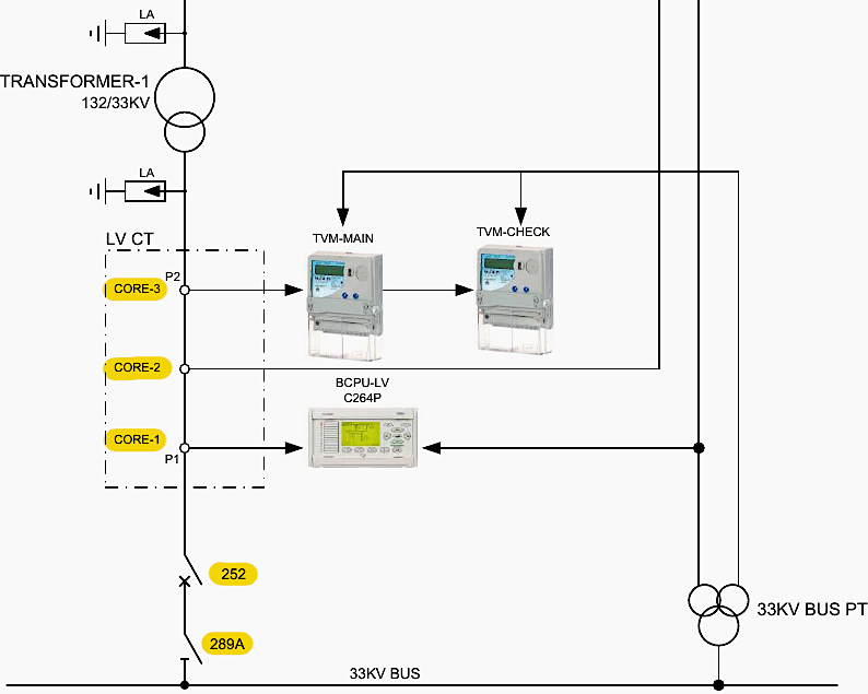

33kV Feeder and Low Voltage Switchgear: Power transforms and exits to the low voltage side, routing through the 33kV LV CTs (Page 16, Row D, Column 3). These utilize an identical three-core philosophy but with a stepped ratio of 1200-800-400/1-0.5775A to account for the increased current at the lower voltage.
Finally, power moves through the 252 LV Circuit Breaker and 289A LV Isolator before terminating at the 33KV BUS (Page 16, Row E, Column 4).

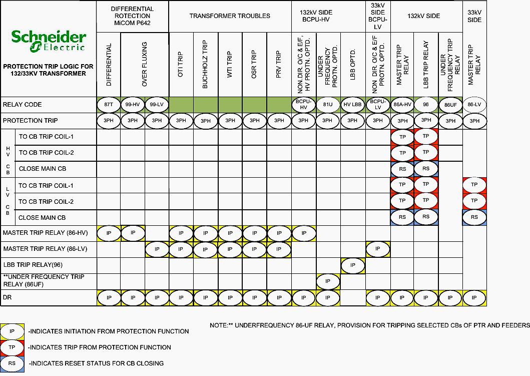

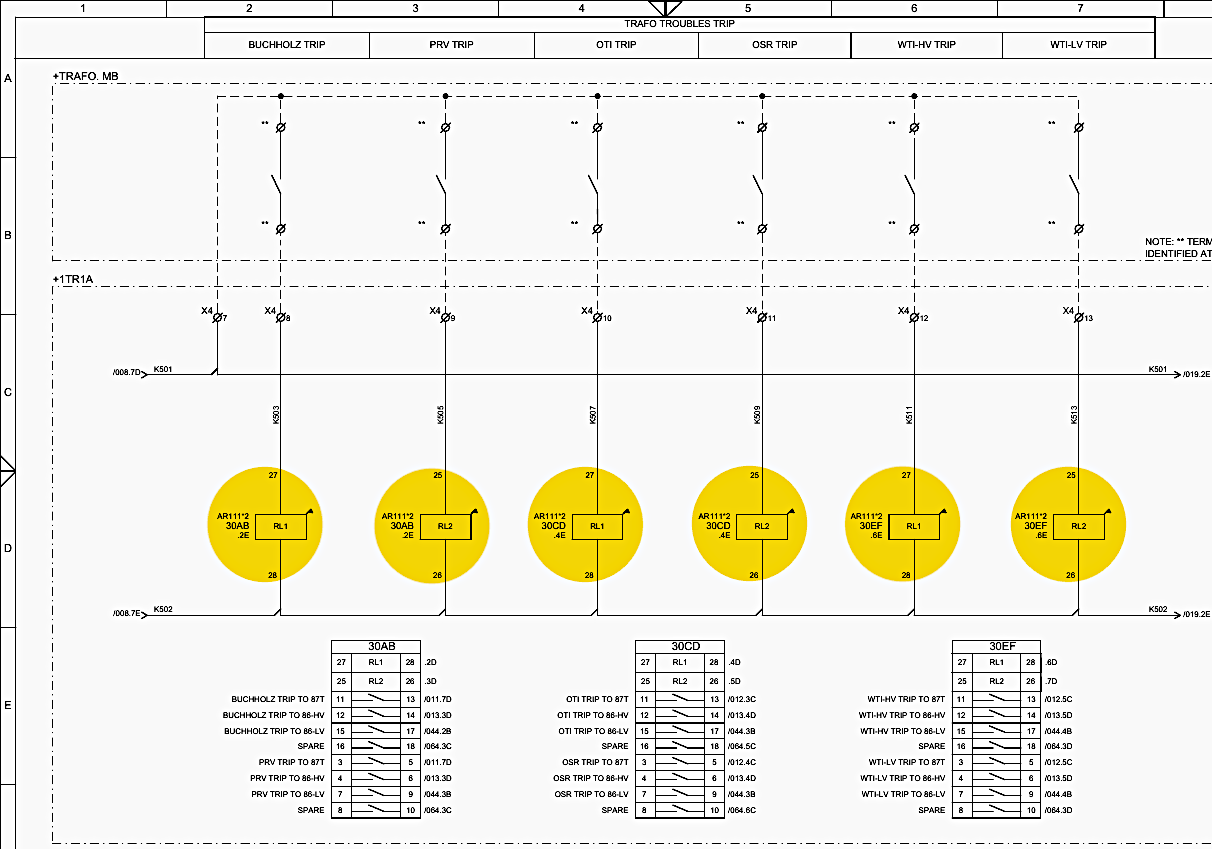

Page 17 establishes the critical Boolean logic mapping between fault detections and the resulting circuit breaker trip commands. This matrix dictates how the substation reacts to different classes of catastrophic failures.
Electrical Faults: The 87T Differential Protection (Page 17, Row B, Column 2) and the Over Fluxing Protection (99-HV/99-LV) are primary electrical safeguards.
Upon detecting an internal fault, the 87T relay simultaneously issues an immediate 3-phase trip (TP) to both the 86A-HV (High Voltage Master Trip) and 86-LV (Low Voltage Master Trip) relays (Page 17, Row C, Column 2). This totally isolates the transformer, preventing grid power from feeding the fault and stopping back-feed from the 33kV distribution network.
Transformer Troubles (Mechanical and Thermal): The logic on Page 17, Row B, Column 4 defines how physical transformer distresses are handled.
Buchholz Relay: Detects gas accumulation from arcing in the oil. It maps directly to both the HV and LV master trip relays for a total, instantaneous shutdown.
Oil Surge Relay (OSR) and Pressure Relief Valve (PRV): These detect sudden, explosive pressure spikes inside the OLTC (On-Load Tap Changer) or main tank. They also map to both 86-HV and 86-LV for total isolation.
Temperature Indicators: Thermal overload indicators are localized to prevent unnecessary total grid loss. The WTI-HV (Winding Temperature Indicator – High Voltage) only trips the 86A-HV relay, while the WTI-LV isolates the 86-LV relay. Oil Temperature Indicators (OTI) trip both sides to allow the oil to cool rapidly.

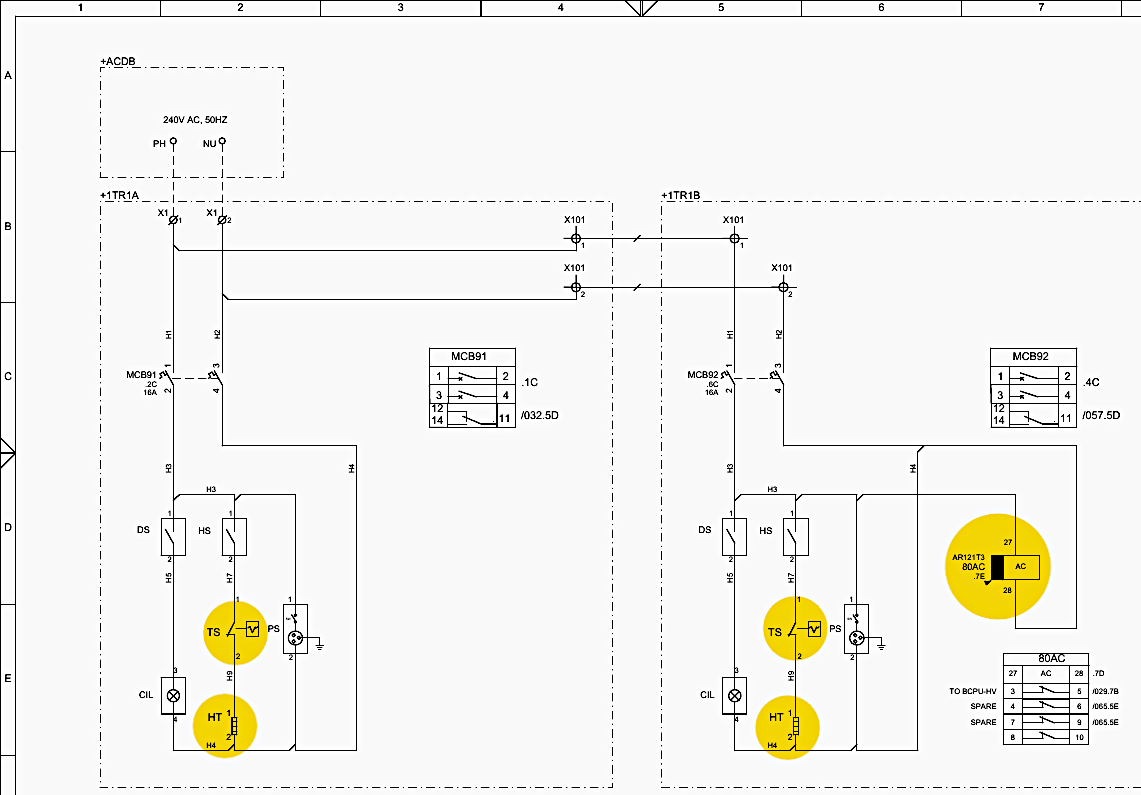

AC Distribution System: Detailed on Page 18 (Rows A-E), a 240V AC, 50Hz supply is distributed from the substation’s main +ACDB panel. A 16-Ampere Double Pole Miniature Circuit Breaker (MCB91) regulates the primary feed into the +1TR1A panel.
This power is not for protection; it drives environmental controls. The current flows to the panel heater (HT) through a mechanical thermostat (TS) (Page 18, Row E, Column 2). By maintaining a stable internal temperature, the thermostat prevents condensation from forming on the sensitive printed circuit boards of the numerical relays, which could cause devastating short circuits.
Furthermore, an 80AC supervision relay constantly monitors this voltage.

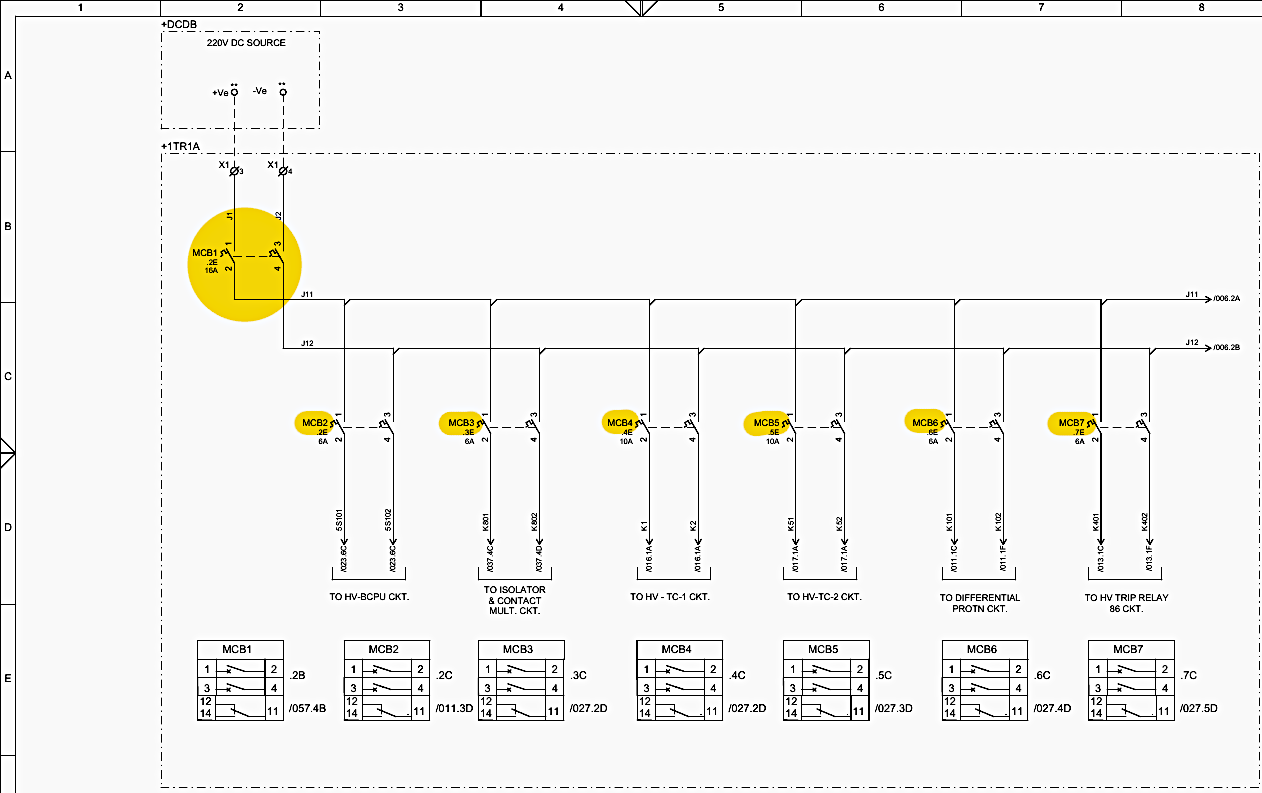

DC Distribution System: The critical 220V DC supply, drawn from a massive battery bank to ensure power during blackouts, is meticulously partitioned on Page 19 (Rows A-F). From the +DCDB source, current passes through a master 16A breaker (MCB1).
It is then aggressively subdivided into isolated radials. This subdivision is a core tenet of protection engineering: a single secondary fault must never blind the entire protection scheme.
  • MCB4 (10A) exclusively feeds the HV CB Trip Coil 1 (TC-1) circuit (Page 19, Row C, Column 4).
  • MCB5 (10A) provides redundant power to the HV CB Trip Coil 2 (TC-2) circuit (Page 19, Row C, Column 5).
  • MCB6 (6A) strictly powers the MICOM P642 Differential Relay.
  • MCB7 (6A) is dedicated solely to energizing the Master Trip Relay 86-HV.

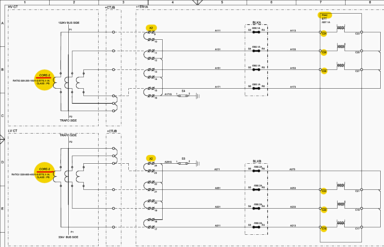

CT Wiring for 87T: Mapped on Pages 23 and 24, the secondary wires from the HV CTs (Core-2, Class PS) are routed from the switchyard to the panel. They pass through a specialized disconnecting test terminal block (X2) before reaching the MICOM P642 relay inputs C24, C26, and C28 (Page 23, Row C, Column 7).
The 33kV LV CTs are similarly routed to inputs C22, C20, and C18 (Page 23, Row D, Column 7).
The test terminal block allows engineers to short-circuit the CTs during maintenance; opening a live CT circuit without shorting it will generate thousands of volts, destroying the relay and risking fatal electrocution.
Potential Transformer (PT) Extensions: The 132kV Bus PT circuit (Page 21) extends the 110V AC protection core (Core-1) via terminal block X3 directly to the BCPU-HV (Page 21, Row C, Column 8). This provides the bay controller with accurate grid voltage telemetry, essential for calculating power directionality, executing synchronization checks before closing the breaker, and generating undervoltage/overvoltage alarms.

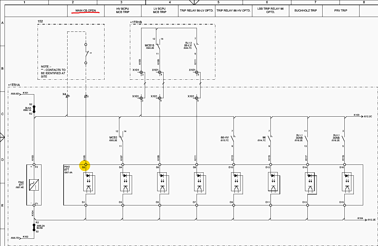

Numerical relays and BCPUs rely on opto-isolators to safely read the status of high-voltage switchyard equipment.
Differential Relay Opto-Inputs: Page 25 (Sheet 011) shows how 220V DC wet contacts interface with the MICOM P642. For example, the “MAIN CB OPEN” status is routed to opto-input D2 (Page 25, Row C, Column 2). When the breaker opens, a mechanical switch closes, sending 220V DC to terminal D2.
Inside the relay, this voltage lights an LED, which shines on a phototransistor. This optical gap physically protects the relay’s delicate 5V microprocessors from the 220V DC switchyard transients.

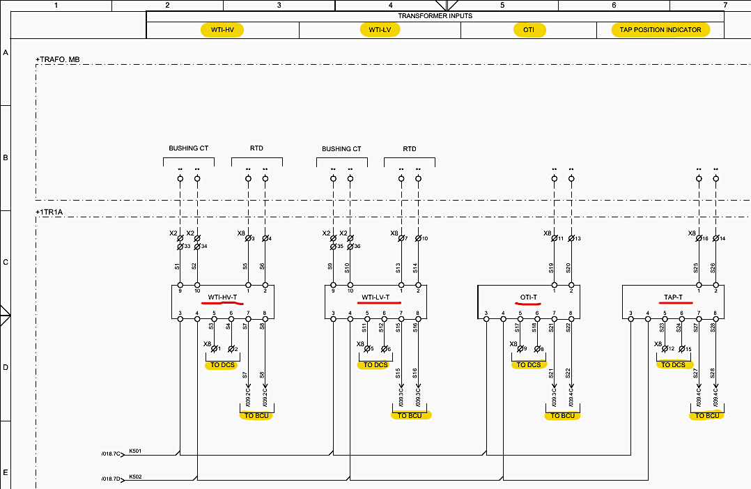

Analog Transducer Circuits: For continuous analog monitoring, Page 33 maps the routing of the Winding Temperature (WTI), Oil Temperature (OTI), and Tap Position transducers. The WTI-HV-T transducer receives dual inputs:
  1. Resistive Temperature Detector (RTD) submerged in the transformer oil, and
  2. Current feed from a Bushing CT.
By measuring both the base oil temperature and the current load, the transducer dynamically calculates the winding “hot-spot” temperature. It subsequently outputs an industry-standard 4-20mA analog signal to the Distributed Control System (DCS) and the BCPU (Page 33, Row C, Columns 2-4).

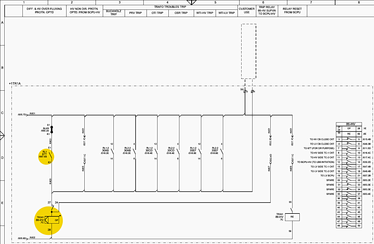

When a fault is calculated, the numerical relays do not have the physical contact strength to break the high currents required by the switchyard circuit breaker trip coils. They rely on intermediate execution hardware.
86-HV Master Trip Relay: Located on Page 27, this GBTR241 relay is the primary execution core for the 132kV side. It features a heavy-duty operation coil (OP) located at Page 27, Row E, Column 2. This coil is energized by the delicate contacts of the 87T relay (RL1), or mechanically driven auxiliary relays from the Buchholz, PRV, or OTI trips.
Upon activation, the 86-HV coil pulls in an armature that mechanically latches in place. Its outgoing contacts physically snap open, breaking the HV CB closing circuit (Page 27, Row C, Column 6, terminal 56) to prevent accidental re-closing.
Simultaneously, normally-open contacts slam shut, driving 220V DC at high amperage directly to both the HV TC-1 and TC-2 trip coils. Because it mechanically latches, an operator must physically walk to the panel and manually reset the flag before the grid can be restored, ensuring the fault is investigated.

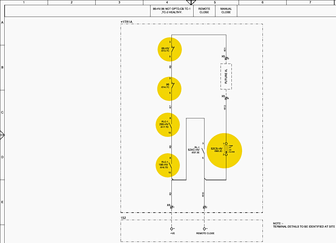

Closing Circuit (152 HV CB): Page 29 outlines the strict electrical interlocks required to safely close the primary 132kV breaker. The 220V DC must navigate a complex series of permissive contacts to complete the closing path to terminal X5 (Page 29, Row E, Column 4). The following conditions are absolutely mandatory:
  1. The 86-HV and 96 trip relays must be manually reset (verified by normally-closed contacts at Row C, Column 4).
  2. Both Trip Coil 1 and Trip Coil 2 must be verified as intact and healthy by the 195-HV and 295-HV supervision relays.
  3. The local/remote selector switch (52CS-HV) must be in the correct operational orientation.
If any single condition fails, the circuit physically cannot close.

Tripping Circuits (HV TC-1 and TC-2): Redundancy is the defining characteristic of the tripping architecture on Pages 30 and 31. The TC-1 circuit (Page 30, Row C) provides multiple parallel pathways for the DC voltage to reach the trip coil. A trip can be initiated manually via the pistol grip switch (52CS-HV), remotely via SCADA (using the 52XT-HV relay), or automatically by the protective relays (96 or 86-HV).
The XR351 supervision relay constantly monitors the continuity of this coil circuit (Page 30, Row C, Column 6). Because the tripping circuit has fewer interlocks than the closing circuit (the breaker must always be allowed to trip, even if supervision fails), TC-2 (Page 31) acts as an identical, physically separate backup system fed from a different DC MCB.

Mechanical fault signals originating from the transformer body (Buchholz gas sensors, Oil Surge Relays, Pressure Relief Valves) operate via small internal microswitches. These switches are low-current capable and would burn out if forced to directly drive heavy tripping coils.
Multiplying Auxiliary Relays: To solve this, the schematic utilizes “multiplying relays,” as demonstrated on Page 32. When a Buchholz float drops due to gas buildup, it sends a small signal to energize auxiliary relay 30AB (Page 32, Row D, Column 2).
The 30AB relay is a GBAR111 high-speed relay equipped with multiple high-current capable contacts. These multiplied contacts are then distributed radially: one triggers the numerical 87T logic for event recording, another directly fires the 86-HV master relay, and a third fires the 86-LV master relay (Page 32, Row D, Columns 1-4).
This allows a single, fragile sensor on the transformer to safely provide a massive, multi-megawatt shutdown.

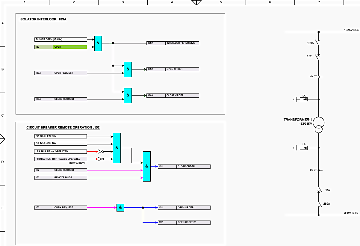

189A Isolator Safety Logic: Page 89 outlines the Boolean logic governing the motorized 132kV isolator. Isolators do not have arc-quenching capabilities. If an isolator is opened while current is flowing, it will draw an unquenchable, vaporizing plasma arc that will destroy the switchyard.
Therefore, Page 89, Row B, Column 4 defines an AND gate that states the 189A isolator can only receive an “OPEN PERMISSIVE” or “CLOSE PERMISSIVE” command if the 152 Circuit Breaker is explicitly confirmed to be in the “OPEN” state (zero current flow). Furthermore, the bus earth switch must also be open.
Figure 13 – BCPU interlock logics
Remote Operation Interlocks (152 Breaker): To execute a remote SCADA close command on the 152 breaker (Page 74, Row C, Column 5), the BCPU relies on a massive internal Boolean AND gate.
The logic strictly requires that TC-1 is healthy, TC-2 is healthy, the LBB relay has not operated, no primary protection trip relays (86HV & 86LV) are currently operated or un-reset, and the Bay Local/Remote physical switch is explicitly set to Remote.
