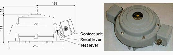

2. Pressure Relay
Many power transformers with an on-tank-type tap changer have a pressure protection for the separate tap changer oil compartment. This protection detects a sudden rate-of-increase of pressure inside the tap changer oil enclosure.
Figure 3 shows the principle of a pressure relay.
Pressure relay
Figure 3 – Pressure relay
When the pressure in front of the piston exceeds the counter force of the spring, the piston will move operating the switching contacts. The micro switch inside the switching unit is hermetically sealed and pressurized with nitrogen gas.
An internal fault in an oil-filled transformer is usually accompanied by overpressure in the transformer tank.
The simplest form of pressure relief device is the widely used frangible disk. The surge of oil caused by a heavy internal fault bursts the disk and allows the oil to discharge rapidly. Relieving and limiting the pressure rise prevent explosive rupture of the tank and consequent fire.
Also, if used, the separate tap changer oil enclosure can be fitted with a pressure relief device.
Principle construction of a pressure relief device
Figure 4 – Principle construction of a pressure relief device
The pressure relief device can be fitted with contact unit(s) to provide a signal for circuit breaker(s) tripping circuits.
A pressure relief device with contact units
Figure 5 – A pressure relief device with contact units
A drawback of the frangible disk is that the oil remaining in the tank is left exposed to the atmosphere after a rupture. This is avoided in a more effective device, the pressure relief valve, which opens to allow the discharge of oil if the pressure exceeds the pre-adjusted limit.
By providing the transformer with a pressure relief valve, the overpressure can be limited to a magnitude harmless to the transformer.
If the abnormal pressure is relatively high, this spring-controlled valve can operate within a few milliseconds and provide fast tripping when suitable contacts are fitted. The valve closes automatically as the internal pressure falls below a critical level.

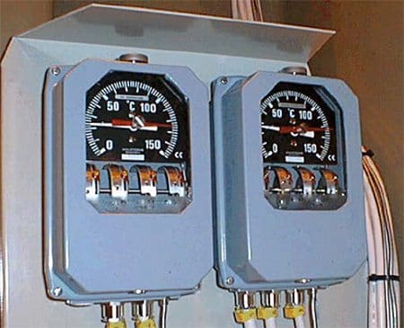

4. Winding Thermometer
The winding thermometer, shown in the figure below, responds to both the top-oil temperature and the heating effect of the load current.
Capillary type of winding thermometer
Figure 8 – Capillary type of winding thermometer
The winding thermometer creates an image of the hottest part of the winding. The top-oil temperature is measured with a similar method as introduced earlier. The measurement is further expanded with a current signal proportional to the loading current in the winding.
This current signal is taken from a current transformer located inside the bushing of that particular winding. This current is lead to a resistor element in the main unit. This resistor heats up, and as a result of the current flowing through it, it will in its turn heat up the measurement bellow, resulting in an increased indicator movement.
Top-oil thermometer and winding thermometer main units fitted on the side of a power transformer
Figure 9 – Top-oil thermometer and winding thermometer main units fitted on the side of a power transformer
The temperature bias is proportional to the resistance of the electric heating (resistor) element.
The result of the heat run provides data to adjust the resistance and thereby the temperature bias. The bias should correspond to the difference between the hot-spot temperature and the top-oil temperature. The time constant of the heating of the pocket should match the time constant of the heating of the winding.
The temperature sensor then measures a temperature that is equal to the winding temperature if the bias is equal to the temperature difference and the time constants are equal.
The winding thermometer can have one to four contacts, which sequentially close at successively higher temperature.
With four contacts fitted, the two lowest levels are commonly used to start fans or pumps for forced cooling, the third level to initiate an alarm and the fourth step to trip load breakers or de-energize the transformer or both.
In case a power transformer is fitted with top-oil thermometer and winding thermometer, the latter one normally takes care of the forced cooling control.
