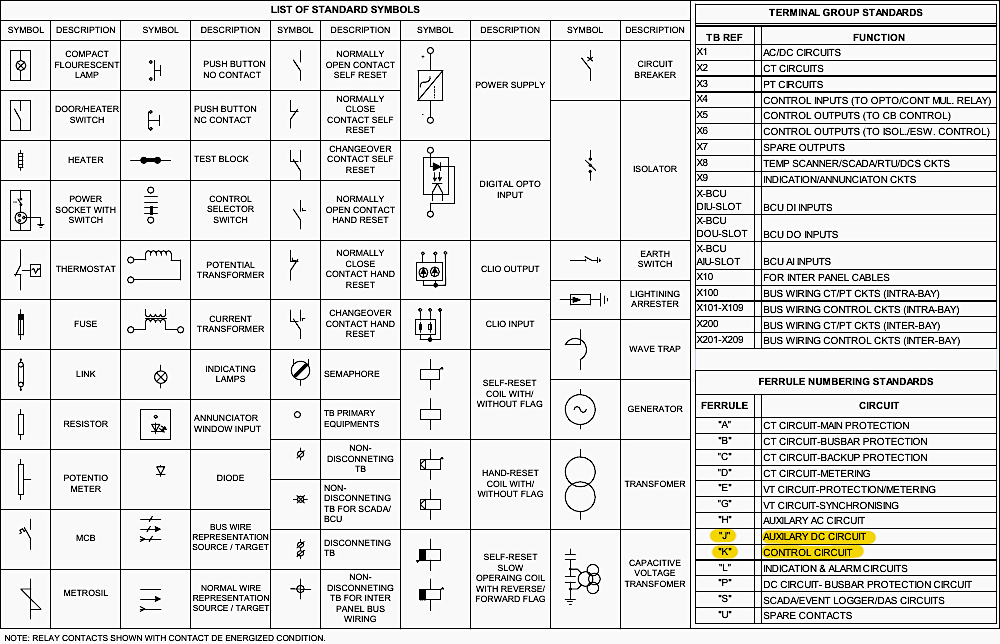

1.1 Standardized Ferrule Numbering Conventions
According to the “List of Symbols” detailed on Sheet 001 (Page 12), the wiring schematic strictly adheres to an alphanumeric ferrule numbering standard that denotes the specific function of the wire. This guarantees organized fault tracing and precise isolation during maintenance.
The primary ferrule prefixes applicable to the Reactor Troubles Circuit are:
  • Prefix “J”: Denotes Auxiliary DC Circuits. Wires carrying the raw 220V DC supply from the DC Distribution Board (DCDB) to the panel isolation switches and fuse links are designated with ‘J‘ (e.g., J101, J103).
  • Prefix “K”: Denotes Control Circuits. Wires actively carrying trip initiation logic, interlocks, and the manipulated DC rails following the auxiliary relays are designated with ‘K‘ (e.g., K101, K103, K201).
This strict segregation ensures that engineers analyzing the physical panel can instantly differentiate between a permanent power rail (‘J‘) and an actively switched control logic rail (‘K‘).
Figure 1 – The primary ferrule prefixes applicable to the Reactor Troubles Circuit (click to zoom)

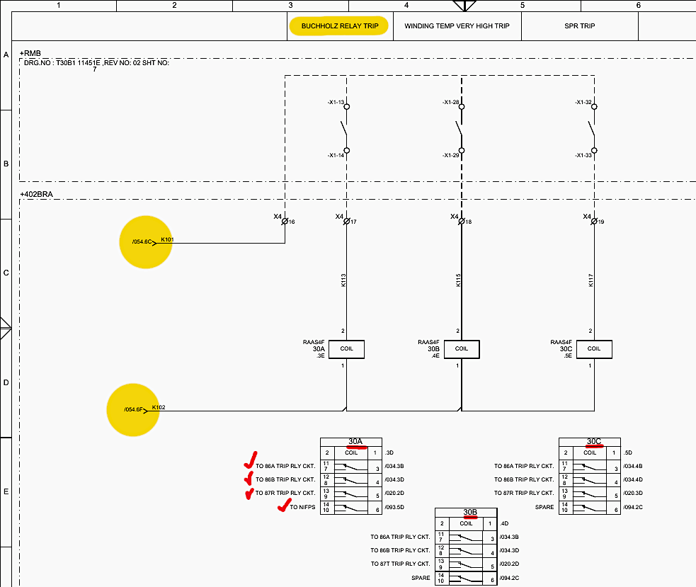

2.1 Buchholz Relay-1 Trip Circuit (Relay 30A)
Reference Location: Page 43, Row A, Column 2 (Input Terminals); Page 43, Row B, Column 2 (Relay Coil); Page 43, Rows C and D, Column 2 (Contact Distribution).
Operational Physics and Principle: The Buchholz relay is an indispensable gas and oil-actuated protective device installed inline within the pipework connecting the main reactor tank to the conservator tank. It operates on a highly reliable dual-float mechanical principle.
Minor, slowly developing faults (such as localized tracking, core bolt insulation failure, or low-energy partial discharges) produce small volumes of gas that accumulate in the upper chamber of the relay. This gradually displaces the oil and lowers the top float to trigger a non-tripping alarm.
However, a major internal fault, such as a severe inter-turn short circuit, creates a rapid, violent volumetric expansion of gas and oil due to extreme localized heating. This massive oil surge flows forcefully toward the conservator, impacting the lower baffle plate or lower float within the Buchholz relay.
The physical impact deflects the baffle, closing a magnetically coupled reed switch or a highly reliable mercury switch.
Figure 3 – Buchholz Relay-1 Trip Circuit (Relay 30A) (click to zoom)
Circuit Logic and Routing: The closure of the Buchholz field contact completes the electrical circuit across terminals -X1-28 and -X1-13 (located at Page 43, Row A, Column 2). This action routes the positive 220V DC rail through the field wiring and back into the CRP panel, actively energizing the coil of auxiliary relay 30A.
Once relay 30A is fully energized, its 4 C/O contacts change state (located at Page 43, Rows C and D, Column 2). The schematic dictates the following precise routing matrix for these highly critical contacts:
  • Contact 1 (Terminals 1-2): Routed to the 86A TRIP RLY CKT (Grid reference /034.3B). This initiates the primary Group A Master Trip Relay, executing an unconditioned opening of the 400kV circuit breaker.
  • Contact 2 (Terminals 3-4): Routed to the 86B TRIP RLY CKT (Grid reference /034.3D). This provides absolute redundancy by initiating the secondary Group B Master Trip Relay.
  • Contact 3 (Terminals 5-6): Routed to the 87R TRIP RLY CKT (Grid reference /020.2C). This sends a direct hardware signal to the Bay-402 Differential Protection Relay (MICOM P643).
    The P643 utilizes this discrete opto-isolated input to log the exact millisecond event in its disturbance recorder, append the data to its Sequence of Events (SOE) log, and broadcast a GOOSE message across the IEC 61850 station bus to inform adjacent bays of a severe internal reactor fault.
  • Contact 4 (Terminals 7-8): Routed to the NIFPS (Nitrogen Injection Fire Protection System) interface (Grid reference /093.5C).
Because a Buchholz trip frequently indicates a high-energy arcing fault with a severe risk of tank rupture and ensuing oil fire, this contact immediately arms or initiates the NIFPS.
The NIFPS responds by rapidly draining a portion of the top oil and injecting pressurized nitrogen gas from the base of the tank to stir the oil, cool the core, extinguish internal combustion, and prevent atmospheric oxygen from sustaining a fire.
