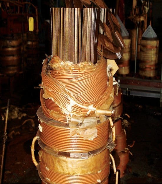

2. Core faults
Core faults due to insulation breakdown can permit sufficient eddy-current to flow to cause overheating, which may reach a magnitude sufficient to damage the winding.
Damage to inside of coil winding stack of oil-filled transformer
Figure 1 – Damage to inside of coil winding stack of oil-filled transformer (photo credit: forensic.cc)

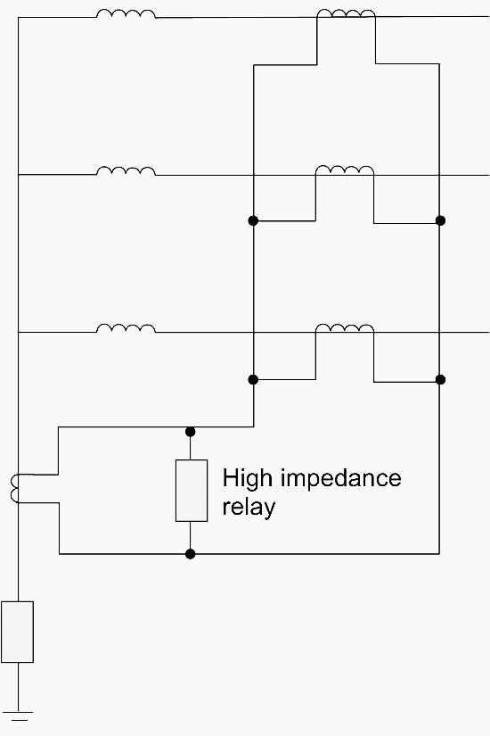

Restricted earth fault protection is utilized for Y-connected windings. This scheme is shown in Figure 4. The sum of the phase currents is balanced against the neutral current, and hence the relay will not respond to faults outside the winding.
Restricted Ground Fault Protection for a Y Winding
Figure 4 – Restricted Ground Fault Protection for a Y Winding
