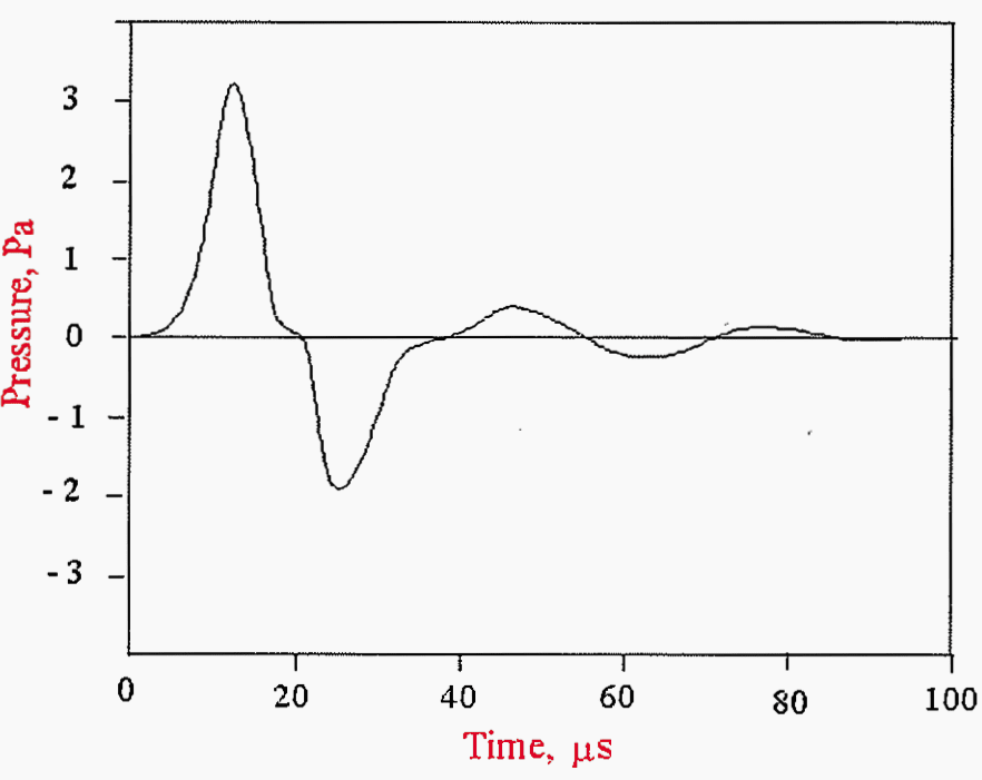

The typical shape of a single acoustic pulse generated by a pulsative corona discharge is shown in Figure 3 below.
Corona generated acoustic pulse
Figure 3 – Corona generated acoustic pulse
The acoustic pulses due to both positive and negative corona have similar shapes, but the amplitudes at positive polarity are an order of magnitude higher than those at negative polarity, similar to current pulse amplitudes. As in the case of EMI, therefore, positive corona is the main source of audible noise on transmission lines.

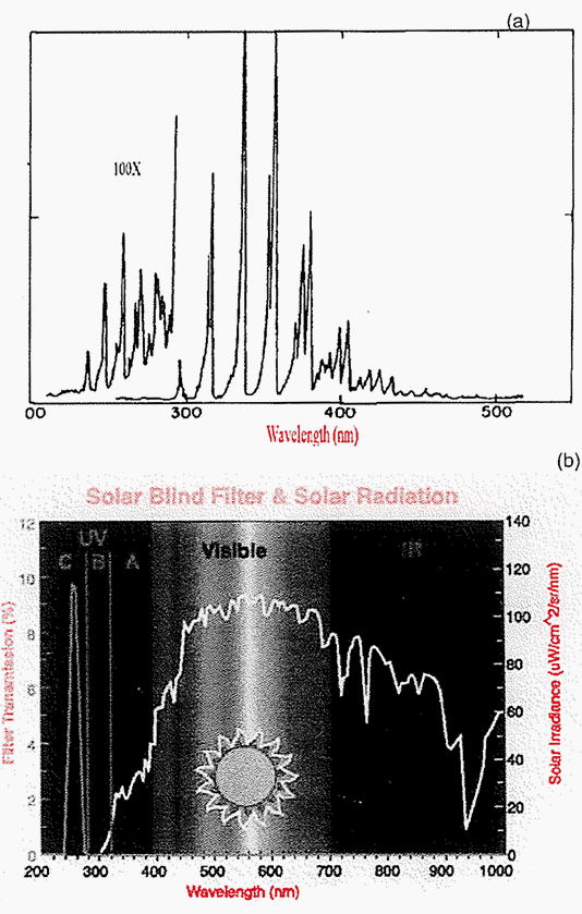

5. Light Emission
The processes leading to corona discharges in air give rise to excitation as well as ionization of molecules. The excited molecules, in which the outermost orbital electrons are bumped to a higher energy state, emit photons when they revert to their original energy state.
Other molecules in air absorb some of the photons, but some of them manage to escape and contribute to the visual manifestation of corona discharges.
Visual observations show that the light is of pale bluish color. Studies of the emission spectra of corona discharges indicate that most of the light is emitted from excited nitrogen molecules.
(a) Corona light spectrum; (b) Visible solar light spectrum
Figure 4 – (a) Corona light spectrum; (b) Visible solar light spectrum
Figure 4 shows the typical spectrum of light emitted by corona discharges in air. The spectrum of visible solar radiation is also shown in the figure.
It is seen that corona produces mainly low-intensity ultraviolet radiation at the edge of the solar light spectrum.
