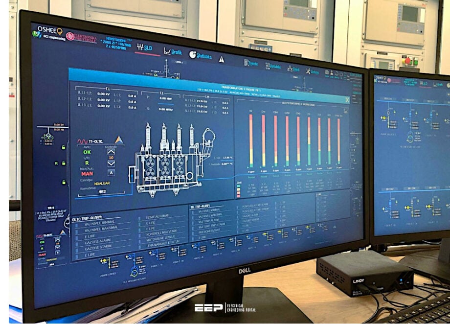

Alarms Coming From the Shunt Reactor You Must Never Ignore (and What To Do)
Alarms Coming From the Shunt Reactor You Must Never Ignore (and What To Do) - photo credit: Elektronika Industriale sh.p.k
Monitoring vital parameters provides condition-based shunt reactor maintenance which increases reliability by detecting a problem before the shunt reactor fails. Finally, monitoring decreases repair costs.

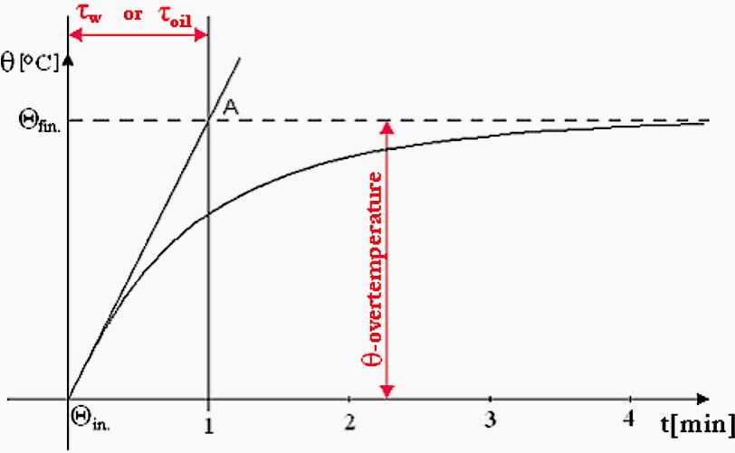

Figure 2 illustrates an exponential curve depicting the heating process occurring within the transformer/reactor. The temperature reaches 63% of the final value after a duration equal to the time constant, τ.
The temperature increase is proportional to the square of the current; so, a current of 1.26 times the rating value would increase the temperature to a final value in time T (1.2622 × 0.63 = 1), resulting in a final temperature of 1.6 times the rated value.
Figure 2 – Temperature rise as a function of time
When the heat generated in the winding/core equals the heat transmitted through the oil to the tank’s surface, the over-temperature is represented by the following exponential.
θt = Θin × (1 − et/τ)
Where:
  • θt = the over-temperature at time t
  • Θin = the initial temperature that is stabilized by the initial load of the reactor
  • τ = the time constant
The heating process of reactor components follows the same variation rule, although differs at different moments due to their different thermal time constants. The time constant of oil is comparable to that of the core, however the time constant of the winding is significantly lower.
Consequently, the winding temperature is the less robust component when compared to the oil and core.

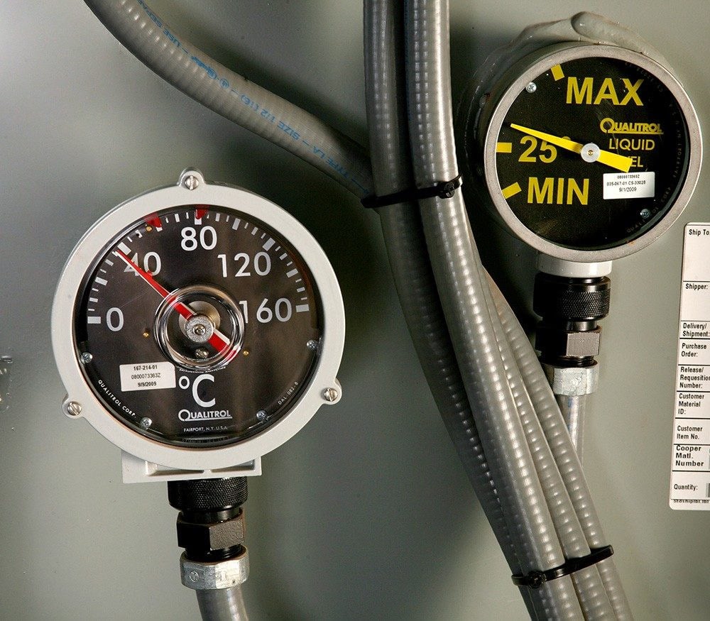

Figure 3 – Oil temperature monitoring
2. Oil Temperature Protection
In order to protect the reactor throughout its entire operating range, specialized temperature protection is necessary due to the heating and cooling requirements of an oil-immersed transmission reactor. The reactors are temperature-limited by the excitation voltage, the cooling system condition, and the ambient temperature.
The oil temperature protection is designed to prevent the insulation oil from reaching a point where the liquid properties would deteriorate or a fire would occur if its flash point was reached.
The top oil temperature is typically measured by one or two temperature sensors that are placed at the reactor cover in order to provide oil temperature protection. When a redundant temperature measurement is required, it is common to employ two sensors to ensure that the temperature protection system remains operational in the event of a sensor failure.
This is a significant advantage, as it is typically only feasible to replace a sensor after the reactor has been de-energized.
The sensors, which are typically of the Pt100Ω type, are connected to an electronic device that provides temperature information both locally and remotely. This information is communicated through analogue outputs (e.g., 4-20mA) or a communication protocol (e.g., DNP3.0 or IEC61850). The electronic unit is equipped with programmable parameters for a high temperature alarm in the initial stage, followed by a very high temperature alarm and reactor trip in the subsequent stage.
Some utilities intentionally delay the trip signal for several minutes to allow operators to take remedial actions, as oil temperature is a variable that changes slowly. These oil temperature devices do not satisfy any of the other criteria; however, they are the sole devices that satisfy the temperature limit requirements.

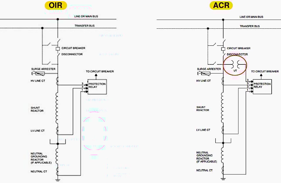

Figure 4 – Left: Typical Single Line Diagram (SLD) for line/bus OIR shunt reactors with associated Instrument Transformers; Right: for line/bus ACR shunt reactors
Where:
  • OIR – Oil-immersed Reactors
  • ACR – Air-core Reactors

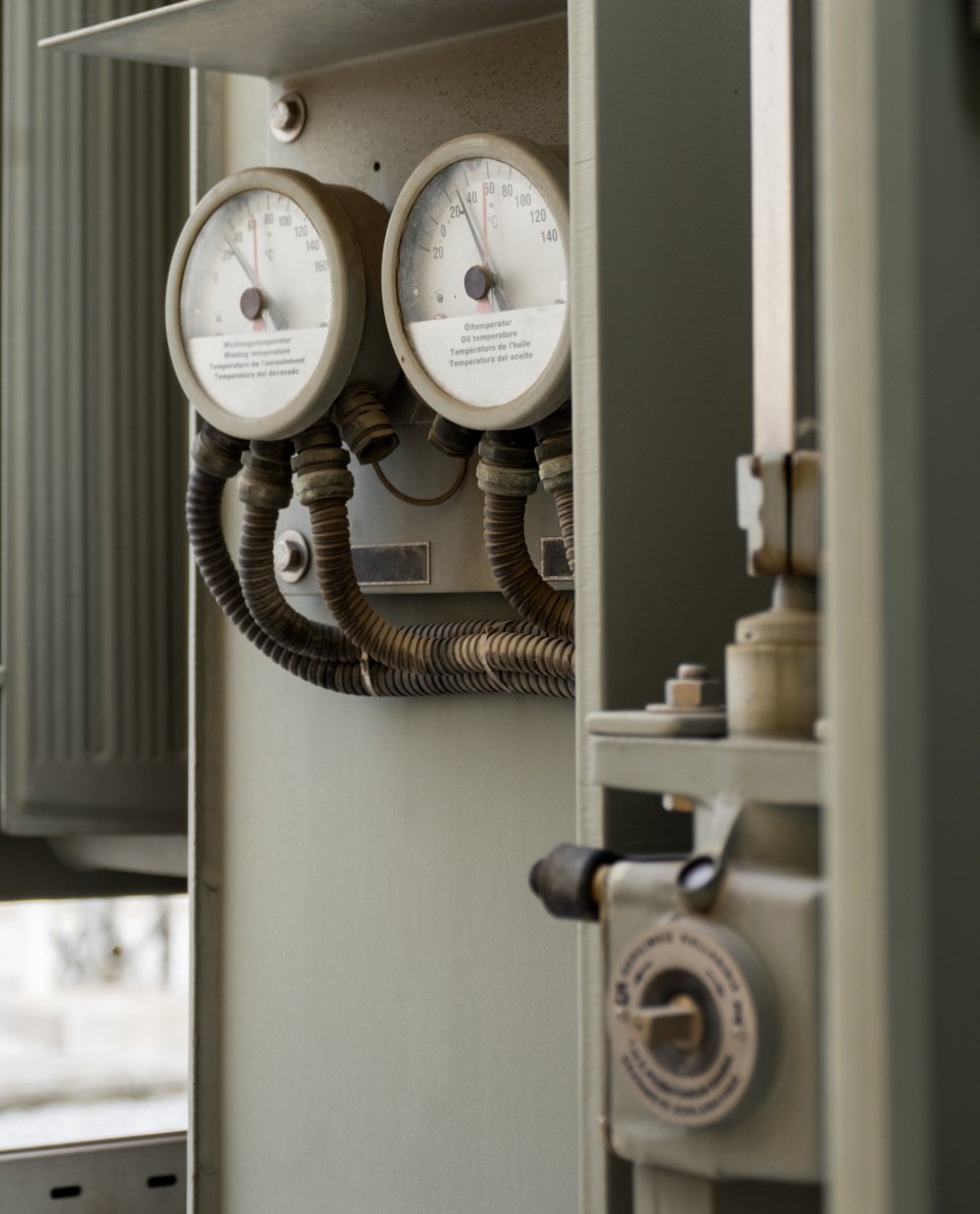

Figure 5 – Shunt reactor winding temperature and oil temperature gauges
