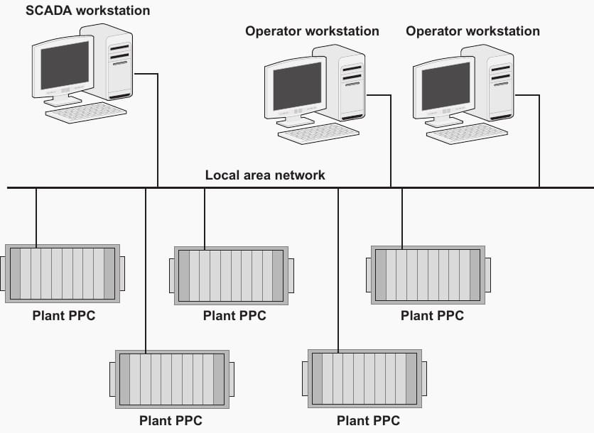

The Bus Topology depicted in Figure 3 comprises a hardware/software link among all nodes inside the system. This building mimics a principal thoroughfare to which all other roads converge. Traveling from one point to another necessitates accessing the primary roadway network and proceeding until an exit to the intended route is located.
Figure 3 – Bus topology
Bus topology
All traffic or communications inside the system are conducted through this one bus-type network. Increased traffic can lead to network congestion, resulting in a deceleration of data transit between nodes. Although Ethernet over a bus network is typically sufficiently fast, certain applications may encounter obstacles to efficient data transmission due to this bus design.

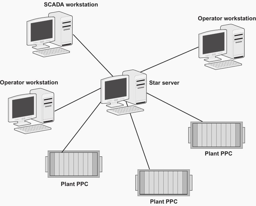

The Star Topology, seen in Figure 4, comprises numerous network paths spreading from a singular master or host node. The master node often comprises one or two master SOWs operating as the system’s supervisors. Data collection from the many PPC nodes is conducted via individual connections in a star configuration.
Update intervals to the host node are very fast; nonetheless, they necessitate numerous egress routes from the host master node.
Data transit between nodes in the Star network necessitates that information is transmitted initially from the source node, subsequently through the host node, and finally to the destination node.
Figure 4 – Star topology
Star topology
