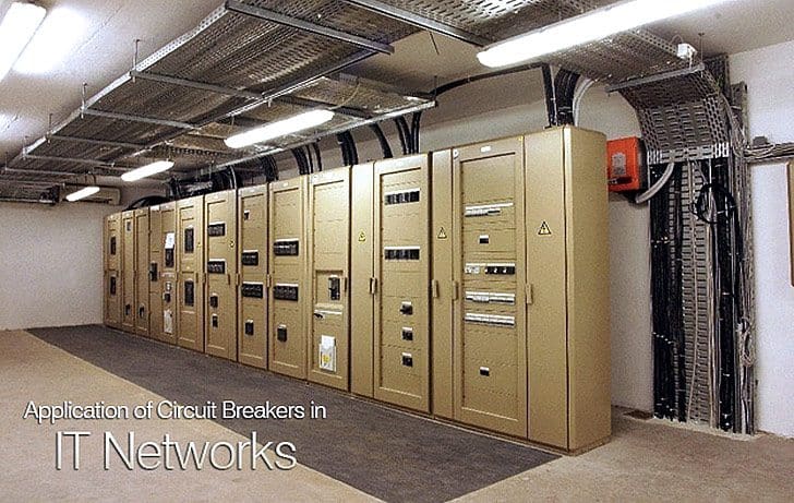

Application of Circuit Breakers in IT Networks (on photo LV switchboard by MaTech Magyar Technologiai Kft.)
