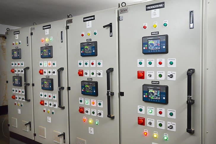

Synchronising panel
Synchronising panel
However, in case of an emergency, when the other modes of bus transfer with voltage interruption are not available, this mode can be adapted with due precautions.
For adopting this mode of transfer, there should be a facility bypassing the normal interlocking against parallel operation. The changeover would involve check synchronising the two sources, whereafter the breaker for new sources of supply would be closed. Closure of the breaker will automatically give tripping command to the breaker for the existing supply automatically.
