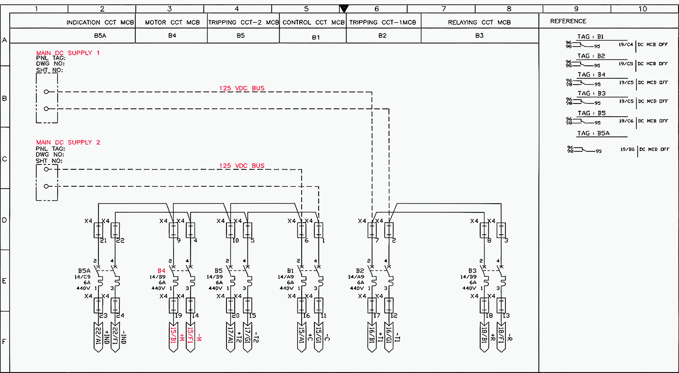

Figure 3 – Redundant DC control circuit with two power supplies
DC Control Circuit
Secondly, the integrity of the Trip Circuit Supervision (TCS) relays must be verified. TCS systems are explicitly designed to continuously monitor the ohmic continuity of the trip coil and its associated external wiring, both in the closed and open positions of the circuit breaker.
However, localized high-resistance faults, such as galvanic oxidation on the terminal blocks or compromised insulation within the multi-core control cables, can severely impede adequate current flow required for tripping without necessarily triggering a low-current TCS alarm threshold.
Best practice dictates the periodic offline measurement of the trip coil resistance using a highly precise micro-ohmmeter, comparing the acquired value directly against the manufacturer’s Factory Acceptance Test (FAT) baseline documentation.
Furthermore, the breaker auxiliary contacts (denoted as 52a, which are closed when the breaker is closed, and 52b, which are closed when the breaker is open) frequently present mechanical degradation over high-cycle operations.
These contacts are physically linked to the operating mechanism shaft and are responsible for safely interrupting the highly inductive DC current of the trip coil once the primary high-voltage contacts have parted. If the 52a contact fails to open, or opens with a delayed mechanical action, the trip coil may remain continuously energized.
Because trip coils are typically rated for intermittent duty only, continuous energization rapidly results in the thermal destruction and subsequent open-circuit failure of the coil winding.
