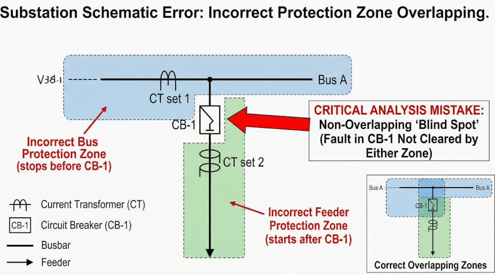

1. Misinterpreting Protection Zones and Overlapping
One of the most foundational errors in schematic analysis is failing to accurately define and overlap protection zones. Protection zones are defined by the location of Current Transformers (CTs).
A common mistake is analyzing the Single-Line Diagram (SLD) without verifying the physical placement of the CTs relative to the circuit breakers.
If the protection zones do not overlap properly, a “blind spot” is created. For instance, if a fault occurs between the circuit breaker and the CT, the primary protection might see the fault as out-of-zone, while the bus protection might also ignore it depending on the CT configuration.
Schematics must be scrutinized to ensure that every piece of primary equipment is covered by at least two independent overlapping zones.
Take an example depicted in Figure 1.
Figure 1 – Substation schematic error: Incorrect protection zone overlapping
This single-line diagram (Figure 1) illustrates the specific error, following the description below:
The Error (Main Diagram): The analysis incorrectly places the boundary of the blue zone before the breaker and the green zone after the breaker, creating a clear white gap (blind spot) directly over the equipment. A red arrow highlights that a fault occurring within that gap would not be cleared by either protection scheme.
The Correct Design (Inset): The small inset diagram in the bottom right shows how the zones must overlap, ensuring the circuit breaker is covered by both schemes and eliminating any blind spot.
Correctly analyzing these boundary conditions is vital for preventing unprotected equipment from causing catastrophic substation failure.

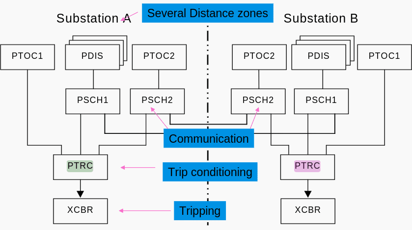

2. Confusing Physical Connections with Logical Nodes in IEC 61850
In digital substations utilizing the IEC 61850 standard, the paradigm shifts entirely. A critical mistake is treating the schematic as a purely physical representation. Engineers accustomed to conventional substations often look for hardwired trip signals. In a digital environment, the physical drawing might only show an Ethernet connection between an IED and a switch.
The actual “wiring” exists in the logical realm via GOOSE (Generic Object Oriented Substation Event) messages.
Failing to cross-reference the physical Ethernet topology with the logical node mapping (e.g., PTRC for protection trip conditioning, XCBR for circuit breaker modeling) leads to a complete misunderstanding of how a trip signal propagates from the protection relay to the breaker.
Figure 2 – Distance protection zones with marked PTRC and XCBR logical nodes
In a conventional substation, a wire is a physical reality—if you see a copper cable running from a protection relay to a breaker’s trip coil, that is the path the signal takes. In a digital substation following IEC 61850, this intuition becomes a liability.
The most common mistake engineers make is attempting to troubleshoot the system by looking solely at the physical Ethernet topology. A physical drawing shows IEDs (Intelligent Electronic Devices) connected to an Ethernet switch via fiber optic cables. However, this “physical wire” carries hundreds of different signals simultaneously.
The actual “connection” is a Logical Node mapping defined in the software (SCL files). A GOOSE (Generic Object Oriented Substation Event) message might be published by a protection IED and subscribed to by five different breaker IEDs. Physically, they all connect to the same switch, but logically, they are separate point-to-point or point-to-multipoint “virtual wires.”
Analyzing the physical layout without the logical mapping is like looking at a highway and trying to guess which specific car is carrying a specific letter; the infrastructure is visible, but the intent is hidden in the data packets.
