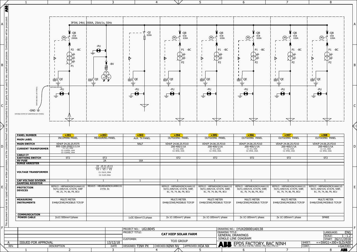

2. Single Line Diagram (SLD) and Substation Topology
The Single Line Diagram (SLD) provides the functional topology of the 8-panel switchgear lineup, designated as SWG1 (Panels J01 through J08).

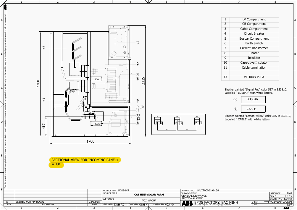

2.1 Incoming Panel =J01
It serves as the primary electrical gateway for the entire 24kV switchgear substation. It is equipped with a heavy-duty 2000A VD4 Vacuum Circuit Breaker (VCB). It handles the maximum continuous current (up to 2000A) entering the substation and transfers it safely to the main horizontal busbars, which then distribute the power to the rest of the panels (like the VT and Outgoing panels).
It houses high-capacity Current Transformers (up to 2000/1A) and a dedicated REF615 protection relay.
Figure 2 – Sectional view of Incoming Panel =J01 (click to zoom)

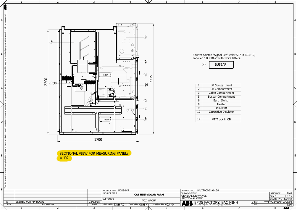

2.2 Metering (Measuring) Panel =J02
Its primary role is to serve as the substation’s “eyes” for voltage. It houses the primary Voltage Transformers (VTs). These VTs step the dangerous 22kV busbar voltage down to a safe, low voltage (110V) that instruments can read. The panel utilizes an ABB REU615 relay dedicated to voltage-based protection.
It monitors for overvoltage, undervoltage, and frequency anomalies.
If the grid frequency drops dangerously low, the REU615 relay in this panel acts as the master controller. It generates the “Load Shedding” commands (Stages 1 through 4) and broadcasts them to all the outgoing panels (J04-J08) to automatically drop non-critical loads and protect the wider grid.
It provides the critical busbar voltage reference signal to the Incoming Panel (J01) so the main breaker can verify it is perfectly synchronized with the utility grid before closing.
Figure 3 – Sectional view of Metering Panel =J02 (click to zoom)

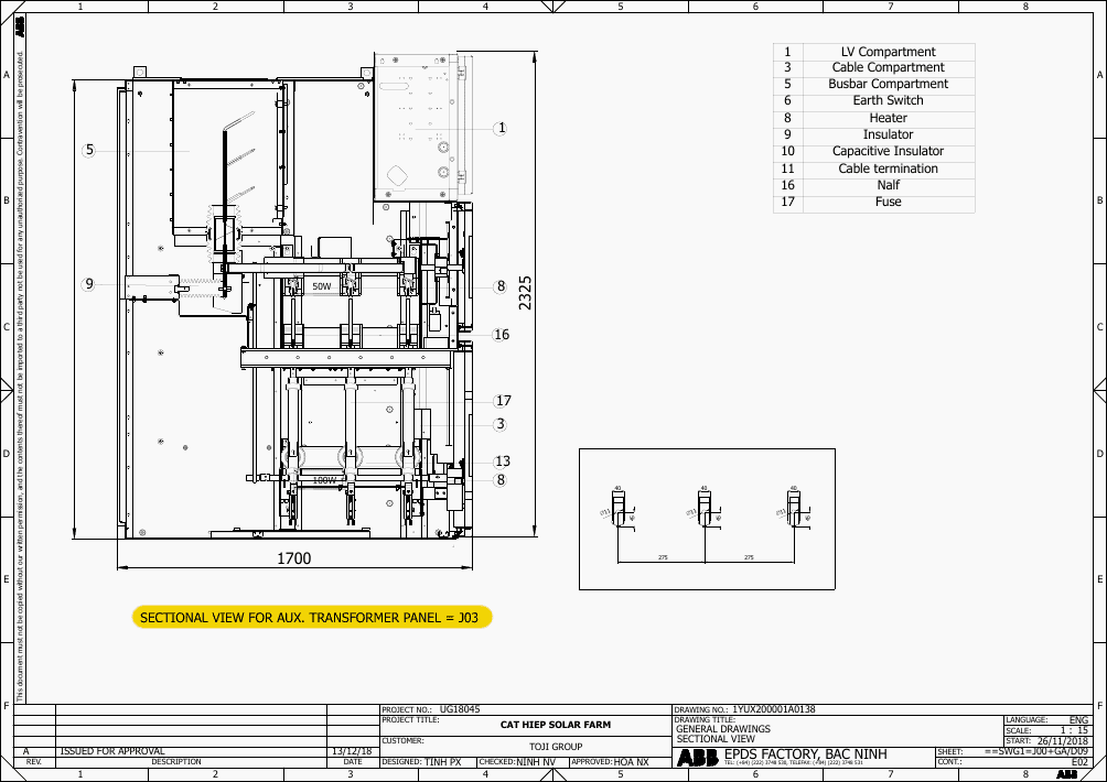

2.3 Auxiliary Transformer Panel (=J03)
Instead of a VCB, this panel utilizes a NALF 630A Load Break Switch (LBS) combined with 16A high-voltage fuses. This is a highly effective, economical design for feeding the station’s internal auxiliary power transformer.
The fuses provide rapid clearing of internal transformer faults, while the LBS allows for safe, off-load or light-load isolation.

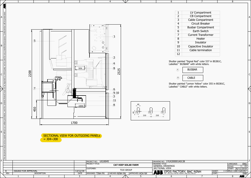

2.4 Outgoing Panels (=J04 to =J08)
These five panels distribute power to the various circuits of the power system. Each is equipped with a 630A-rated VD4/P Vacuum Circuit Breaker and is configured to accept 2x 1C-185mm2 per phase power cables via bottom entry.
Figure 5 – Sectional view of Outgoing Panels =J04 to =J08 (click to zoom)

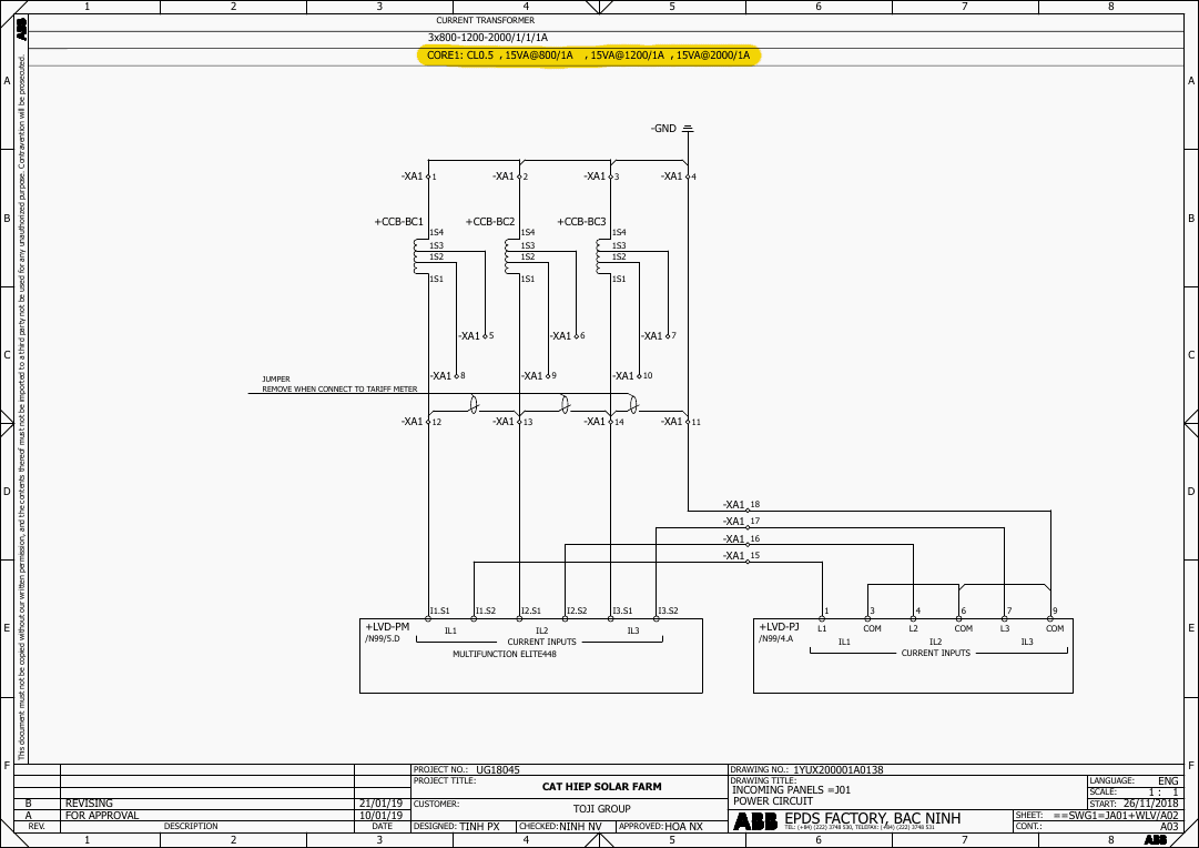

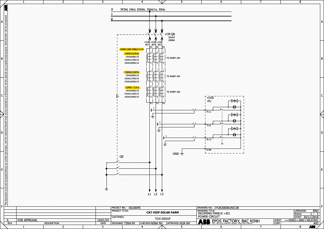

3. Instrument Transformers (CTs and VTs)
Accurate power measurement and reliable fault detection depend entirely on the performance of the instrument transformers. The schematics specify wound-type Current Transformers (LZZBJ9-24/178h/4) and removable Voltage Transformers (JDZXR26-20).
The CTs in the incoming and outgoing panels feature a multi-ratio primary winding (800-1200-2000/1/1/1A for the incoming, and 200-400/1/1A for the outgoing). This allows the power system operators to adjust the CT ratio as the facility’s generation capacity scales.
Figure 6 – CTs 3×800-1200-2000/1/1/1A (click to zoom)
Incoming panel =J01 power circuit
Figure 6 – Incoming panel =J01 power circuit

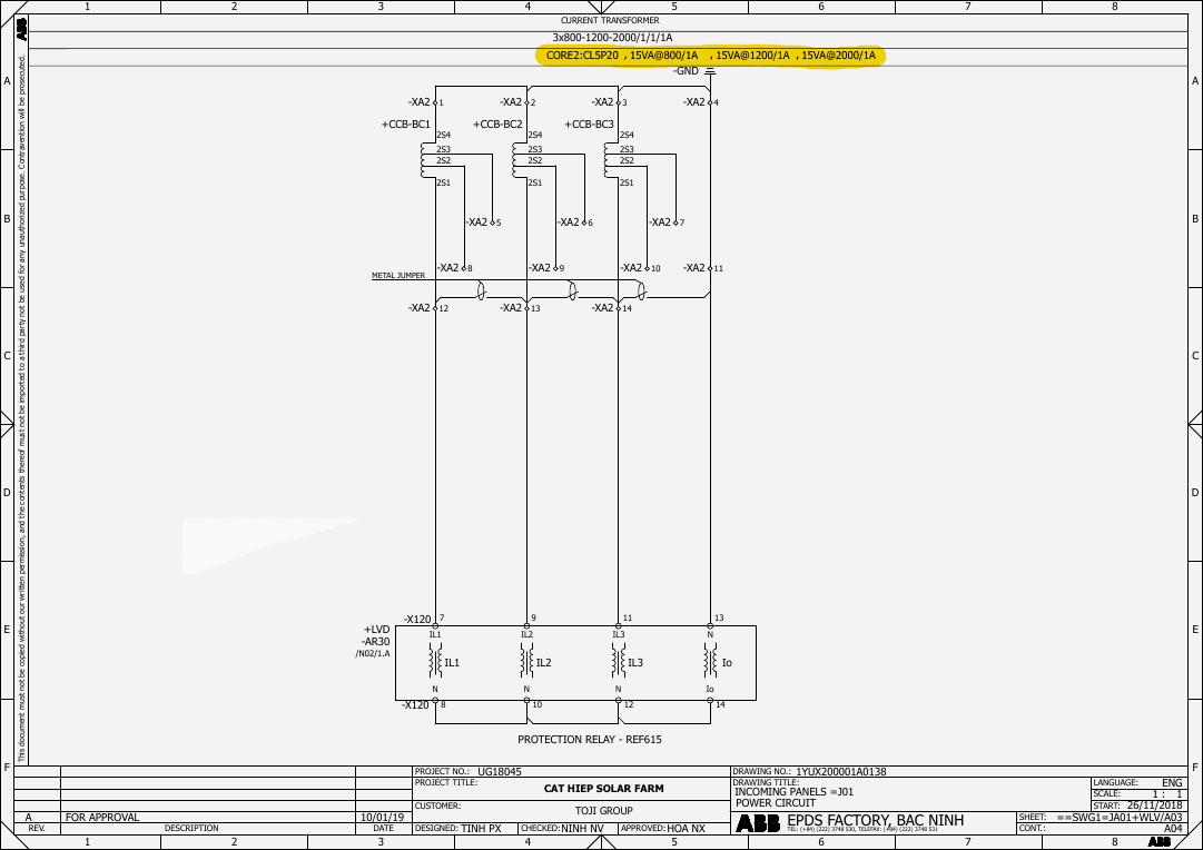

The CTs possess three distinct secondary cores:
Core 1 (Metering): Rated at Class 0.5 with a 15VA burden. This high accuracy ensures that the revenue and operational metering data is precise under normal load conditions.
Figure 7 – CTs CORE1: CL0.5, 15VA@800/1A, 15VA@1200/1A, 15VA@2000/1A (click to zoom)
CTs CORE1: CL0.5 , 15VA@800/1A, 15VA@1200/1A , 15VA@2000/1A
Cores 2 & 3 (Protection): Rated at Class 5P20 with a 15VA burden. The 5P20 designation guarantees that the composite error will not exceed 5% even when the primary current reaches 20 times the nominal rating.
This prevents CT core saturation during severe overcurrent events, allowing the protection relays to accurately read the fault magnitude and execute the correct trip logic.

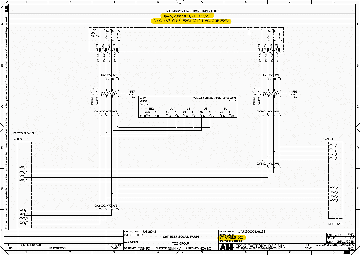

The VTs in the measuring panel provide a ratio of 22/√3 kV to 0.11/√3 kV. They feature a Class 0.5 core (25VA) for high-accuracy voltage measurement and a Class 3P core (25VA) for voltage-based protection elements (such as undervoltage, overvoltage, and residual overvoltage).
Furthermore, capacitive voltage dividers (CGR 24kV) are installed across the panels to interface with DXN-Q-1 LED voltage indicators, providing operators with immediate visual confirmation of line voltage presence.
Figure 9 – Secondary voltage transformer circuit (click to zoom)

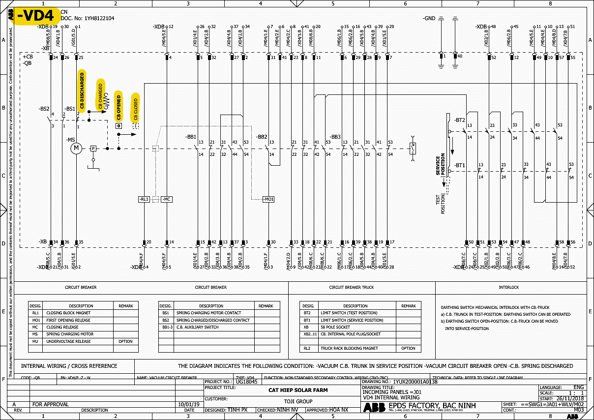

4. Vacuum Circuit Breakers (VD4) and Interruption Technology
The primary switching devices specified in this ABB switchgear are the VD4/P series Vacuum Circuit Breakers. The incoming panel utilizes a 2000A variant, while the outgoing panels use 630A variants.
Vacuum interruption technology is highly favored in power and industrial applications due to its maintenance-free arcing chamber and exceptionally rapid dielectric recovery. When the VD4 contacts separate during a fault, the metallic vapor arc is extinguished at the first current zero-crossing.
The vacuum environment rapidly recovers its dielectric strength, preventing arc restrike even under the high rate-of-rise of recovery voltage (RRRV) typical in highly inductive or capacitive circuits.
The operating mechanism of the VD4 is motor-charged and spring-operated, allowing for rapid O-0.3s-CO-15s-CO auto-reclosing sequences. This means the breaker can open, wait 0.3 seconds, close and open again, wait 15 seconds, and perform a final close/open.
This capability is crucial for clearing transient faults (like lightning flashovers) without causing sustained outages to the power system generation export.
Figure 9 -Schematic of a Vacuum Circuit Breaker (VD4) (click to zoom)
Figure 9 – Schematic of a Vacuum Circuit Breaker (VD4)
