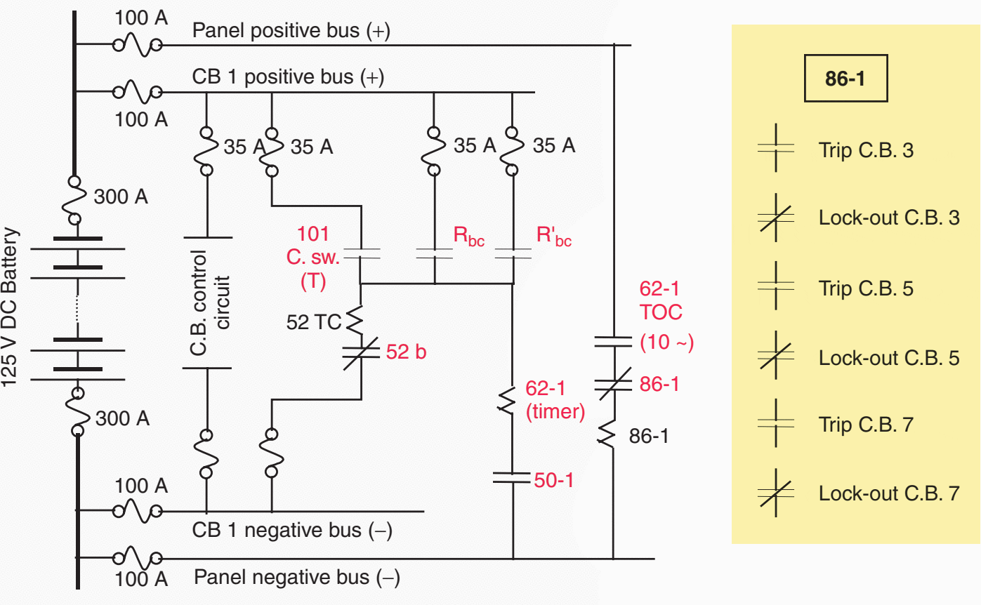

To guard against this contingency, breaker failure relays are provided. When this scheme was first introduced, a separate protective relay was provided, using an independent set of CTs, PT secondary windings and DC circuit to trip the appropriate circuit breakers.
In the above Figure 1, for example, breakers 3, 5 and 7 would be tripped by the breaker failure relays. Subsequent developments6 replaced the independent relay with the control circuitry shown in Figure 3.
In this scheme, any relay or switch which initiates a trip starts a timer known as the breaker failure timer. The timer is supervised (i.e. controlled) by an overcurrent relay (50-1), which drops out when the current through the breaker goes to zero. If this does not happen for any reason, the timer times out and energizes the lockout relay 86-1, which trips and locks out the circuit breakers 3, 5 and 7.
Figure 3 – DC distribution for primary, backup and breaker failure relays

The setting of the breaker failure timer
The setting of the breaker failure timer is determined by two constraints. The minimum time must be longer than the breaker clearing time, plus a margin of safety. Since the breaker failure timer does not start until a tripping relay (or switch) has initiated the trip, the operating time of the tripping relay is not a factor in determining the timer setting.
This is a decided advantage of the present scheme. The maximum setting for the timer must be less than the critical clearing time for faults at that substation, as determined by transient stability studies. Breaker failure timer settings are generally between 7 and 10 cycles for a 60 Hz power system.
