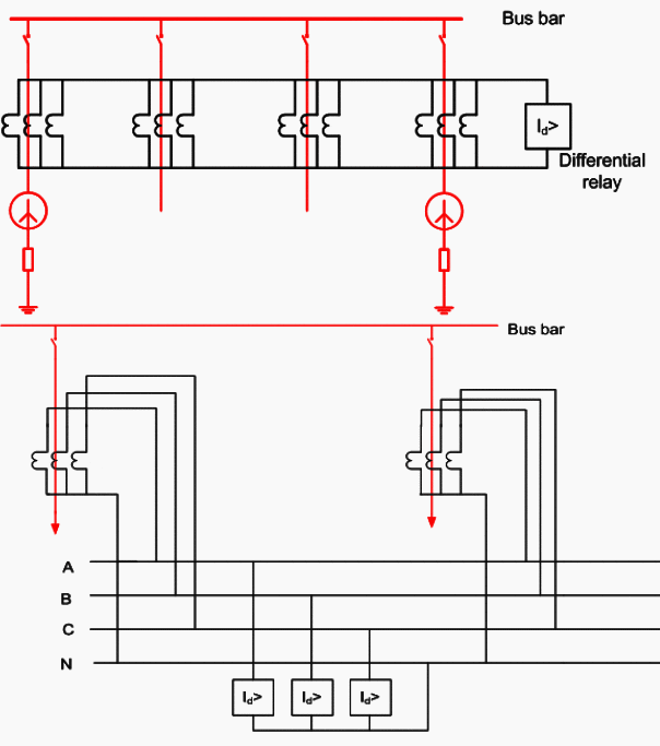

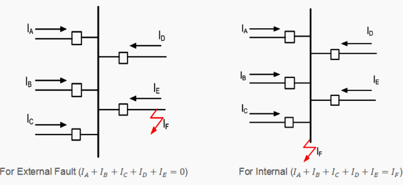

3. Differential protection for busbars
Differential protection operation directly uses the Kirchhoff’s Current Law where it is required that the currents going into a node are equal to current leaving the node.
When the sum of the currents is not equal to zero by comparing their magnitude or phase the difference is referred as a fault current as shown in Figure 4.
When the busbar has a fault also known as internal fault, the total currents entering it is not equal to zero. Fault current If is the sum of the all currents.
The Differential protection for a busbar
Figure 4 – The Differential protection for a busbar
There are numerous methods can be used to apply the scheme.
Figure 5 shows an arrangement where one relay is employed with several CTs connected in parallel. This method is also useful for earth fault protection system for a busbar. An additional protection for phase faults can be achieved by connecting balanced group CTs in each phase in conjunction with three phase element relay as shown in Figure 5 below.
In order to have a good performance for the scheme it is recommended to configure the phase and earth fault settings to be identical.
Basic Circulating Current Schemes
Figure 5 – Basic Circulating Current Schemes
