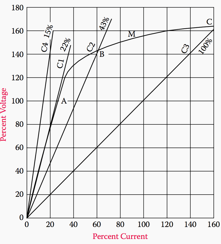

Capacitors for individual motor application are available for standard voltages and in the range of 2.5–600 kVAR, three phase. These are used to correct the motor power factor individually, but when such capacitors are coupled with induction motors, there can be overvoltages due to self-excitation, as shown in Figure 1.
In this figure, the straight lines show the capacitor rating in percentage of the motor rating, and the intercept points A, B, or C on the M curve show the percentage overvoltages expected with that particular capacitor rating.

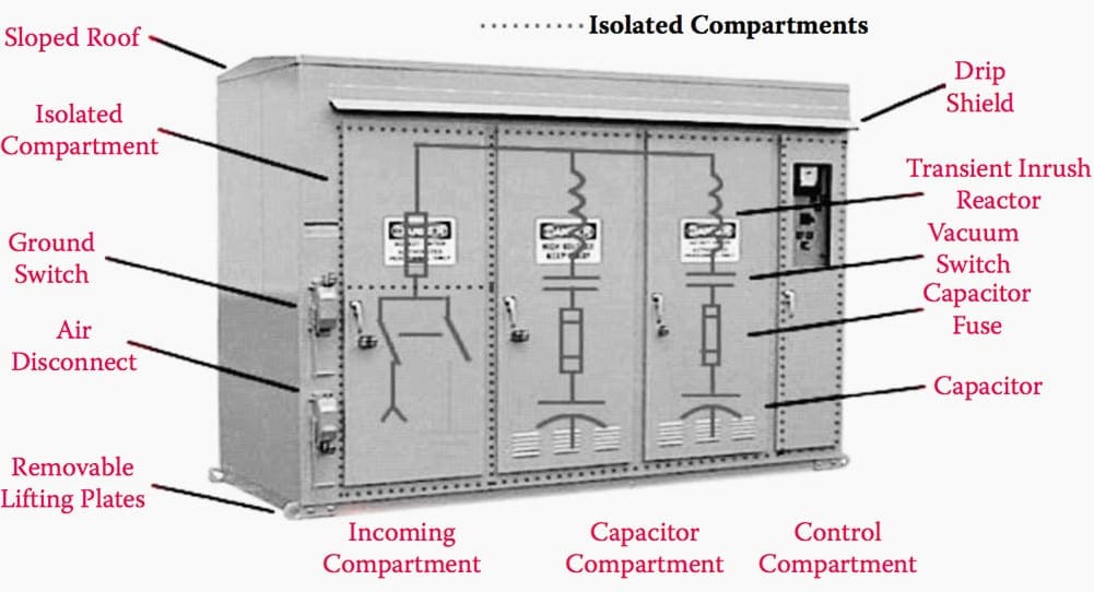

A typical medium-voltage industrial installation is shown in Figure 2 below.
In this installation, the incoming cell has an externally operated air-disconnect switch that provides a visible break for maintenance, together with an integral, interlocked ground switch. The switch is located in a separate compartment that allows the main fuses and other components located within the capacitor compartment to be maintained without having to disconnect power to the circuit feeding the bank.
This type of capacitor bank design completely encloses the bank’s components within a grounded structure, which eliminates the need for a fenced enclosure and mitigates rodent and pollution problems.
Enclosed capacitor banks are more aesthetically pleasing compared with air-insulated open-rack capacitor banks. The capacitor bank assembly is furnished with fused capacitor units, insulators, current-limiting reactors, vacuum switches, main-line fusing, line disconnect switch and grounding switch, surge arrestors, and instrument transformers.
Two-stage medium-voltage automatic capacitor bank showing location of isolated compartments and bank features
Figure 2 – Two-stage medium-voltage automatic capacitor bank showing location of isolated compartments and bank features
A separate section is provided for the protection, monitoring, and control devices together with a separate cable- entrance section.
The doors of the enclosure are key interlocked to prevent entry into a live compartment. Enclosed capacitor banks often use internally fused capacitor units, as these are compact in design and more reliable compared with externally fused capacitor units.

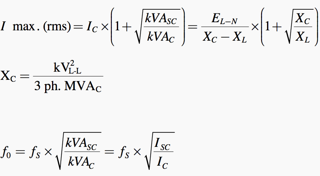

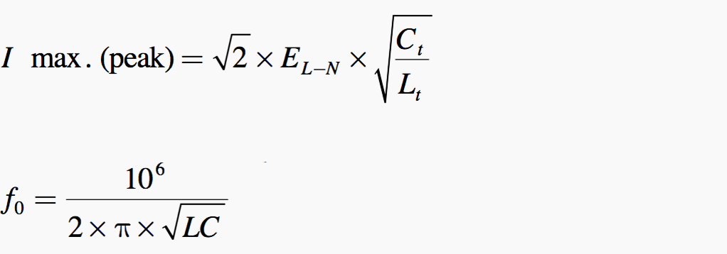

The momentary rating of the switching devices should withstand short-circuit currents for faults and the high-frequency inrush currents associated with switching capacitors. The maximum transient current and net inrush frequency have to be calculated for the more severe of the following two conditions:
Isolated bank switching
Back-to-back switching
Back-to-back switching formulae
where the subscripts “sc” and “c” refer to the short-circuit infeed and capacitor values, respectively, while f0 is the inrush frequency and fs is the system frequency.
Back-to-back switching refers to switching when other capacitors or a significant level of system capacitance also exists on the bus side of the capacitor bank switch. The formulae for back-to-back switching given above are simplified versions that apply if the capacitances on both sides of the switch are the same.

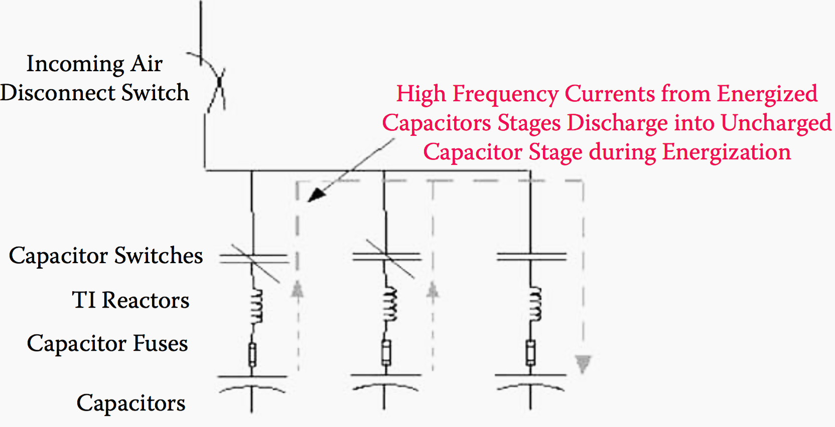

Transient inrush reactors, which are designed to increase the life expectancy of capacitor switches by limiting both the magnitude and frequency of the transient inrush currents associated with back-to-back capacitor bank switching, can be added.
These reactors are most commonly applied in multistage medium-voltage capacitor banks or in fixed medium-voltage capacitor banks that are connected to the same switchgear bus as other fixed capacitor banks, as shown in Figure 3.
In these cases, the switches are usually rated 200–600 A, with a 200 A single-phase group- operated switch being the most common.
