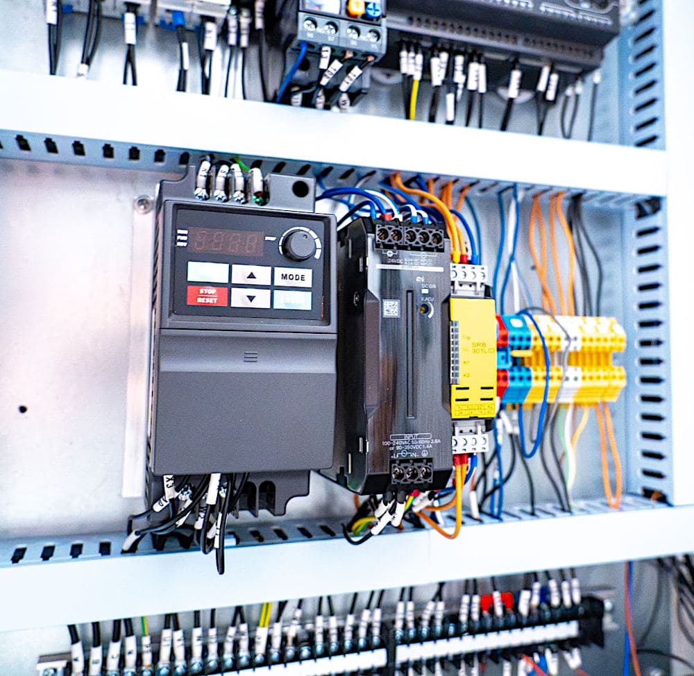

Non-linear loads operate by switching the incoming AC voltage at high speeds to control the power delivered to the end process. The most prevalent non-linear loads in heavy industry are Adjustable Speed Drives (ASDs) or Variable Frequency Drives (VFDs) utilized to control the speed and torque of AC induction motors.
A standard six-pulse VFD utilizes a full-wave diode bridge rectifier to convert incoming AC power to a DC bus voltage, which is then inverted back to a synthesized, variable-frequency AC voltage using Insulated-Gate Bipolar Transistors (IGBTs). The rectifier section draws current from the AC line only when the instantaneous line voltage exceeds the DC bus voltage. This results in current being drawn in abrupt, non-continuous pulses rather than a smooth sinusoid.
According to Fourier analysis, any periodic, non-sinusoidal waveform can be mathematically decomposed into a fundamental frequency component and a series of harmonic components whose frequencies are integer multiples of the fundamental frequency.
For a balanced, six-pulse rectifier configuration, the characteristic harmonic orders (h) injected back into the power system are defined by the equation:
h = (n × p) ± 1
Where:
  • n is any integer (1, 2, 3, …)
  • p is the pulse number of the rectifier (typically 6)
Therefore, a standard six-pulse drive fundamentally generates 5th, 7th, 11th, and 13th harmonic currents. These harmonic currents flow from the non-linear load back toward the lowest impedance point in the system, which is typically the utility source transformer.
As these currents flow through the inherent inductive impedance of the facility’s distribution cables and transformers, they induce harmonic voltage drops, distorting the voltage waveform for all other equipment connected to the common bus.
Figure 2 – Six-pulse Variable Frequency Drive

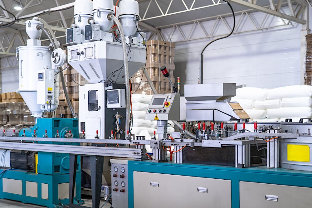

3. Case Study Overview: The Plastic Extrusion Facility
This case study analyzes a comprehensive power quality incident at an industrial plastic extrusion plant. Plastic extrusion processes are characterized by high mechanical torque requirements, sustained heavy loading, and precise speed regulation to ensure product uniformity.
Figure 3 – Typical plastic extrusion production line

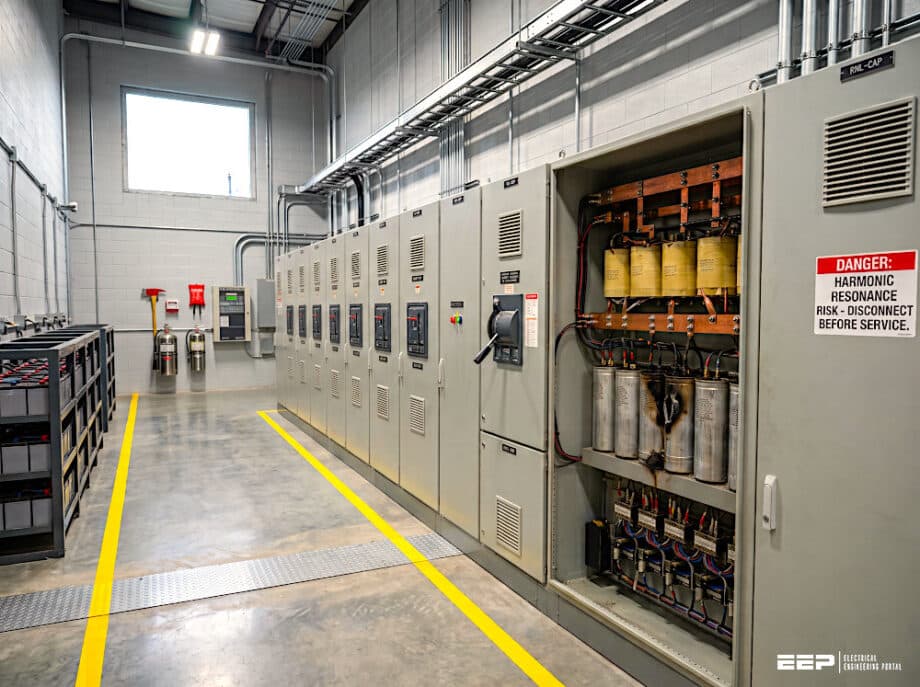

4. The Initial Corrective Action and Subsequent Equipment Failure
To mitigate the financial penalties, plant management authorized the installation of localized power factor correction equipment on the secondary side of the distribution network.
4.1. Application of Standard Shunt Capacitors
The initial design approach was strictly conventional. Electrical contractors calculated the deficit in reactive power and installed standard, un-detuned shunt capacitor banks across the lower voltage buses. The primary objective was to inject leading kVAR to offset the lagging kVAR of the induction motors and transformers, thereby shifting the phase angle θ closer to zero and restoring the DPF to unity.
Upon energization of the capacitor banks, the facility’s power factor meters immediately reflected an improvement, exceeding the 0.95 requirement.
However, this apparent success was abruptly overshadowed by severe operational anomalies that manifested within days of commissioning.

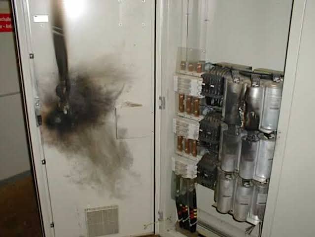

4.2. Catastrophic Failure Mechanisms
The facility began experiencing a cascade of electrical failures directly correlated to the activation of the new capacitor banks. The symptoms included:
1. Transformer Overheating: The primary step-down transformers began operating at temperatures vastly exceeding their thermal ratings, triggering temperature alarms. Transformer core losses (comprising hysteresis and eddy current losses) are highly frequency-dependent. Eddy current losses, in particular, scale with the square of the frequency.
The presence of high-frequency harmonic currents dramatically increased the I2R heating within the transformer windings, accelerating insulation degradation.
2. Capacitor Fuse Ruptures: The protective HRC (High Rupturing Capacity) fuses dedicated to individual capacitor steps began blowing indiscriminately.
3. Dielectric Breakdown and Rupture: Several cylindrical capacitor canisters physically bulged, leaked dielectric fluid, and ultimately suffered explosive failure.
The capacitor failures were driven by fundamental electrical physics. The reactance of a capacitor (Xc) is inversely proportional to frequency (f):
Xc = 1 / 2πfC
Therefore, capacitors present a low-impedance path to high-frequency harmonic currents. The standard capacitor banks were unintentionally absorbing the large 5th and 7th harmonic currents generated by the 2.5 MVA six-pulse drives. The excessive RMS current overheated the internal metallic film. Furthermore, the combination of high harmonic currents and fundamental voltage resulted in peak overvoltages that exceeded the dielectric withstand capability of the polypropylene film inside the capacitors, leading to localized arcing, gas generation, mechanical expansion, and eventual rupture.
Here is a realistic photo showing what happens when a power factor correction capacitor bank catastrophically fails and explodes due to severe harmonic resonance and overvoltage:
Figure 4 – PFC capacitor bank catastrophically failed and exploded

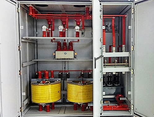

6. Engineered Mitigation Strategy: Passive Harmonic Filtration
Removing the capacitor banks would stop the catastrophic failures but would immediately reinstate the severe utility power factor penalties. That sounds bad. The engineering mandate was to provide the required reactive power compensation without triggering parallel harmonic resonance.
The solution necessitated the removal of the standard, un-detuned capacitors and the design and installation of custom-engineered passive harmonic filters at the 4.16 kV bus feeding the non-linear loads.
6.1. Designing the Detuned Filter
A passive harmonic filter consists of a power factor correction capacitor bank connected in series with a specifically sized iron-core inductor, known as a detuned reactor.
The design implemented at the facility involved a new 1,200 kVAr, 4.16 kV harmonic filter. The objective of connecting the reactor in series with the capacitor is to deliberately alter the resonant frequency of the localized LC circuit. The filter is engineered so that its series resonant point, where it presents the lowest possible impedance, is tuned just below the lowest predominant harmonic frequency generated by the load.
Since the six-pulse extrusion drives generated significant 5th (300 Hz) and 7th (420 Hz) harmonics, the filter was mathematically tuned to the 4.7th harmonic (282 Hz). The assumed X/R (reactance-to-resistance) ratio of the reactor was specified as 20 to ensure adequate damping characteristics.
The tuning frequency of the filter (hfilter) is defined by the relationship between the capacitive reactance (Xc) and the filter inductive reactance (XF):
hfilter = √ (Xc / XF)
By sizing the reactor (XF) appropriately, the 1,200 kVAr capacitor was tuned to 4.7. At the fundamental frequency (60 Hz), the capacitive reactance massively outweighs the inductive reactance of the series reactor.
Therefore, at 60 Hz, the filter assembly operates predominantly as a capacitor, injecting the necessary 1,200 kVAr of leading reactive power into the 4.16 kV bus to successfully correct the displacement power factor.
Figure 5 – Detuned harmonic filter panel with large iron-core reactors visible at the bottom
