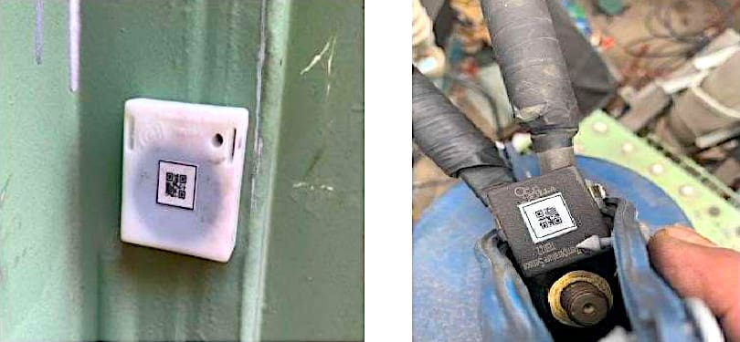

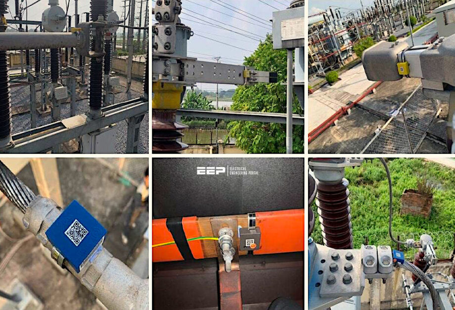

Consisting of wireless temperature sensors and camera

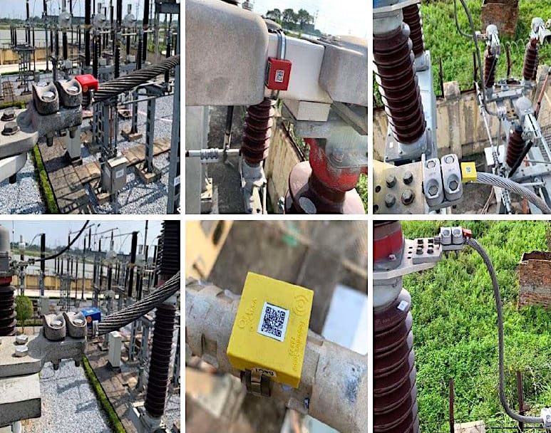

1.1 At 110kV Hoi Hop substation
Installing wireless sensors at locations: CT172, DS172-2, DS112-2, DS132-2, CB132, CT132, DS132-3, cabinet VT C32, DS T302-2, CB T302, CT T302. Installing fixed thermal cameras for comprehensive monitoring of T2 power transformer.
Figure 1 – Installed wireless sensors

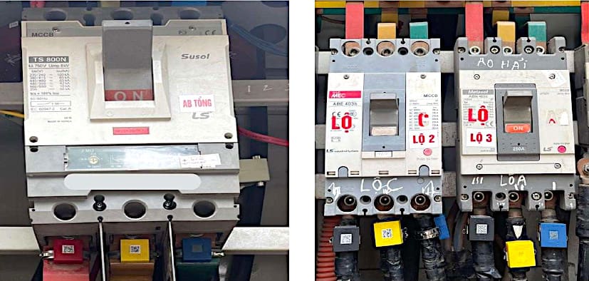

1.2 At 22/0,4kV Ao Hai substation:
Installing wireless sensors at the high and low voltage bushing terminal of the power transformer, power transformer tank, main MCCB and 02 branch MCCBs.
Installing each phase current transformer for the main MCCB and branch MCCB 4 & 5 to measure operating parameters.
Figure 2 – Installed wireless sensors on LV circuit breakers

2.1 Monitoring parameters
2.1.1 110kV Hoi Hop substation:
  • T2 power transformer: HV, MV, LV bushing terminal contact temperatures of the power transformer; Temperature of HV, MV, LV bushing of power transformer; Top oil temperature through the power transformer main tank; Power transformer main tank temperature; Auxiliary oil tank temperature.
  • 110kV DS: Temperature of the contact position; Temperature of the bushing terminals
  • 110kV CB: Temperature of the bushing terminals at both sides of the CB
  • 110kV CT: Temperature of the bushing terminals (03 phases)
  • Surge arrester on MV, LV side of power transformer: Temperature of the bushing terminals; Temperature of the SA.
  • VT panel of C32 busbar: Temperature of 03 phases C32 busbar; Ambient temperature and humidity in the VT panel of C32 busbar.
  • Power cable: Temperature of power cable terminals at MV, LV sides of T2 power transformer.
Figure 3 – Installed wireless sensors in 110kV substation

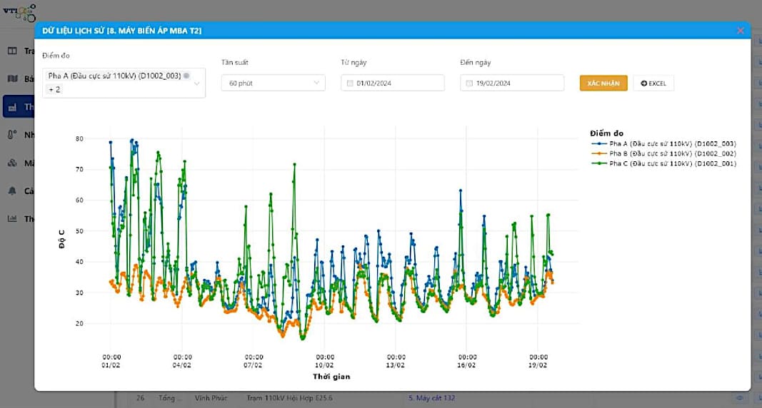

4.1 Overheating detection on 110kV HV bushing terminal of T2 power transformer at 110kV Hoi Hop substation
T2 power transformer 115/38,5/23kV – 63MVA in 110kV Hội Hợp substation was made by Cam Pha Electrical Equipment Joint Stock Company (VEE) in 2016. After installing the thermal monitoring system, during peak hours of the day, the monitored temperature at the bushing terminals of phase A and phase C of T2 power transformer increased, and a deviation warning appeared (delta) temperature of bushing terminals A and C with bushing terminal B on the 110kV side.
Thermal images and temperature data are displayed directly on the monitoring interface.

Figure 6 – Overheating diagram of phase A and phase C bushing terminals of 110kV T2 power transformer

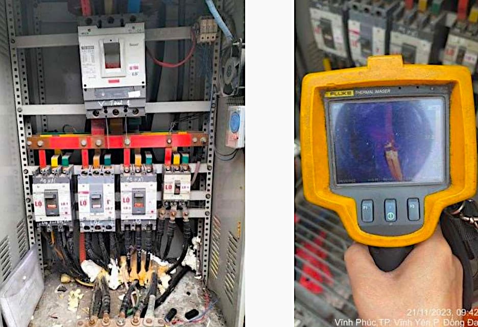

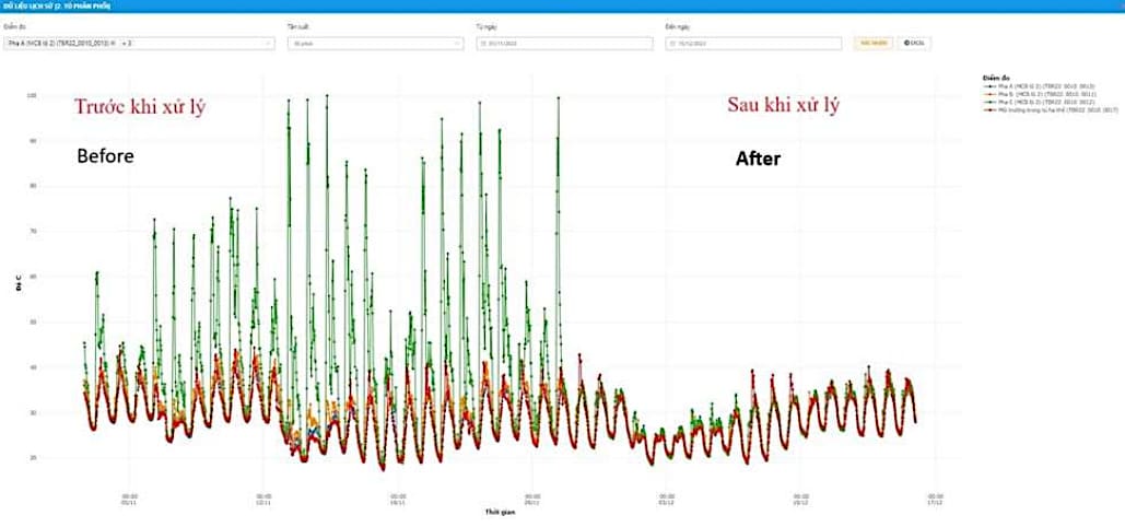

4.2 Overheating detection on terminal of phase C of branch MCCB 2 at 22/0,4kV Ao Hai substation
After installing the thermal monitoring system, the branch MCCB 2 monitoring temperature increased abnormally at phase C, details as following:
21/11/2023: Vinh Phuc Power Company and VTI technical staff came to the substation to check and verify the results. After measuring, confirming that VTI’s temperature monitoring system reports correctly, there is overheating at the location as warned on the software.
Figure 7 – Feeder 2, phase C (The second MCCB from the left is overheated)
On November 27, 2023, Vinh Yen city power branch cut off the power, reprocessed the contact points, and re-pressed the terminals. After treatment, the temperature of phase C of MCCB branch 2 returned to normal.
