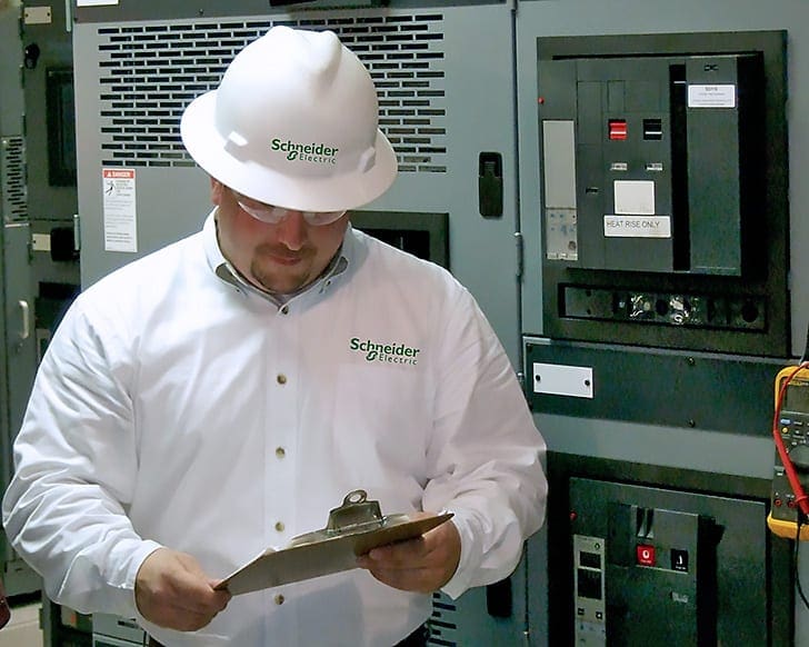

Engineer performing verification of LV switchgear against specifications
Figure 1 – Engineer performing verification of LV switchgear against specifications
1.2 Verification Against Specifications
When a new facility or facility modification is at the equipment installation stage, the design of the installation has already been completed. The type of low voltage switchgear and circuit breakers that are selected for a specific power system should be shown in the drawings, prints, or specifications for the installation.
The purpose of verifying low voltage switchgear and circuit breakers against the specifications is to ensure that the equipment that is is being installed meets industry standards.
Generally, the verification against specifications consists of a determination of whether the type and rating of the equipment that is to be installed match the size and type of the equipment that is required for the installation. Usually, this determination is accomplished by reading an electrical plan that identifies the low voltage switchgear and circuit breaker sizes and types.
The Engineer inspects the manufacturer’s nameplate data on each switchgear compartment and circuit breaker, and he compares them to the requirements on the electrical plan to determine whether the correct equipment is being used.
In some situations, the Electrical Engineer must rely on his knowledge of the correct application of switchgear and circuit breakers sizes and types to determine whether the correct equipment is being used. The data sheets that were used to order the switchgear from the manufacturer should also be consulted.
