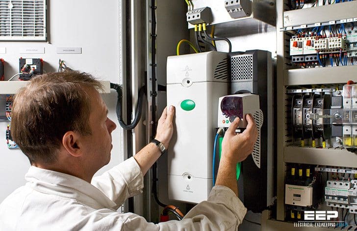

AC Variable Speed Drive and IE2 Motor Kit - 1.5kW (2.0HP) 230V Single Phase
AC Variable Speed Drive and IE2 Motor Kit – 1.5kW (2.0HP) 230V Single Phase (photo credit: inverterdrive.com)
On the incoming line, adjustable speed drives produce harmonics which must be taken into account in the over-all system design. This topic is addressed in a later section of this guide. Adjustable speed drives, like soft-starters, are microprocessor-based devices. Therefore, they can interface with the automation infrastructure of a facility.
