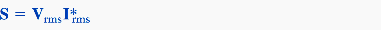

assuming the passive sign convention (see Figure 1). In terms of the rms values:
Complex power formulae(1.11)

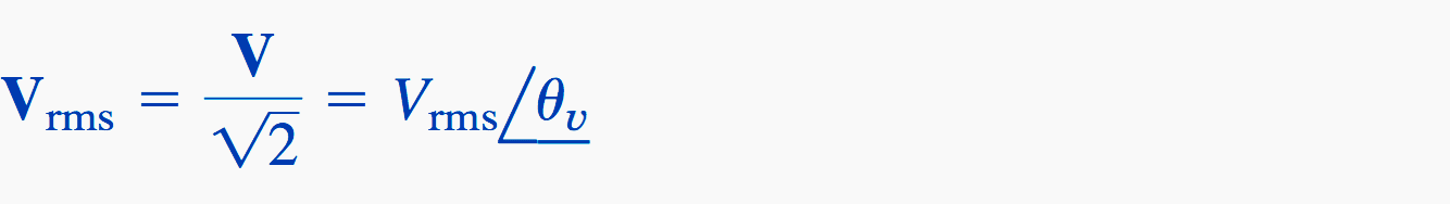

where
Vrms formulae(1.12)

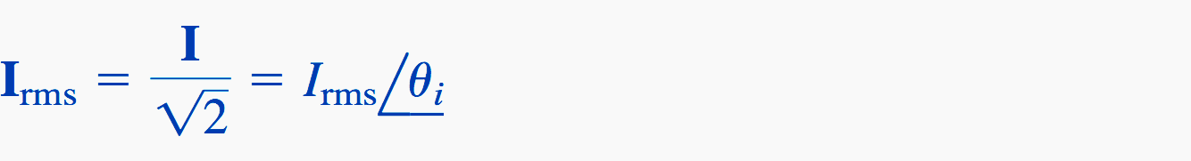

and
Irms formulae(1.13)
Thus we may write Eq. (1.11) as:
Complex power formulae(1.14)
We notice from Eq. (1.14) that the magnitude of the complex power is the apparent power. Hence, the complex power is measured in volt-amperes (VA). Also, we notice that the angle of the complex power is the power factor angle.
