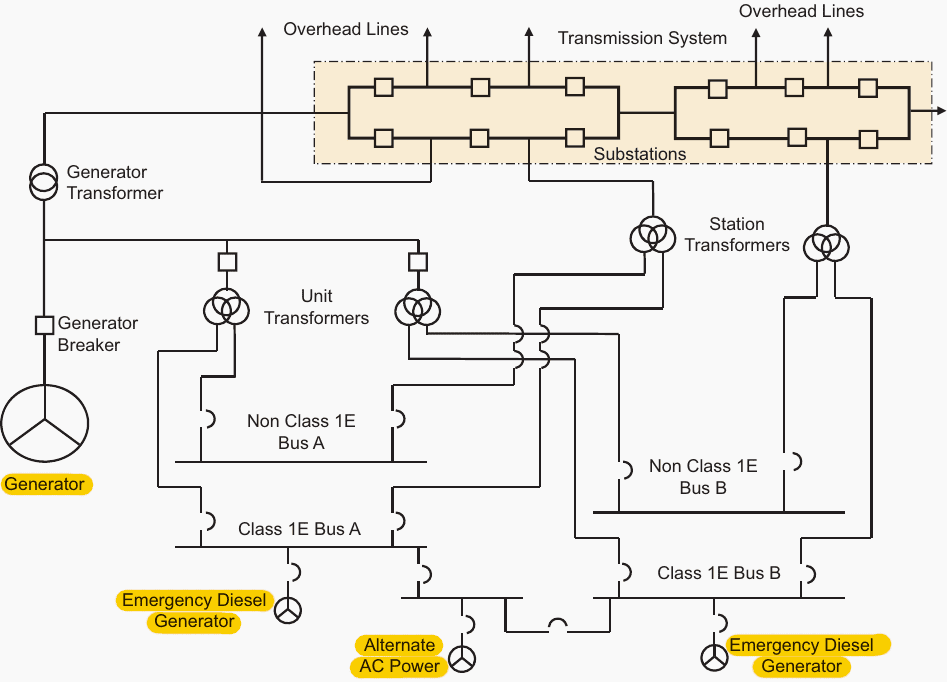

Figure 1 – Schematic representation of the different parts of the electrical power supplies for a nuclear power plant

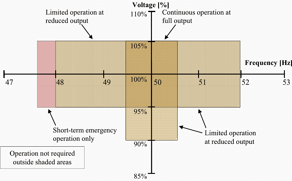

The Transmission System Operator (TSO) will normally require that:
  1. A generating unit is capable of operating continuously at full output within the typical range of variation in grid voltage and frequency (e.g., +/–5% in voltage, +/–1% in frequency) as illustrated in Figure 2.
  2. A generating unit is capable of operating for a limited period, on a few situations per year, at a reduced output, for a voltage and frequency range that is outside the normal range (e.g., –10% in voltage and +4%, –5% in frequency), as illustrated in Figure 2.
  3. A generator has the “fault ride-through” capability, which enables it to continue in operation (i.e., not trip) during specified transient events on the transmission system.
    For example, the transient voltage dip that occurs when a short circuit fault occurs as a result of a lightning strike on the transmission system in close proximity to the power plant.
  4. A generating unit is capable of supplying a specific range of reactive power to assist in the regulation of system voltage.
  5. A generating unit is capable of maintaining operation with a specified level of phase imbalance (negative phase sequence voltage) or harmonic distortion of the voltage waveform.

Figure 2 – Depiction of critical frequency and voltage ranges for functionality

Figure 3 shows a simplified single line diagram of the electrical network of an NPP and its grid connections. The output from the generating unit is fed to the grid via the generator transformer. One or more unit transformers are supplied at generator terminal voltage, and provide the electrical power to the plant auxiliaries for start up and during normal operation.
There is a circuit breaker in the connection to the generator terminals, so that the auxiliaries in the NPP can be supplied from the grid when the generator is shut down, by opening this circuit breaker.
Older NPPs did not generally have a circuit breaker at the generator terminals.
Figure 3 – Electrical connections to two substations
Electrical connections of a nuclear power plant to two substations
Figure 3 – Electrical connections of a nuclear power plant to two substations
One or more station transformers provide the second connection to the grid and provide an independent supply to the electrical auxiliary equipment.
In this arrangement one station transformer is connected to a different substation from the generator transformer. In this figure the station transformers and unit transformers are each shown as three-winding transformers (with two low voltage windings); some NPP designs use two-winding transformers (with only one low voltage winding).
Figure 4 depicts an alternative arrangement of the connections to the transmission system, where the generator transformer and station transformer are connected to the same substation.
Figure 5 shows yet another arrangement that is to be used for some new large nuclear units. In this case, the unit transformers are connected to the grid voltage alongside the connections to the generator transformer.
