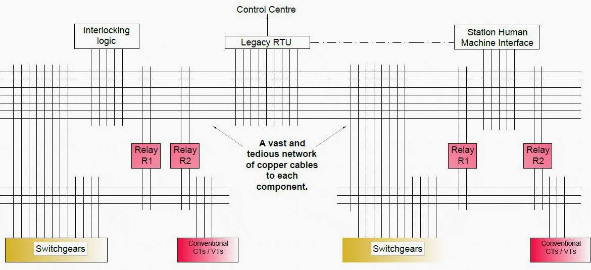

Typical connection principle of the conventional substation control system
Figure 2 – Typical connection principle of the conventional substation control system
As illustrated in Figure 2, conventional substations have a vast network of physical copper wiring, creating a network of all primary sensors like CTs, VTs from the switchyard, or RTU to the control room. Likewise, connections to relays, switchgear, or existing HMIs are hardwired, with individual copper wires too, with a bare minimum possibility of automation and limited data acquisition.
Even today, the number of substations in operation with very little or no automation is very high compared to a modern digital substation. Barring some minor maintenances, once commissioned, power substations last for 30-40 years or even more.
So, most of the old substations we see today are in operation since the time even before or during the advancement in substation communication protocols defined by IEC 61850. Substations developed during this transition phase of communication protocol integrated numerical relays and other few IEDs along with electromechanical technology and open protocols like IEC60870-5-102, 103 for substation operation.
These substations would still be considered old and outdated for their lack of flexibility in connectivity within devices, a vast tiresome network of hardwired copper cabling, lack of extensive data acquisition, and lack of full automation to the potential of installed numeric relay and so on.

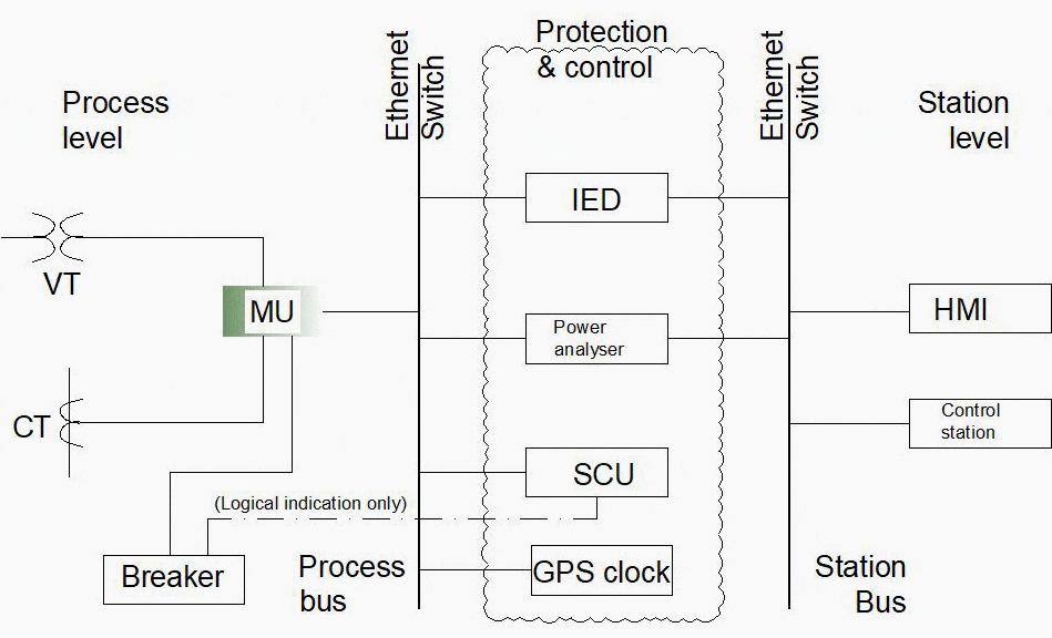

The digital substation comprises three levels in terms of communication:
  1. the station level,
  2. the bay level, and
  3. the process level.
In the process level, primary sensing elements like CTs and VTs transmit signals in digital form to the bay level, consisting of an interconnected network of protection and monitoring units termed as IEDs. The station level is mostly for supervision, data logging, and control overrides whenever required. It comprises HMIs, SCADA, and other operating stations.
In a digital substation, only a few fibers and Ethernet cables connect all these components and levels mentioned above, which makes the physical realization much easier and also much reliable at the same time.
In a conventional substation, a vast network of copper wiring makes the system both unreliable and cumbersome.
Typical bus principle in a digital substation
Figure 3 – Typical bus principle in a digital substation
The digital substation comprises some key elements. IEDs, Generic Object Oriented Substation Event (GOOSE), GPS, station and process bus, merging units, and non-conventional transducers are integral parts of a digital substation.
An IED is any device within a substation that consists of one or more processors and can control data from external sources like sensors and transducers. Digital relays, controllers, power analyzers, etc. used for protection and control fall in this category.
When related to substation architecture, these elements make up the bay level. Similarly, GOOSE is specific formatting of data used as an essential part of the IEC 61850 optical network, ensuring reliable and timely operation of interconnected IEDs enables swift signal transfer. The Station bus works as a communication bridge between IEDs in bay level and station control, while the process bus links IEDs to primary sensing elements. Interconnections exist between IEDs too.
Merging units act as an interface between the conventional transducers and the IED like bay controllers and protection relays. Their primary function is to digitize the analog signals and transmit them to IEDs as per the adopted protocol. Likewise, the trend of using optical current and voltage transducers is evergrowing.
These modern transducers are capable of communication to IED via optical fiber with no intermediate units.
