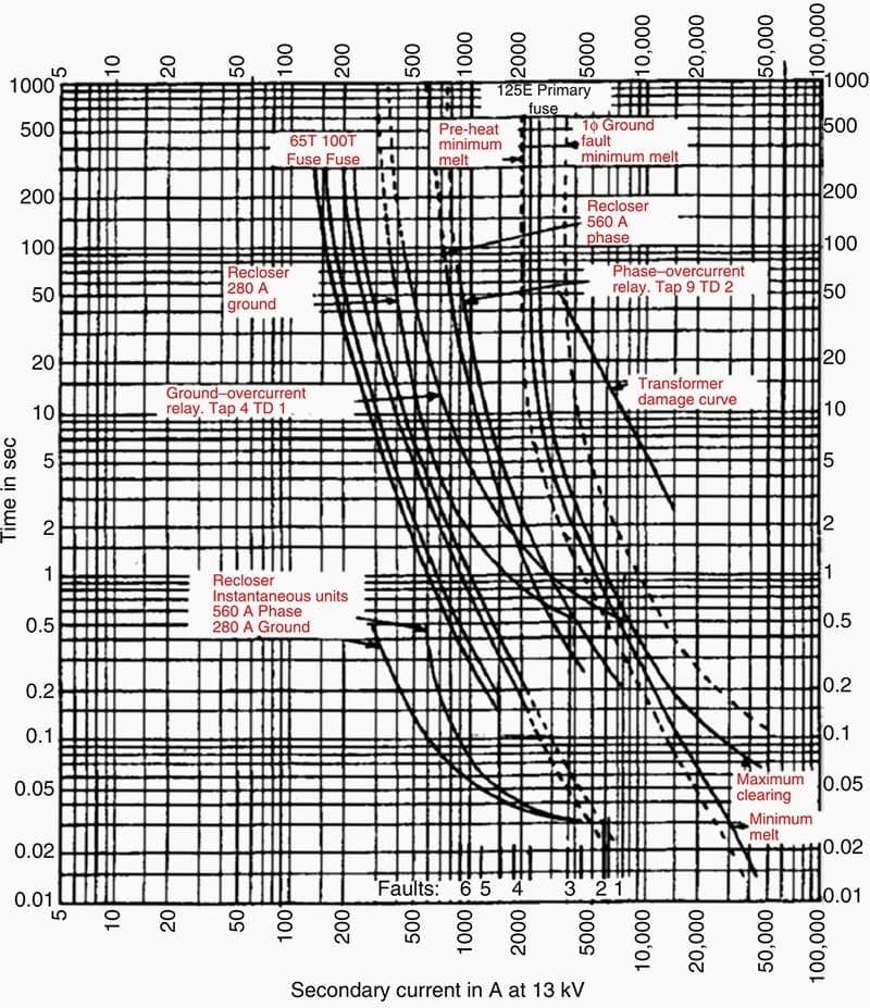

The characteristics are plotted on log–log fuse coordinate paper (Figure 2 below). The abscissa is amperes at 13 kV, so the 125E fuse in the 115 kV circuit is plotted at 115 / 13.09 = 8.79 times the manufacturer’s curves.
Thus, the 600 sec minimum-melt current of 250 A becomes 250 × 8.79 = 2196 A for balanced currents.
The dashed-line minimum-melt curve, shown to the left, reflects the effect of load current preheating the fuse.
Typical time coordination curves for the distribution system feeder of Figure 1
Figure 2 – Typical time coordination curves for the distribution system feeder of Figure 1
Whereas phase-to-phase faults on the 13 kV side are 0.866 of the three-phase fault value (see Figure 3), the current in one phase on the primary is the same as the three-phase fault value.
However, the primary fuse sees only 0.577 of the secondary one-per-unit current for 13 kV phase-to-ground faults (see Figure 3). The dashed-line curve to the right is the primary-fuse minimum-melt characteristic for secondary ground faults. For the 600 sec operating time, 2196 × √3 = 3804 A is equivalent to 2196 A for a phase-to-ground fault.
The transformer through-fault overcurrent limit curve is plotted as shown. As shown, the transformer is protected satisfactorily against thermal damage.

The 65T and 100T fuses selected on the basis of the loads served from the taps are shown plotted in Figure 2 from the manufacturer’s curves.
The left curve is minimum melt, and the right maximum clearing.
The maximum load through the recloser is 230 A. A recloser was selected with a minimum trip rating of 560 A phase, slightly more than twice the load needed to override cold load with a safety factor. The ground unit is set at 280 A by choice. The time characteristics for both units are plotted for the timed and the instantaneous operations from the manufacturer’s data.
The maximum load through the breaker and relays at the 13 kV bus is 330 A. Thus, the CT ratio of 400:5 will give a secondary current of 330/80 = 4.13 A.
Extremely inverse time-overcurrent relays provide good coordination with the fuses and the recloser. Selecting tap 9 provides a phase relay pickup of 9×80 = 720 A, just over twice the maximum load needed to override a cold load. The ground relay is set on tap 4 by choice. This provides a primary 13 kV pickup of 4×80 = 320 A.
Time settings for the phase and the ground relay provide a CTI of at least 0.2 sec above the recloser. This is satisfactory when the recloser time curves include fault-interruption time.
