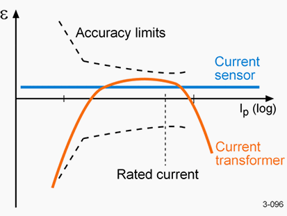

The problems related to saturating iron core in conventional current transformers can be overcome with the sensor technology. The below figure demonstrates the difference between the secondary-signal performance for both traditional current transformer and current sensor.
Principle comparison of current sensor and current transformer secondary-signal performance as a function of combined error (ε) and primary current (IP)
Figure 3 – Principle comparison of current sensor and current transformer secondary-signal performance as a function of combined error (ε) and primary current (IP)

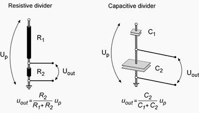

The measurement of voltage is based on voltage divider. Two main types are available, namely the capacitive one and the resistive one. The output in both cases is a low-level voltage signal. The output is linear throughout the whole rated measurement range.
The considerations and protection methods against the ferroresonance phenomena, discussed with traditional voltage transformers, are not applicable with voltage sensors.
Two main principles for voltage sensor implementation
Figure 5 – Two main principles for voltage sensor implementation
As with current sensors, also with voltage sensors it is possible to cover certain voltage range with one sensor type. To give an idea of the secondary voltage signal level, one fixed point (ratio) inside the rated voltage range could be 20000/√3V primary value, typically corresponding to 2/√3V secondary-signal level.

    The voltage divider formula for capacitor that has been mentioned above contains mistake. It should be Uout= C1/ ( C1+C2) * Up
