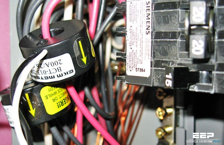

Current sensors as the eyes of RCD and tips for their correct installation
Current sensors as the eyes of RCD and tips for their correct installation (photo credit: NLCPR.com)

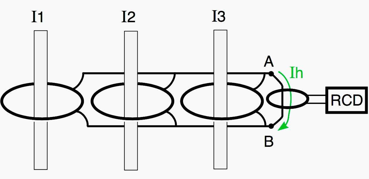

To measure the residual current of a 3-phase electrical circuit without neutral, three current transformers must be installed as shown in figure 2.
The vector sum of the phase currents yields the residual current
Figure 2 – The vector sum of the phase currents yields the residual current
The three CTs are parallel-connected current generators, causing circulation between A and B of a current which is the vector sum of the three currents and thus the residual current.
This circuit, known as the Nicholson circuit, is commonly used in MV and HV when the earth fault current can reach several dozen or even several hundred amperes.
During use, care must be taken with the CT accuracy class: with CTs of 5 % class, it is prudent not to set earth protection below 10 % of their nominal current. The HV electrical installation standard NF C 13-200 specifies 10%.

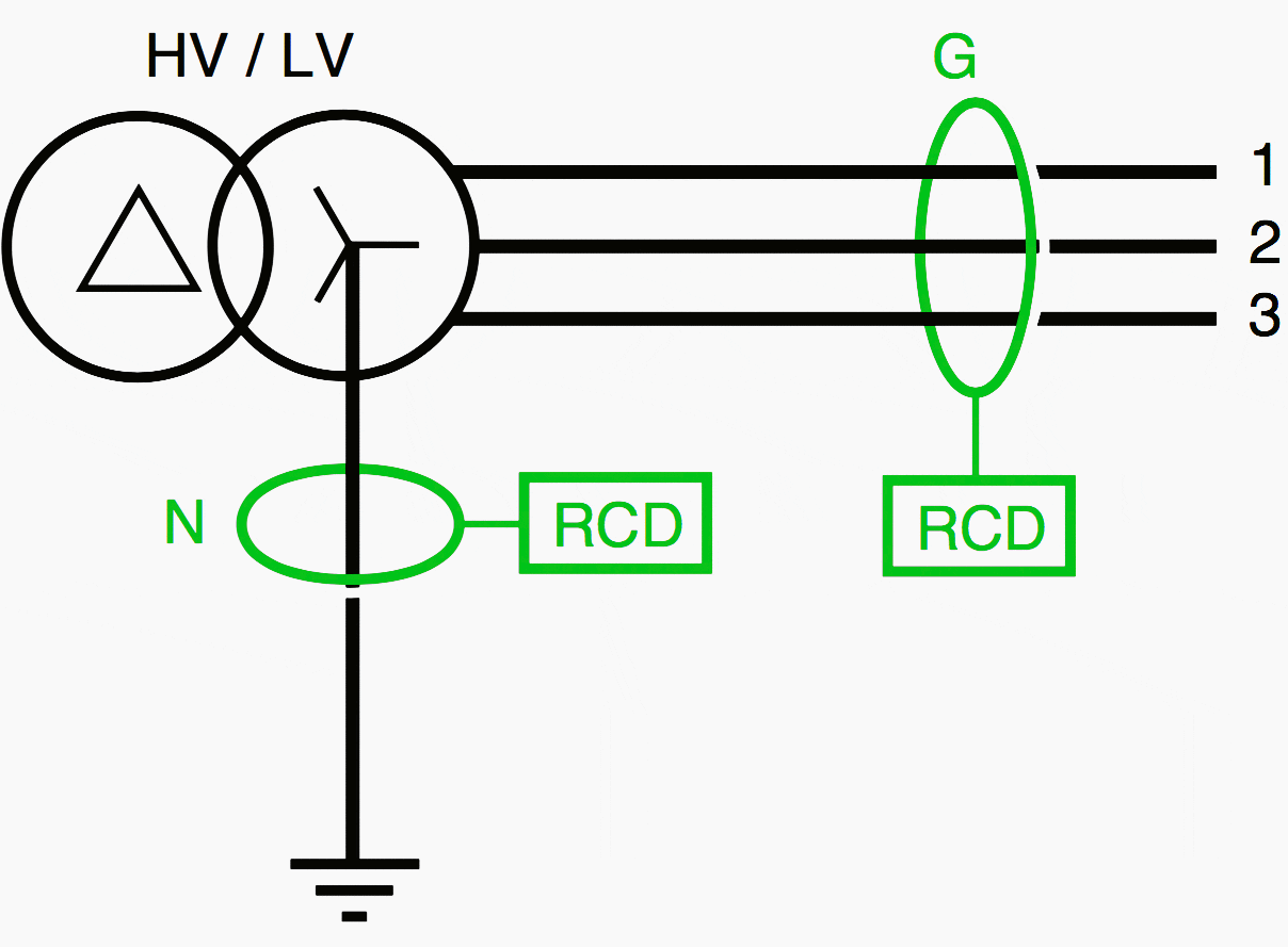

If the problem occurs in a main switchboard downstream of the transformer, the following may be considered:
Either installation of a toroid at the supply end of the installation on the earthing connection of the transformer LV neutral (see fig. 4). This is because, according to the Kirchhoff node law, the residual current detected by (N) is strictly the same as that detected by (G) for a fault occurring in LV distribution,
Toroid N delivers the same information as toroid G
Figure 4 – Toroid N delivers the same information as toroid G

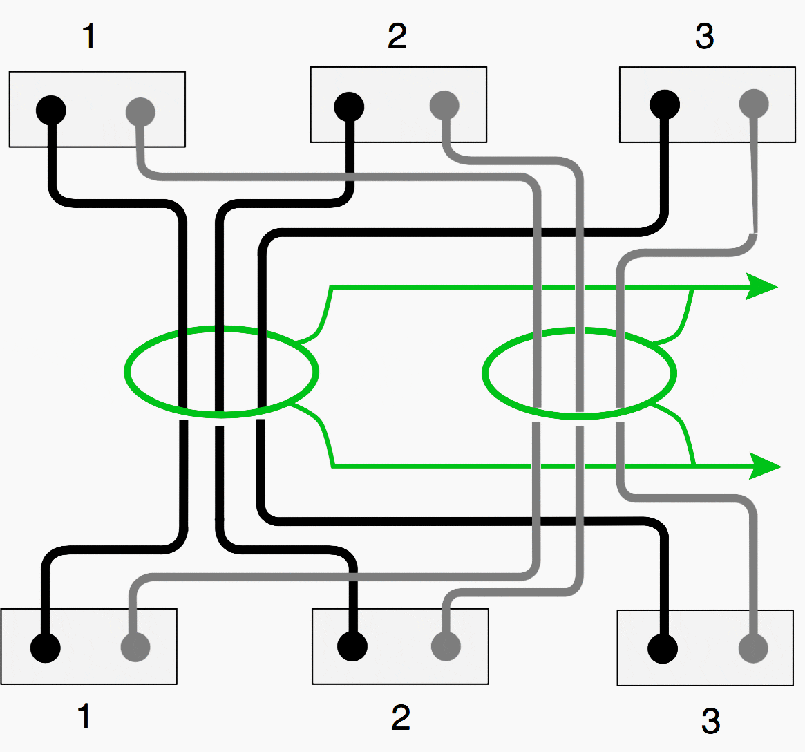

Solution #2
If the problem arises with parallel-connected cables which cannot all cross a toroid, a toroid can be placed on each cable (including all the live conductors), and all the toroids can be parallel-connected (see fig. 5).
Layout of toroids on parallel-connected large diameter single-line cables
Figure 6 – Layout of toroids on parallel-connected large diameter single-line cables
However the following must be noted:
  1. That each toroid detects n turns in short-circuit (3 in the figure) which may reduce sensitivity.
  2. If the connections represent impedance differences, each toroid will indicate a false zero phase-sequence current. However proper wiring considerably limits these currents.
  3. That this circuit implies for each toroid that the output terminals S1-S2 be marked according to the energy flow direction. This solution calls for the approval of the RCD manufacturer.

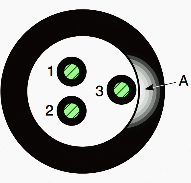

To ensure a reliable, linear toroid “response”, the live conductors must be placed as close as possible to the centre of the toroid so that their magnetic effects are completely compensated in the absence of residual current. In actual fact, the magnetic field developed by a conductor decreases in proportion to distance.
Thus in figure 7 , phase 3 causes at point A a local magnetic saturation and thus no longer has a proportional effect.
Incorrect centering of conductors in the toroid is responsible for its local magnetic saturation at point A, which may be the cause of nuisance tripping
Figure 7 – Incorrect centering of conductors in the toroid is responsible for its local magnetic saturation at point A, which may be the cause of nuisance tripping

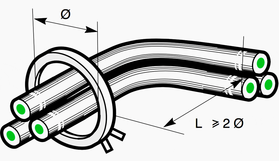

The same applies if the toroid is placed near or in a bend of the cables that it surrounds (see fig. 8). The appearance of a stray residual induction, for strong currents, will generate on the toroid secondary a signal that may cause nuisance tripping.
The risk increases as the RCD threshold drops with respect to phase current, particularly on a short-circuit.
The toroid must be far enough from the cable bend so as not to be the cause of nuisance tripping
Figure 8 – The toroid must be far enough from the cable bend so as not to be the cause of nuisance tripping

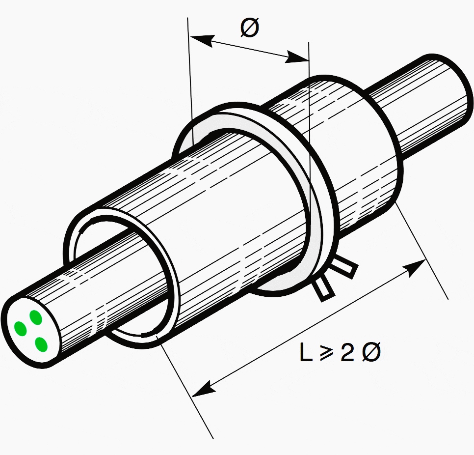

In problem cases (Max. Iph. / high I∆n), two solutions can be used to counter the risk of nuisance tripping:
  1. Use a toroid that is far larger than necessary, for example with a diameter that is twice the one just right for conductor insertion.
  2. Place a sleeve in the toroid.
This sleeve must be made of magnetic material in order to homogenize the magnetic field (soft iron – magnetic plate), (see fig. 9).
A magnetic sleeve placed around the conductors, in the toroid, reduces the risk of tripping due to the magnetic effects of the current peaks
Figure 9 – A magnetic sleeve placed around the conductors, in the toroid, reduces the risk of tripping due to the magnetic effects of the current peaks
When all these precautions have been taken: centering of conductors,  large toroid, and magnetic sleeve, the ratio max. Ι phase / I∆n may reach 50,000.
