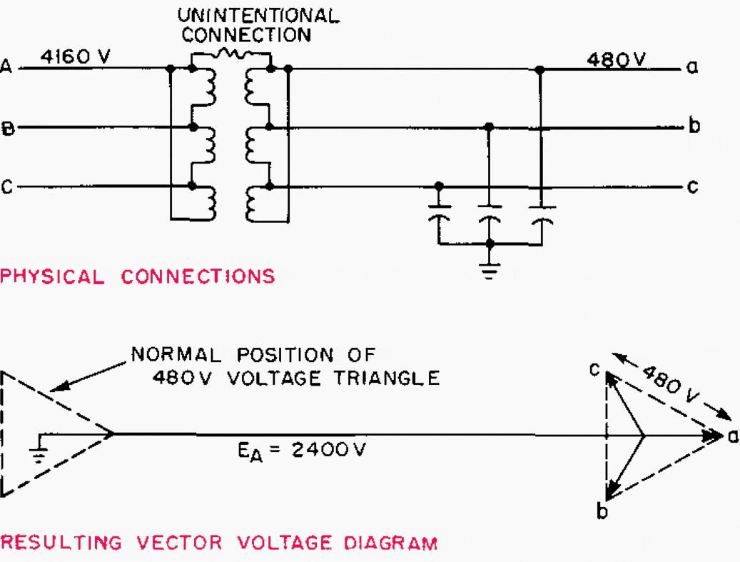

2. Physical contact with a higher voltage system
If the conductors of a high-voltage electrical circuit come in contact with those of a lower voltage circuit, then the same potential will exist on both circuits at the point of contact. If the low-voltage circuit does not have its neutral grounded, its potential will be increased to that of the high-voltage system or flashover will occur.
If the low-voltage system is anchored close to ground potential as by the use of a solidly grounded neutral, high values of current may flow from the high-voltage system, but a much lower voltage will appear than with an isolated neutral system.
Accidental contacts between primary and secondary voltages on industrial systems are guarded against by the use of metal enclosures and metal barriers that separate conductor systems of different operating potentials. In some cases, overhead circuits have both primary and secondary on the same pole, but substantial clearances reduce the danger of accidental contact to a minimum.
Occasional cross-ups have occurred between primary and secondary on overhead circuits, and a few cases are known where failure has occurred between primary and secondary inside a transformer.
Figure 1 – Overvoltage on 480V ungrounded system resulting from contact with a higher voltage system
Figure 1 illustrates this type of fault connection. It can be responsible for dangerous overvoltages on ungrounded low-voltage systems.
The most effective protection against that type of overvoltage is grounding of the low-voltage system with the grounding impedance made low enough to accept the maximum line-to-ground fault current of the high-voltage system without biasing the neutral of the low-voltage system by a dangerous amount.

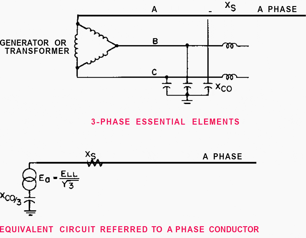

Every ungrounded electric system contains the essential elements presented in the diagram of Figure 2. The electrical behaviour of any single-phase conductor relative to the ground can be determined by a much simpler equivalent circuit, as indicated in the lower sketch of Figure 2.
Figure 2 – Elemental composition of an ungrounded system
In terms of this simpler equivalent circuit, it will be possible to understand readily the effect of connecting different types of impedance between line and ground as shown in Figure 3. It becomes evident that the connection of any value of either resistance or capacitance between a single line and the ground produces no dangerous overvoltages.
The potential on the phase to which the impedance is connected progressively diminishes from a normal value to zero. The potential to the ground on the remaining two phase conductors will be increased to full line-to-line value at the time the first phase conductor has been reduced to zero potential.
This represents an overvoltage of only 73%, which is not dangerously high and will normally produce no dangerous effect unless continued for a long time.
The connection of an inductive reactance between line and ground, on the other hand, can be responsible for the production of serious overvoltages to the ground. It is the ratio of the inductive reactance of the line-to-ground circuit to the total capacitive reactance of the system to ground which controls the degree of overvoltage.
The highest overvoltage will occur when these two reactances are equal, and at this point, they may be as much as ten times normal. It is significant to note, however, that over a two-to-one range of reactance, overvoltages of three times normal or more would be produced.

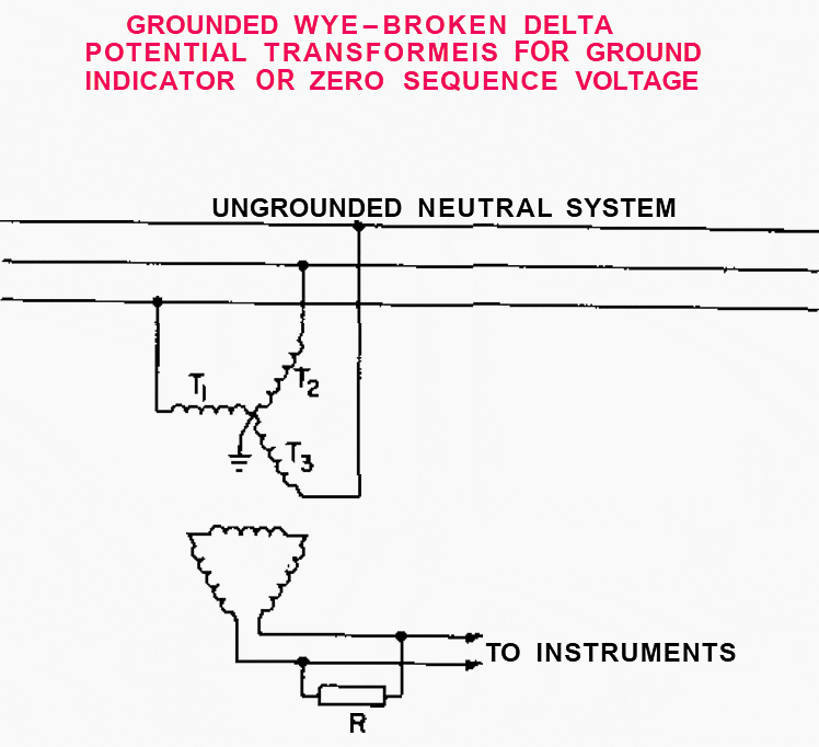

The application of grounded-Y potential transformers on ungrounded systems with a Y or broken-delta secondary connection can be responsible for damaging overvoltages as a result of resonant or ferroresonant action since the magnetizing reactance of the potential transformers becomes connected from phase conductors to ground.
These system voltage oscillations will not occur if the electric system neutral is grounded. Freedom from this particular type of voltage oscillation can be obtained even with ungrounded-neutral operation by using potential transformers with a line-to-line voltage rating and the application of shunting resistors on the secondary windings as is outlined in Figure 5.
Figure 5 – Grounded-Y broken delta potential transformers for a ground indicator or zero-sequence voltage detector
To ensure freedom from unwanted line-to-ground ground voltage oscillations:
  1. Select PTs T1, T2 and T3, with the line-to-line rated voltage
  2. Apply a secondary loading resistor with a resistance not greater than 40% of the transformer magnetizing reactance.
Important Note – The loading resistance can be applied to each secondary but will then consume power and liberate heat continuously (Learn more).

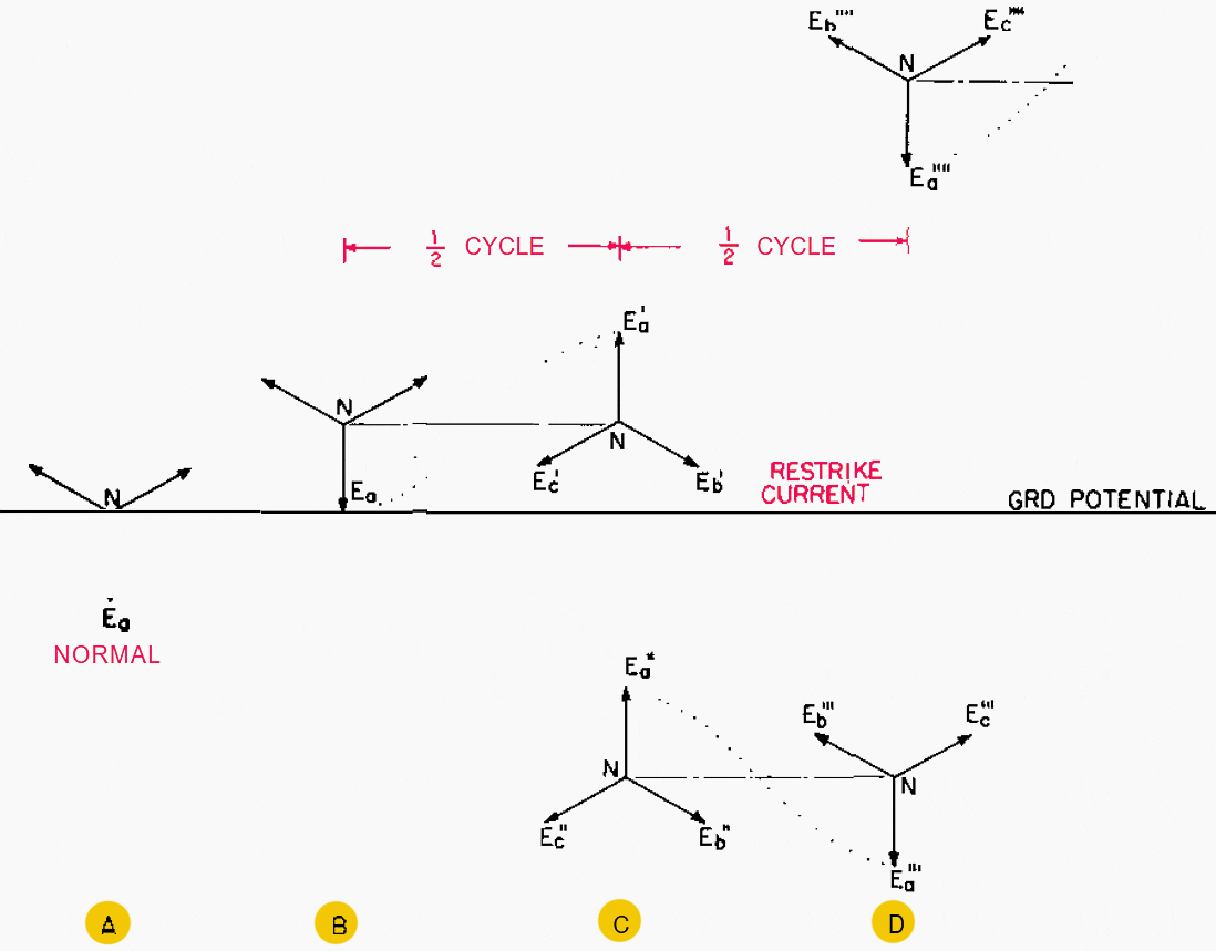

In Figure 7, at A is shown the vector voltage pattern of a three-phase AC system as it would operate under normal balanced conditions. The voltage vectors Ea, Eb, and Ec rotate about the neutral at synchronous speed. The electric neutral is a point of central symmetry and remains constant at ground potential if the individual phase voltages are pure fundamental-frequency sine waves.
Figure 7 – Overvoltages on ungrounded systems due to repetitive momentary contact between one line and ground
Should the A-phase conductor become grounded, the system voltage triangle would become displaced as illustrated in B. At the phase position illustrated in B, the A-phase voltage is at its maximum value at which instant the charging current to ground (90° ahead of the voltage) is passing through zero.
In case the short circuit contains a small gap or an arc, the arc current would become extinguished at this point. Note that the trapped charge on the line-to-ground capacitance will tend to maintain the voltage triangle in the same displaced position. In other words, the potential of the neutral (relative to ground) would tend to remain at a DC potential equal to the crest value of the a-c voltage wave.
All this merely says that there will be little tendency for any voltage to reappear across the gap in the short circuit immediately following the current zero which occurs at B.
During the next half-cycle, however, the AC generated voltages will reverse their polarities (vectors rotate 180°), which would cause the three-phase vector voltage pattern to assume the position shown in the upper part of C.
Note that during this one-half cycle time interval, the potential of the A-phase has progressively increased from zero value to about twice the normal line-to-neutral crest voltage relative to ground potential. This value of the line-to-ground potential of the A-phase may be sufficient to break down the gap in the ground-fault circuit and re-establish the connection between the A-phase and ground. If so, the A-phase potential will tend to be suddenly yanked to ground potential.
Inevitably there will be some system reactance in the A-phase conductor to the ground short-circuit point which would result in an oscillation of the A-phase-conductor potential between +2 and −2 at a frequency probably 20 to 100 times normal. If the short circuit consisted of a solid metallic connection, this oscillation would decay to zero, leaving the A-phase conductor at ground potential.
Note that associated with this high-frequency transitory oscillation will be a corresponding transitory charging current to the ground.
This transitory charging current to ground, or restrike current, will again reach zero value when the system voltage swing is at the maximum excursion in the negative direction, as shown in the lower part of C.

7. Autotransformer connections
Autotransformers for interconnecting two electric systems of different insulation levels should be avoided in industrial systems unless both are solidly neutral grounded. The common metallic interconnection between the two systems which is formed by the autotransformer windings tends to subject the lower voltage system to nearly the same transitory voltages as would be expected on the higher voltage system.
There are some exceptions, and a specific example will serve to illustrate nature.
Should a system be planned which is to operate initially at 2400 V and later be converted to 4160 V with all equipment therein containing insulation levels commensurate with 4100 V operating potential, it would be satisfactory to employ a suitable autotransformer for interconnecting this 2400V system with another 4160 V system.

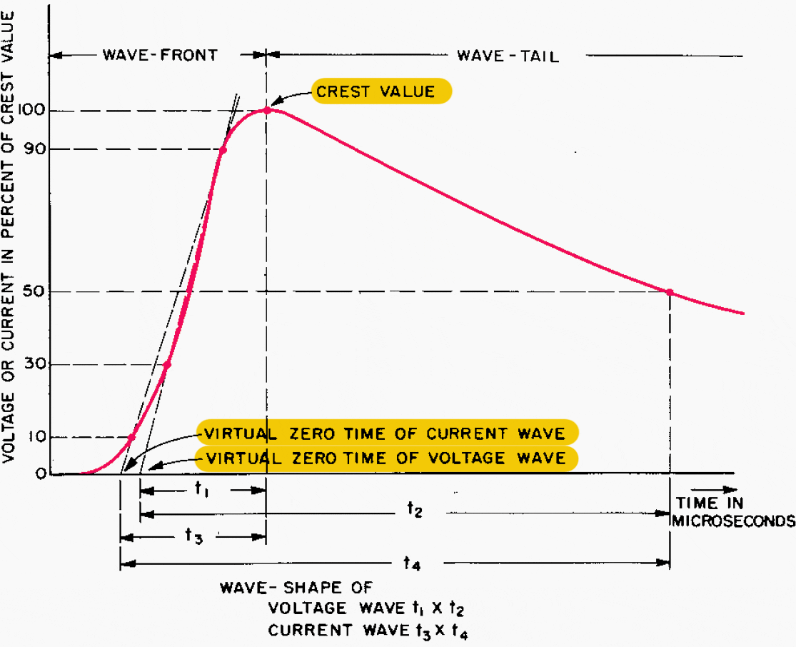

Wave Shapes
Although the voltage surges produced by lightning have high magnitudes, their duration is very short. It is measured in microseconds (millionths of a second). Typically, the voltage rises very rapidly (in 1 to 10psec) to the maximum or “crest,” value and then decays more slowly, reaching 50% of the crest value in 20 to 150 psec.
As illustrated in Figure 12, the shape of a voltage or current, surge produced by lightning (and those produced artificially for test purposes) is
customarily expressed by two numbers.
Figure 12 – Terms ured to describe voltage and current waves
The first is the time from the “virtual zero” of the wavefront to the time the wave reaches the crest value, while the second number is the time from the virtual zero to the time the voltage or current has decreased to 50 per cent of the crest value. The virtual zero of a wavefront is the intersection with the zero axis of a straight line drawn through the points on the front of the wave which are 30% and 90% of the crest value for a voltage wave and 10% and 90% of crest value for a current wave.
Both times are usually expressed in microseconds. To illustrate, a 95 kV 1½ × 40 psec wave is one that has a crest value of 95 kV, rises to crest value in 134 psec from the time of virtual zero, and decays to 50% of crest value (47.5 kV) in 40 psec from the time of virtual zero.
