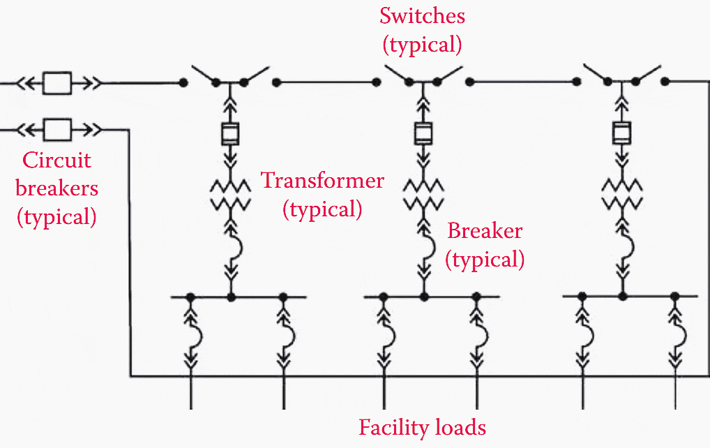

Figure 6 illustrates a distributed and redundant power-distribution system that permits transferring loads as required to patch around a fault condition. This configuration also allows portions of the system to be de-energized for maintenance or upgrades without dropping the entire facility.
Note the loop arrangement and associated switches that permit optimum flexibility during normal and fault operating conditions.
Figure 6 – A redundant, fault-tolerant secondary plant distribution system
