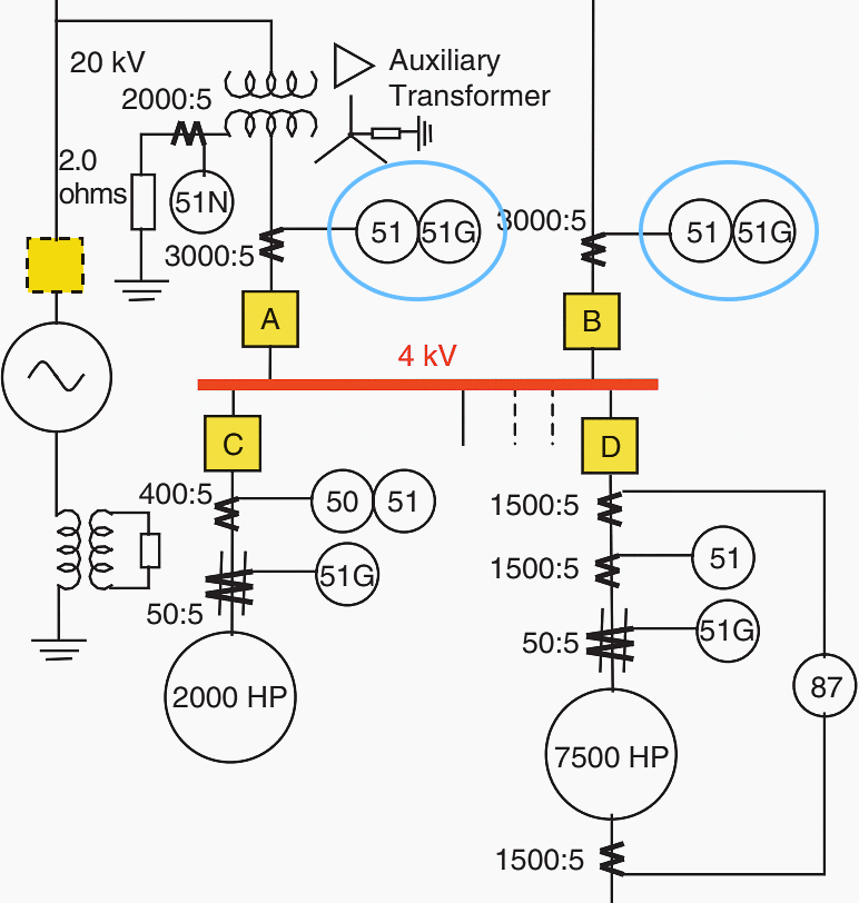

A portion of a typical auxiliary system of a unit-connected generator is shown in Figure 1 below.
The 4 kV auxiliary bus is fed directly from the 20 kV generator leads or from the startup transformer and is the source for the major motors. As unit sizes increase, the auxiliary load increases proportionately, requiring higher rated transformers and higher rated, higher voltage motors. This has resulted in higher bus voltages, such as 6.9 kV and 13 kV.
Phase fault currents also increased, requiring switchgear with higher interrupting capacity. In sizing the switchgear there are two contradictory factors that must be considered. The impedance of standard transformers increases as their ratings increase.
Since the normal and short-circuit currents are also increasing, there is a greater voltage drop between the auxiliary bus and the motor.
Single line diagram of a typical power plant auxiliary system
Figure 1 – Single line diagram of a typical power plant auxiliary system with unit-connected generator
Normal design practice is to maintain at least 85 % voltage at the motor terminals during motor starting. If the standard transformer impedance is specified to be at a lower value to reduce the voltage drop and maintain the 85 % voltage criterion, the interrupting current will increase requiring larger rated switchgear
If the transformer impedance is raised to reduce the fault current, and hence the interrupting capacity requirement of the switchgear, the voltage drop will be too high.
The art of designing the auxiliary system must take all of these factors into account. Transformers can be specified with special impedances at a greater cost. The auxiliary system can be designed with several bus sections thus reducing the transformer rating for each section.

Phase fault protection (51)
The phase overcurrent relays (51A and 51B) on the secondary of the unit auxiliary and startup transformers provide bus protection and backup relaying for individual motor protection and switchgear.
Figure 1 indicates the general arrangement of the buses and loads and shows the protection of the 2000 hp motor and the 7500 hp motor.
Ideally, the backup overcurrent relays 51A and 51B should have pickup settings greater than the highest motor protection relay, and time delays longer than the longest starting time. These settings may be so high, or the times so long, that the protection is not acceptable and modifications or compromises are required as discussed below.
If the relays are also the primary bus protective relays, the settings may be so high that there may not be enough bus fault current to provide sufficient margin to ensure pickup for the minimum bus fault.
Phase overcurrent relays (51A and 51B) on the secondary of the unit auxiliary and startup transformers
Figure 4 – Phase overcurrent relays (51A and 51B) on the secondary of the unit auxiliary and startup transformers as a bus protection and backup relaying for individual motor protection and switchgear
Even if coordination is theoretically possible, the required time delay may be too long to be acceptable. Some compromises are possible. Since the largest motors will probably have differential protection, the backup function could consider coordinating with the overcurrent relays of the smaller motors with an associated reduction in pickup.
Assuming that the differential relays are always operative, coordination with the larger motors is not a problem since the differential protection is instantaneous. Coordination would be lost if the differential relays fail to clear a fault and the time-delay overcurrent relays must do it. This is usually an acceptable risk.
A bus differential relay could be used to provide primary protection and the overcurrent relays provide backup protection for motor relay or switchgear failures. The time delay may then be acceptable. The pickup setting must still recognize the magnitude of starting current of the largest motor.
If it cannot be set above this value, an interlock must be provided which will block the backup relay.

The importance of ground fault protection cannot be overemphasized. Ground is considered to be involved in 75–85 % of all faults. In addition, phase overcurrent may often reflect a temporary process overloading, while ground current is almost invariably an indication of a fault.
Auxiliary systems may be either delta- or wye-connected. A delta system is normally operated ungrounded and is allowed to remain in service when the first ground indication appears. It is generally assumed that the first ground can be isolated and corrected before a second ground occurs.
It is not uncommon for systems of 600 V and less to be delta-connected. Medium-voltage systems (5 kV to 15 kV) are generally operated in wye, with a neutral resistor to limit the ground current to some definite value.
The resistor has a time-related capability, e.g. 10 s, at the maximum ground current and it is a function of the ground protective system to remove all faults within this time constraint.
2.0 Ω neutral resistors in the auxiliary and startup transformers
Figure 6 – 2.0 Ω neutral resistors in the auxiliary and startup transformers
In Figure 6, ground faults on the 4 kV system are limited by the 2.0 Ω neutral resistors in the auxiliary and startup transformers. The magnitude of the maximum fault current is the lineto-ground voltage divided by the 2.0 Ω resistor. The nominal voltage of the bus is 4 kV but its normal operating voltage is 4160 V.
Therefore, the maximum ground current is 4160/(√3 × 2) or 1200 A.

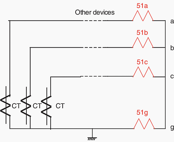

Coordination must, of course, begin at the load. If the motor ground overcurrent protection is provided by the toroidal CT shown in Figure 7 there is no coordination problem.
Current transformers in relay protection applications
Figure 7 – Current transformers in relay protection applications (photo credit: merko.ee)
These can have a ratio of 50:5 resulting in a relay current of 120 A. Set an instantaneous relay at 5.0 A. If a residual ground relay is used as shown in Figure 8, the maximum ground fault through the CTs on breakers A and B is 1200/600 = 2.0 A. Set the time-delay ground overcurrent relays at 0.5 A and 15–30 cycles.
The motor relays trip the associated feeder breaker, 51A and 51B trip the 4 kV main breakers and the neutral relays 51N trip their associated primary breakers.
Residually connected ground relay
Figure 8 – Residually connected ground relay
