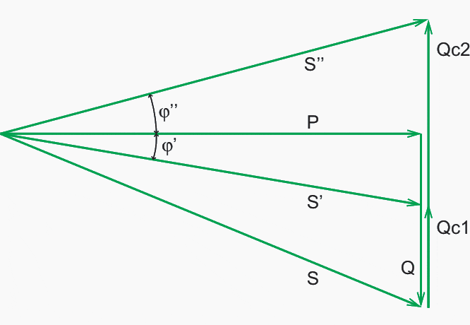

1.3 Over-compensation
When the power compensation (Qc1) is determined correctly, its value must be as close as possible to the reactive power Q to be compensated and the phase shift angle (ϕ’) tends towards 0. If the compensation (Qc2) is greater than the reactive power, the phase-shift angle (φ”) increases, and the apparent power S” increases.
The circuit becomes predominantly capacitive. This leads to an increase in the current consumed which defeats the purpose.
Figure 5 – Over-compensation
Over-compensation
Over-compensation also tends to increase the voltage applied to the installation. It must be avoided. It is generally considered that it should not exceed 1.15 times the power to be compensated. The use of power factor controllers and step capacitor banks avoids problems of overcompensation.
Figure 6 – Over-compensation currents
Increasing the voltage applied to the installation
Figure 6 – Increasing the voltage applied to the installation
Over-compensation (Ic >Ir), increases the apparent current consumed and also increases the voltage applied to the equipment. The illustration of vectors V2S (with over-compensation) and V2 (with appropriate compensation) shows this phenomenon, which must be avoided.
Care must be taken when choosing energy compensation.
Go back to Contents Table ↑

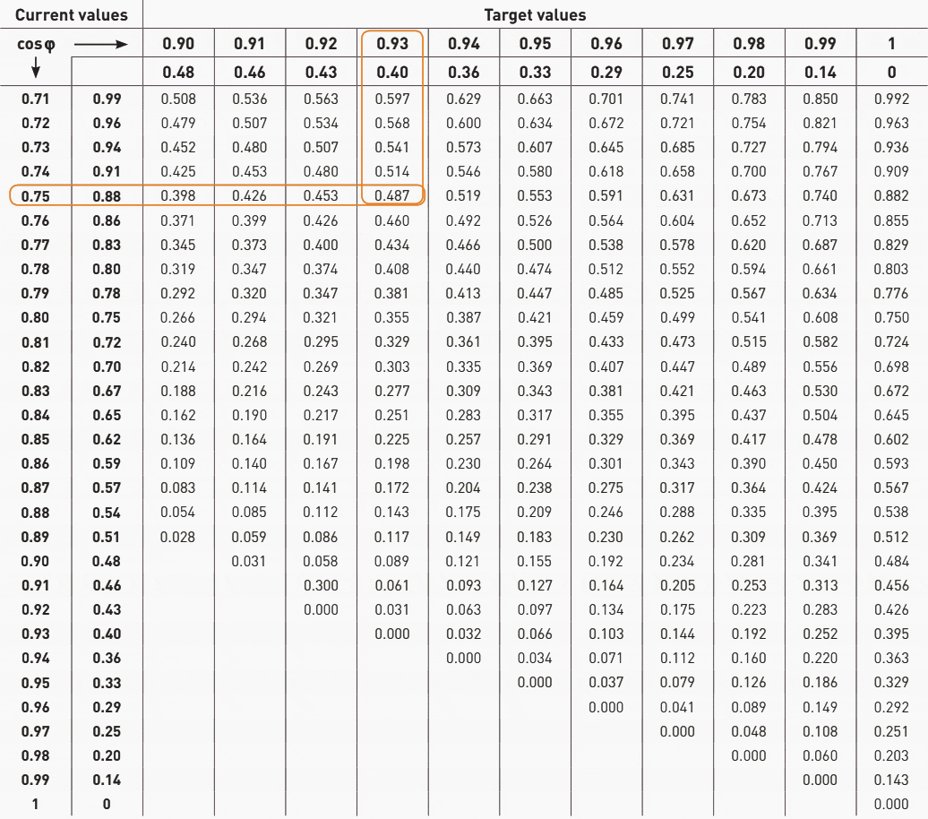

4. Conversion table
This table can be used to calculate (based on the power of a receiver in kW) the power of the capacitors to change from an initial power factor to a required power factor. It also gives the equivalence between cosϕ and tanϕ.
Table 1 – Power of the capacitors to be installed (in kvar) per kW of load
Example: 200 kW motor – cosϕ = 0.75 – cosϕ to be achieved: 0.93 – Qc = 200 × 0.487 = 98 kvar.
