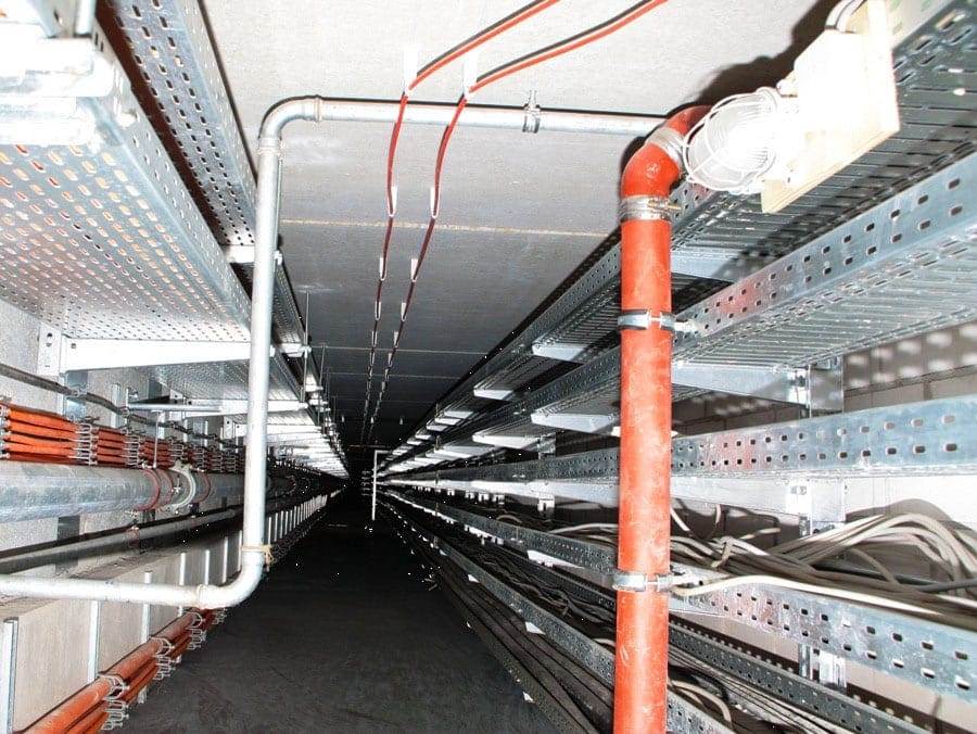

To be clear at the beginning of this article, determining the cross-section of conductors and cables is, for sure, not the most exciting part of electrical design. There are much more challenging and more exciting parts than staring at endless conductor tables. However, this part has to be done professionally the same way as all other parts of a design. So, take your glasses (if you wear one), get some coffee, and let’s start.
The art of determining the right cross-section of low voltage conductors
The determination of the cross-section of the conductors is based on knowledge of the maximum current-carrying capacity of the wiring system, which is itself determined based on the conductors and their operating conditions. Standard IEC 60364-5-52 determines the current values according to the basic operating principles for installations and safety of people. The main elements are given below.
The table of current-carrying capacities can be used to directly determine the cross-section of the conductors according to:
