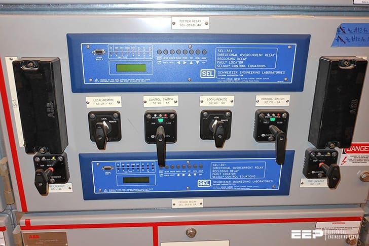

Directional protection is usually applied to distribution systems that contain multiple power sources, parallel circuits and rings/loops. For such systems it is absolutely necessary to have protection against fault currents that could circulate in both directions, avoiding disconnection of unnecessary circuits.
