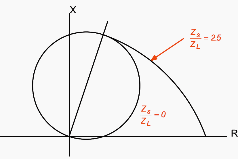

The amount of the resistive coverage offered by the mho circle is directly related to the forward reach setting. Hence, the resulting resistive coverage may be too small in relation to the expected values of fault resistance.
One additional benefit of applying cross-polarisation to a mho impedance element is that its resistive coverage will be enhanced.
This effect is illustrated in Figure 6, for the case where a mho element has 100% cross-polarisation. With cross-polarisation from the healthy phase(s) or from a memory system, the mho resistive expansion will occur during a balanced three-phase fault as well as for unbalanced faults.
The expansion will not occur under load conditions, when there is no phase shift between the measured voltage and the polarising voltage. The degree of resistive reach enhancement depends on the ratio of source impedance to relay reach (impedance) setting as can be deduced by reference to Figure 6.
Fully cross-polarised mho relay characteristic with variations of ZS/ZL ratio
Figure 6 – Fully cross-polarised mho relay characteristic with variations of ZS/ZL ratio
It must be emphasised that the apparent extension of a fully cross-polarised impedance characteristic into the negative reactance quadrants of Figure 7 does not imply that there would be operation for reverse faults.
With cross-polarisation, the relay characteristic expands to encompass the origin of the impedance diagram for forward faults only.
For reverse faults, the effect is to exclude the origin of the impedance diagram, thereby ensuring proper directional responses for close-up forward or reverse faults.
