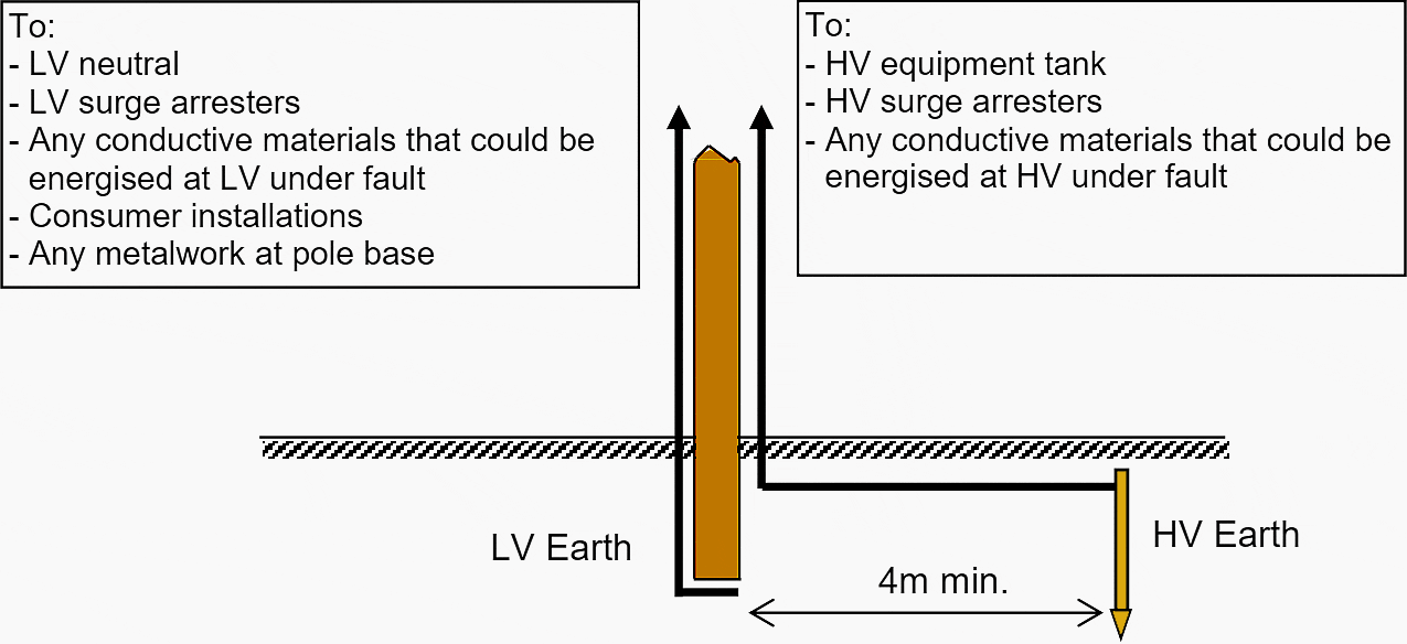

3. Separately Earthed System consisting of a Low Voltage Multiple Earthed Neutral (MEN) System and High Voltage Earth
In cases where the conditions required for CMEN earthing set out in Section 2 cannot be met, the high voltage earth must be kept separate from the LV MEN system. Typically this would occur in rural areas with low load density.
Separation is required to ensure high voltage earth faults, lightning impulses, or switching surges (e.g. conducted to earth through surge arresters) do not cause excessive EPR on the LV system.
The MEN system is used for the low voltage network. The neutral conductor is used as a low resistance return path for low voltage fault currents only. The general requirement is that the resistance to earth of the connected LV MEN neutral of the network must be less than 10Ω and the LV individual earth resistance (i.e. disconnected from the network neutral) must be less than 30Ω, except for the transformer neutral earth which requires 10 ohms.
The high voltage earthing system provides an earth return path for plant and equipment capable of being energized by the high voltage system (e.g. surge arresters, transformer tank).
The general requirement is that the HV individual earth resistance must be less than 30Ω for the pole-mounted plant and less than 10Ω for the ground-mounted plant. The lower earthing resistance for the ground-mounted plant is because there is a greater chance of the equipment being touched.
Figure 2 – Typical separate earthing system for overhead network
To ensure that the potential rise during high voltage faults does not cause a safety hazard to the operator or the general public, the high voltage earth is always insulated and separated from the low voltage earth in a separately earthed system, as shown in Figures 2 and 3.
