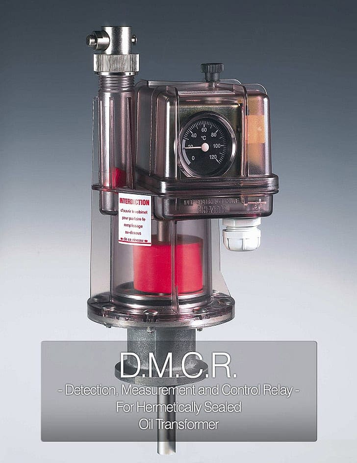

Introduction to D.M.C.R.
The DMCR is a protection relay designed for the hermetically sealed oil immersed transformers without gas cushion. This device enables complete control of the tank’s internal parameters, i.e. pressure, temperature, oil level and gas detection.
Fitted directly to the transformer cover, this relay ensures protection against internal faults, prolonged overvoltages and fire risks associated with the use of inflammable dielectric fluids.
The accessory continuously monitors:
  1. Dielectric fluid level,
  2. Tank internal pressure,
  3. Dielectric fluid temperature at two different thresholds.
To operate properly, the protection relay mustbe fully filled with fluid (level higher than the float visible in the transparent section of the unit). If this is not the case, check the instructions which appear inside each casing.

Possibilities of D.M.C.R.
1. Oil level control and gas detection
The DMCR enables to control both the oil level and the presence of gas inside the transformer’s tank. The DMCR body is a small see-through tank fitted on to the transformer’s tank. Should gas form inside the transformer, it will then accumulate inside the DMCR and cause the oil level to drop.
Visual information
The level drop is first visible through the lowering of the small red float inside the upper part of the DMCR, followed by the lowering of the main red float.
The 360 degree visibility is a specifically designed and patented system.
Electrical information
A circular magnet is fitted in the main float and it acts upon a magnetic changeover contact (REED switch) sitting inside the brass tube that runs through the float. The lowering of the float triggers the activation of an electrical contact, through the magnet’s motion.
A bleeding system facilitates gas collection inside the relay so that one can analyze it and understand the reason for its presence. The bleeding system has a male G1/8’’ thread, accordingto the standard.
For the oil level and gas detection control, the contacts have been chosen in order to use the REED switch’s working contact when the float is in a high position. This means that, in such a position, i.e. with a normal oil level and therefore normal conditions of use, the contact has already switched.
This is a positive safety system. With this method, any potential damage to the switch is immediately spotted.
The DMCR below is filled in with oil: the main float and the secondary float are both in high position.
The DMCR - Oil level control and gas detection
The DMCR – Oil level control and gas detection
