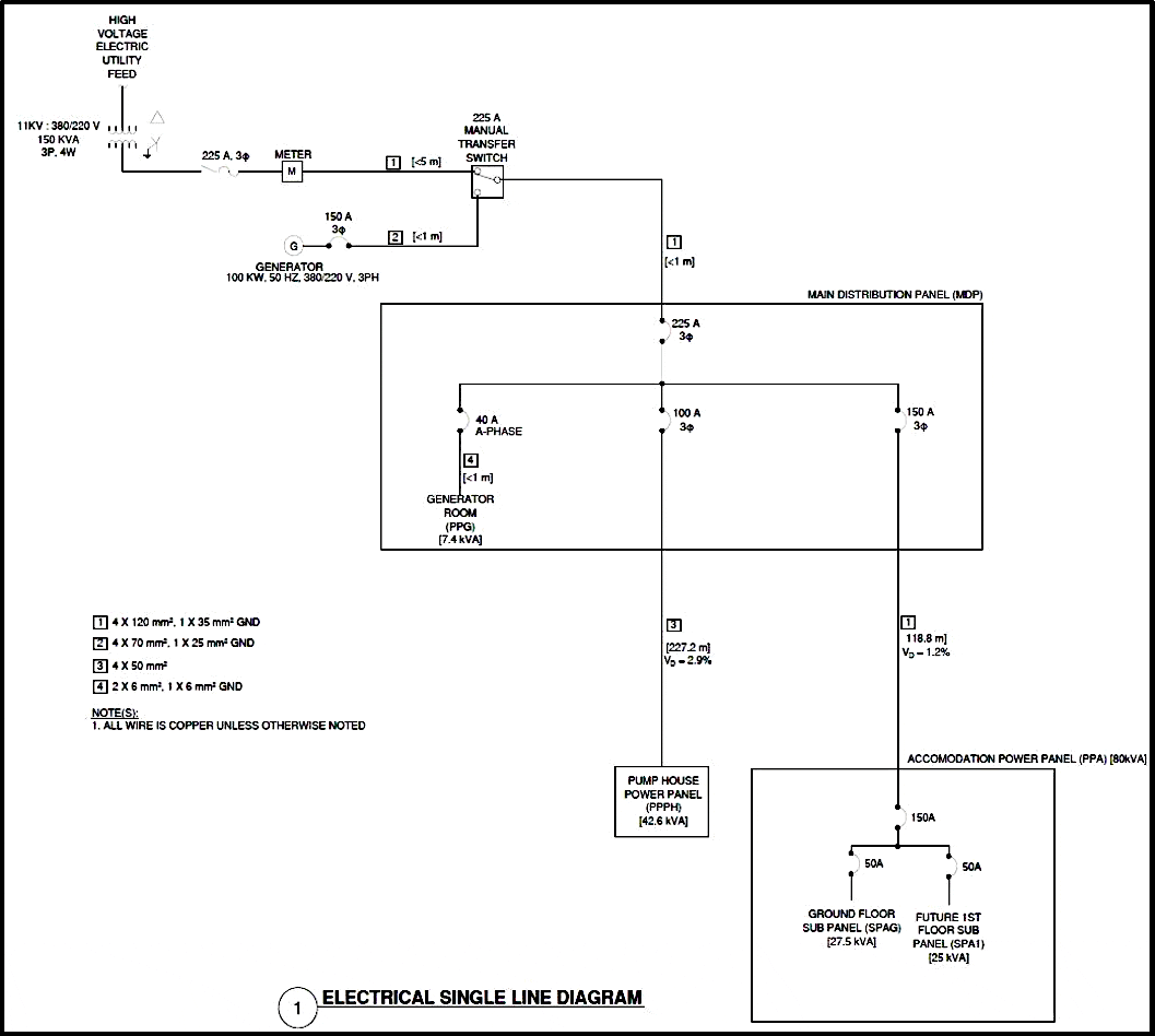

Single Line Diagram
Electrical designers use the single line diagram to capture information on an existing power system and to communicate proposed modifications. The flow of electric energy should be down and to the right from power sources at the top of the page to loads at the bottom.
The Single Line Diagram Template, shown here in Figure 2, is an example of a single line diagram for a small site. The two power sources in this example are the public utility and a backup generator.
A project will often require several versions of the single line diagram. The first one should be created as part of the initial site evaluation to capture the existing electrical system. This includes system details, such as existing wire and breaker sizes, as well as all identified hazards or deficiencies in need of correction.
Creating a single line diagram early is important as it allows for further analysis and facilitates communication with others. For example, an inspection of Figure 2 reveals that the transformer is sufficient to accommodate all present loads, but the generator can only serve as the backup power for part of the demand.
The client must make a choice. Either the generator and feeders to the transfer switch must be upgraded, or separate circuits and panels will be needed for the loads receiving backup power from the generator (up to 100 kW).
Alternatively, the output breaker of the generator should be sized to trip before the generator is overloaded. Loads would have to then be manually turned off when the site is on generator power.
Figure 2 – Example Single Line Diagram
The next version of the single line diagram will be created during conceptual design to show proposed changes to the existing system. This can be done by showing changes to the existing diagram (such as using a dashed line type to show new wiring and components). However, if the project is proposing significant additions and subtractions, it is often more clear to create a new single line diagram.
For presentation purposes, the two diagrams can be juxtaposed to show a before and after. The conceptual single line diagram should include power source and main breaker sizing, but no further details are necessary.
If the project proceeds to detailed design, the electrical designer will perform additional analysis. These details should be added to a new version of the single line diagram.

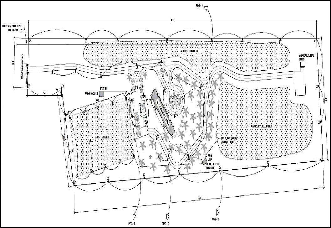

Electrical Site Plan
The Electrical Site Plan Template, shown here in Figure 3, details how the electrical system will be laid out across the site. It shows all the main feeder cables and their routing as well as all the site lighting.
The names and locations of the main panels (MDP, PPG, PPA) are also specified.
Figure 3 – Example Conceptual Electrical Site Plan

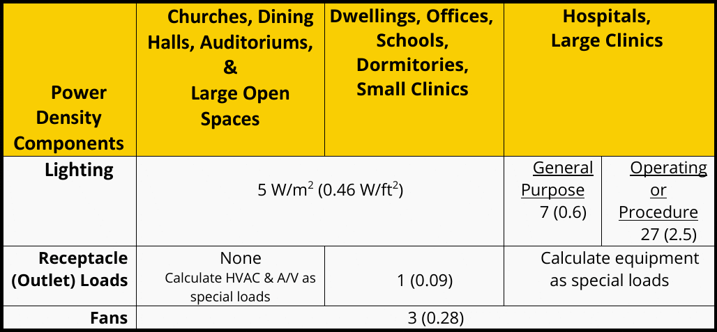

The load study for proposed construction must be estimated. The Spreadsheet (download at bottom) is a template for this process. General loads are estimated for each structure by measuring the useable area and multiplying by total power density. If the designer does not have normal power density information for the region, such data can be obtained by visiting representative buildings in the local area.
Barring that, Table 1 can be used for initial calculations.
Table 1 – Power Density Estimates by Structure Type
