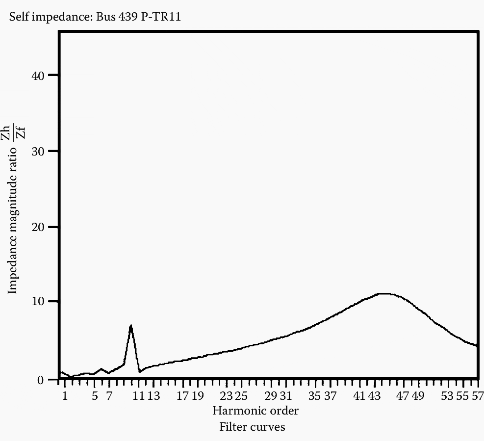

Figure 2 shows the abrupt increase in impedance (dotted line) revealing a resonant condition around harmonics 39 through 43.
Such a situation imposed severe stresses on the generator that comprised intense shaft vibration and increased operation temperature. Also shown is the Z–f characteristic of the band-pass filter that was applied at the 600-V generator bus. Filter elements were selected to obtain a corner frequency centered at around the 11th harmonic.
Impedance vs. frequency characteristics at the generator bus
Figure 2 – Impedance vs. frequency characteristics at the generator bus
Notice the system response with the high-pass filter showing a substantial reduction of the impedance at the resonant point.
