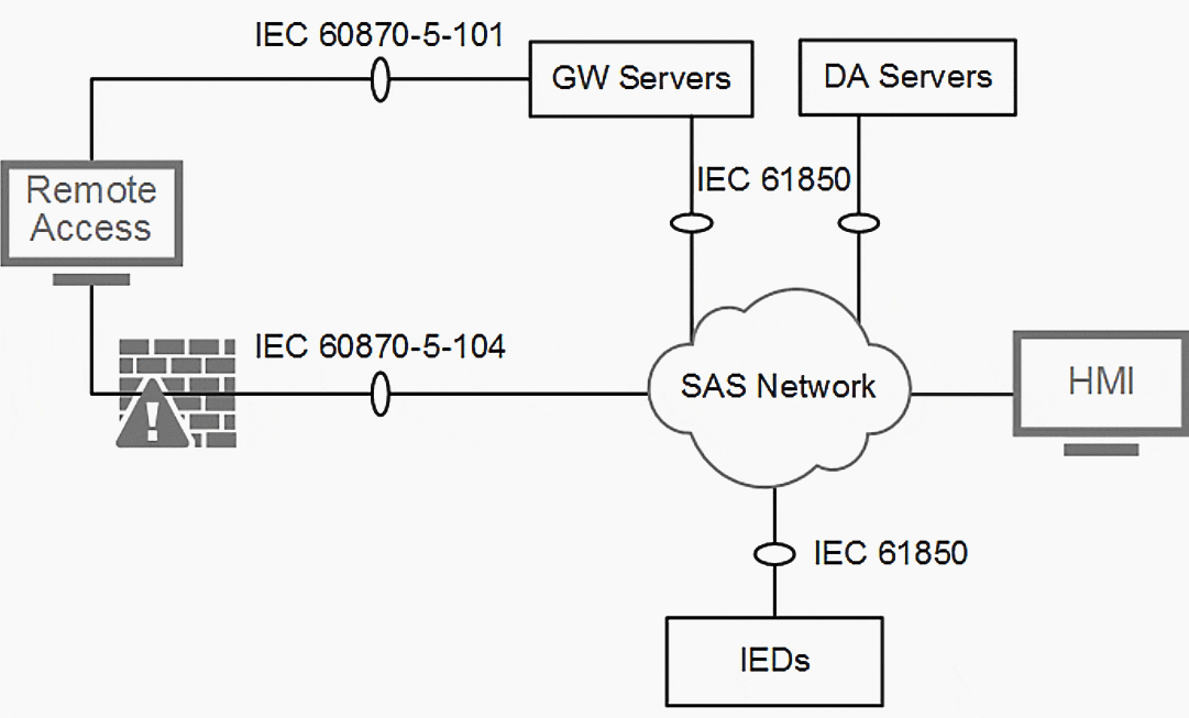

1.2 Gateway Server
The gateway server, also known as the GW server, assumes the responsibility of facilitating communication beyond the substation boundaries. Its primary function is to establish a connection with a master station, enabling the centralized management of all substations within a defined geographic region. The configuration of the SCADA application database is likewise implemented within the GW server.
The primary objective of this machine is to function as a protocol converter, facilitating the exchange of data between IEC 61850 and a range of other protocols employed within the substation, and the protocols employed in the master station, with a particular emphasis on IEC 60870-5-101 and IEC 60870-5-104.
The GW server has a crucial role; it is vital that another redundant machine be provided as backup. However, both GW servers always communicate with the field. The master station performs the redundancy by choosing which GW server to communicate through. In other words, both GW servers are configured as master-master (hot-hot).
Figure 2 below illustrates a standard configuration of DA and GW servers within the context of SAS.
Figure 2 – DA and GW Servers in an SAS Network
