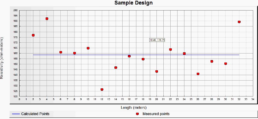

In order to obtain uniform soil model, Wenner-four-pin test results have to be considered. A graph that is composed of average resistivity values obtained from different electrode spacings is drawn to calculate approximate soil resistivity and it is given in Figure 2.
Since all the results close to each other, taking the average value of all results for different electrode spacings can be used to determine the soil resistivity as it is given in Table 1. Uniform soil resistivity value is computed as 158,51 Ω and in Figure 2, this average value is drawn as a line.

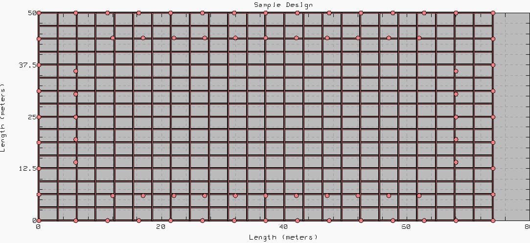

An initial grid configuration is designed by the author and it is given in Figure 3 There are 76 rods in this design and total length of grid conductors used in design is 2508 m. With the given grid configuration, Thapar-Gerez method ground resistance (R) is determined to be 1.33 Ω.
On the other hand, FEM analysis compute ground resistance (R) to be 1.11 Ω for the same grid design.

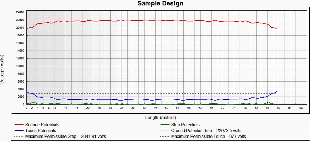

Ground potential rise (GPR=R·IG) of the given grid design is computed by ground resistance (1.11 Ω) and grid current (IG = 20kA). Moreover grid current is calculated by division factor (S f = 1), reduction factor (r = 0.65) and decrement factor (Df = 1.0313). These values are chosen according to national standards and none of them are computed explicitly for this specific problem.
From these calculations, GPR is calculated to be 22973 Volts. Maximum permissible touch potential is calculated as 877 Volts and Figure 4 shows the touch, step and surface potential distributions along the grounded area.
Figure 4 – Potential distributions of sample design
In Figure 4, step potential distribution is always under maximum permissible step potential (2841 Volts). On the other hand, touch potential in the region is not safe because value of touch potential is bigger than maximum permissible touch potential for most of the points.

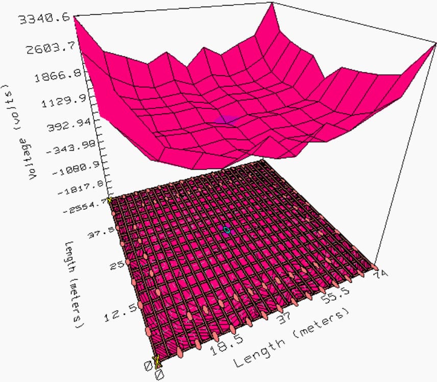

In Figure 5, touch potential distribution is given in three dimensional view.
Figure 5 – Touch potential distribution of sample design
In this figure, all regions are in the danger of high touch potential. Therefore, it can be observed that the design has to be enhanced. For the enhancement of design, division factor is recalculated for this special substation configuration without omitting overhead line impedance.
