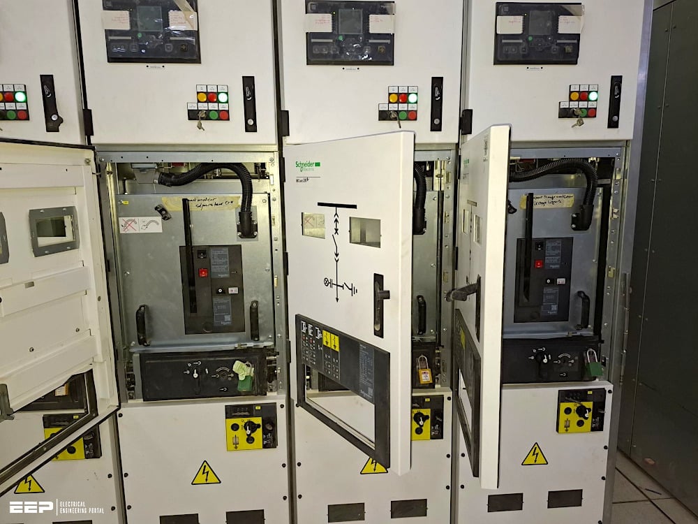

It takes a lot of work, documentation, and planning to commission a medium voltage switchgear or substation safely and on time. It is common practice to assemble and test new switchgear at the plant.
Be wary of equipment vendors who say they test their switchgear but don’t always back it up with thorough testing. Prior to shipment, the switchgear is dismantled. Once at the job site, it is reinstalled. This can lead to a slew of electrical and mechanical issues. In helping in the discovery of such issues, there are start-up lists and test protocols available, such as those specified by testing organizations, electric utilities, and equipment manufacturers.
A lot of the time, though, the electric system was well-planned and built with good intentions, but it wasn’t tested and examined by experts before it was put into operation.
The testing and inspection procedures that must be followed before or after energizing medium voltage switchgear and substation equipment are outside the scope of this study. When it comes to substation or medium voltage switchgear protection systems, though, it does cover a lot of ground to make sure they’re electrically suitable for service.

We evaluate DC control circuits to make sure that circuit breakers and other switching devices respond properly to all control signals and that panel lights and graphics on distant control room monitors work as intended. Functional testing should be used to verify the following control devices and operations:
  • Control switch trip and close functions and associated indicating lights
  • Protective relay tripping
  • Automatic transfer schemes
  • Lock-out relays and electrical interlocks
  • Local, remote, and supervisory (SCADA) control and indication
