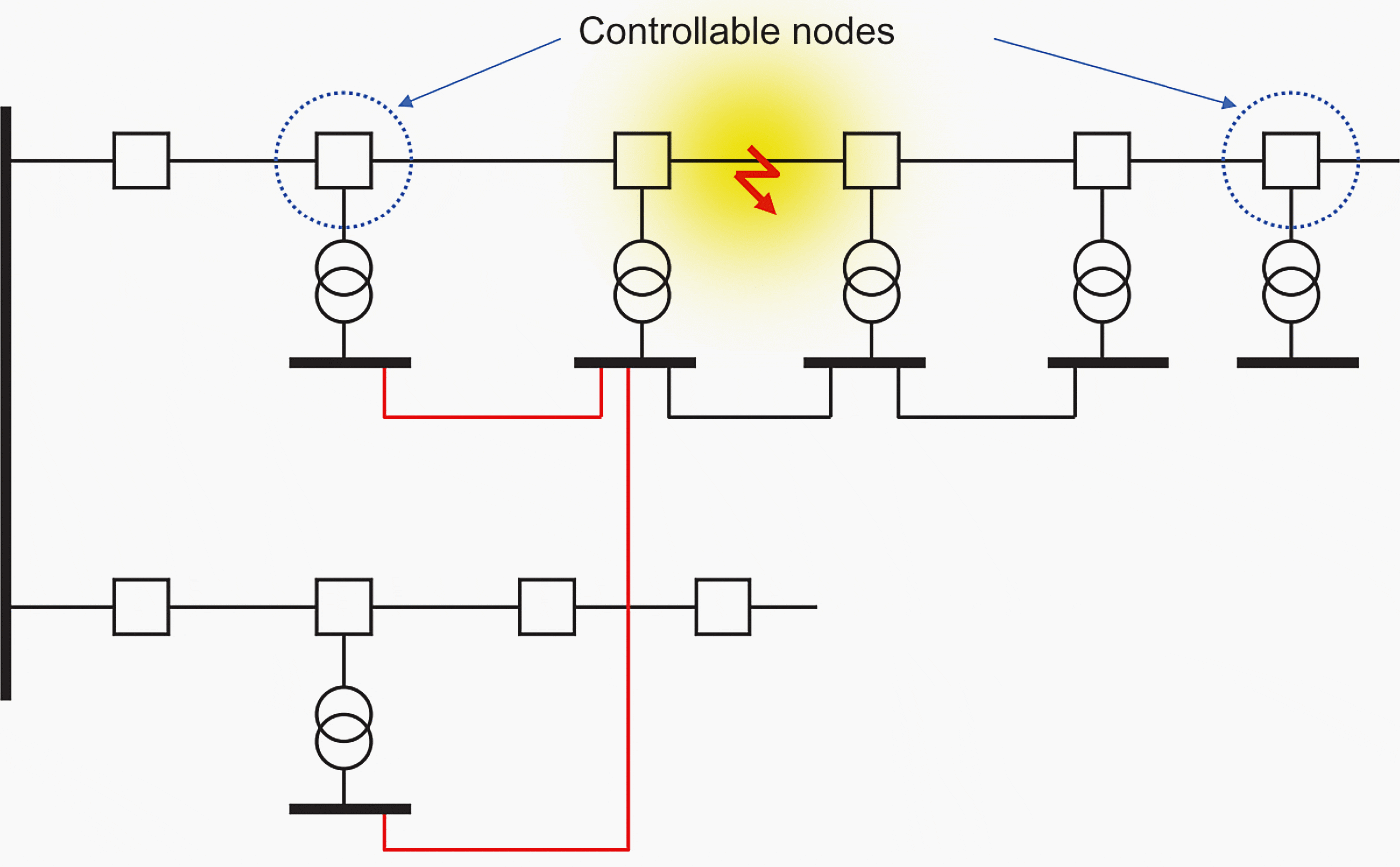

Precaution! – For utilization of the NOP for restoration in the MV network, it has to be made sure that the LV network is in a radial configuration so that there are no interconnections between the LV feeders being fed from different MV feeders.
This interconnection known as the LV-couplings is shown in Figure 3 below:
Figure 3 – LV coupling beneath the RMU configured MV network
This was observed by E. Antila, P. Heine, and M. Lehtonen in “Economic Analysis of Implementing Novel Power Distribution Automation” in a project where the local LV network had a meshed grid structure. This can lead to a hazardous situation where the faulty location (feeder) is kept energized even after isolation of the fault from the MV network due to the bridge between the LV-couplings.
This has to be avoided at all costs and consequently it necessitates the LV-networks to be configured in a radial grid structure which becomes a prerequisite for successful implementation of the service restoration process in a RMU configured MV network.
