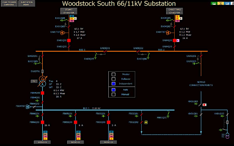

Figure 4 – Woodstock South 66/11kV Substation
