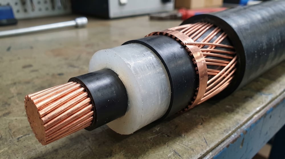

Figure 1 – Cross-section of a standard MV cable, showcasing the central copper core, translucent XLPE

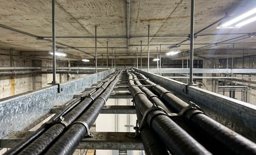

Figure 2 – Heavy-duty low voltage armored cables routed along a galvanized tray in an industrial plant. In IT systems, these must withstand sustained overvoltages.

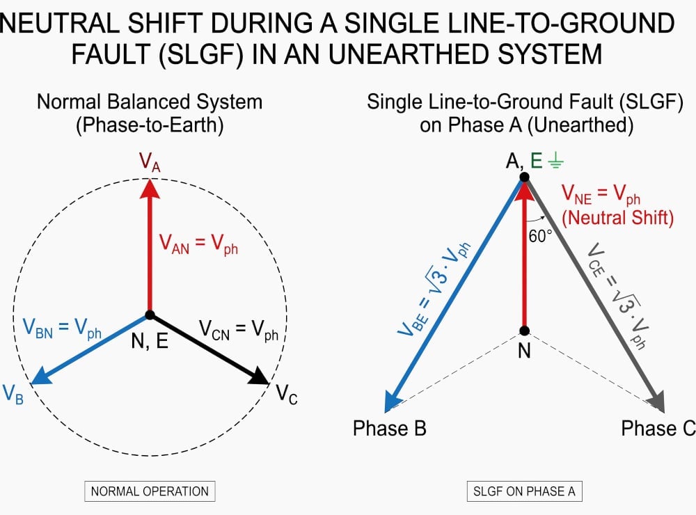

Figure 3 Illustrates the neutral shift in an unearthed network during a Single Line-to-Ground Fault (SLGF).
Let’s analyze Figure 3.
Left side (Normal Operation): Shows a balanced system where the neutral point N and earth potential E are identical (0V) at the center of the vector system. The phase-to-ground voltages (VAN, VBN, VCN) are equivalent to the standard phase voltage (Vph).
Right side (Single Line-to-Ground Fault on Phase A): When a fault occurs on phase A in an unearthed system, the ground potential E is forced to the potential of Phase A (E = A), while the source’s neutral N remains physically isolated.
This causes a Neutral Shift of VNE = Vph, representing the neutral-to-earth displacement. The healthy phases (B and C) experience a significant voltage rise to earth, becoming equal to the line-to-line value (VBE = VCE = √3×Vph), which is roughly a 73% increase in voltage stress.
Additionally, the phasor angle between the healthy phase-to-earth voltages collapses from 120° to 60°.
Figure 3 – Phasor diagram illustrating the neutral shift during an SLGF in an unearthed network
However, when an SLGF occurs on an unearthed network (or a network compensated via an arc suppression Petersen coil), the fault current is severely limited. Because the fault is not a solid short circuit to the source, the protective relays do not trip the circuit breakers immediately.
Instead, the entire capacitive network of the grid shifts in relation to earth. The faulted phase (L1 in Figure 3) is now electrically tied to earth potential (0V).
Therefore, the neutral point is forcefully shifted by U0 volts away from earth. The remaining healthy phases (L2 and L3) are now referenced against the grounded phase rather than the neutral point. From a vector mathematics standpoint, the voltage across the insulation of phases L2 and L3 increases from U0 to the full line-to-line voltage U, representing a multiplier of √3 (an exact 173.2% increase in electrical stress).

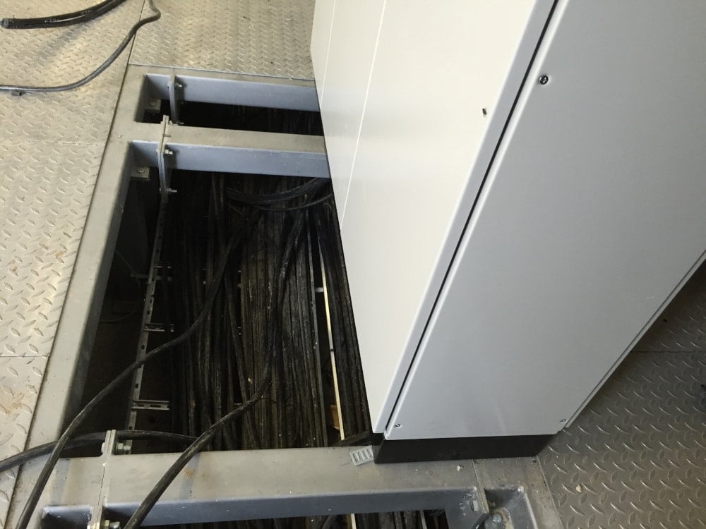

Figure 4 - A common substation switchgear room. The tight confines beneath these cabinets make the smaller bending radii of Category A (earthed) cables highly advantageous during installation.

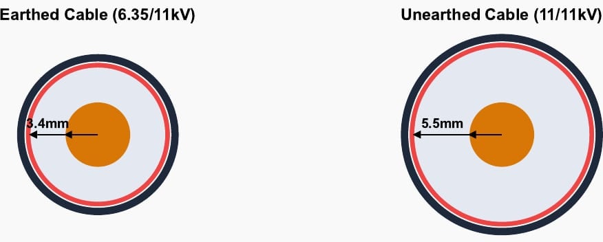

6. Design and Construction of Unearthed MV Cables
Unearthed MV cables, engineered to satisfy the rigorous demands of Category B and Category C networks, are fundamentally heavier, thicker, and more robust structures. Knowing that the network will intentionally operate with one phase grounded for up to an hour, the dielectric must act as an impervious barrier against the full 173% line-to-line voltage.
In the cable industry, this is often referred to as specifying a "173% insulation level".
Returning to the 11kV network example, an unearthed cable is rated at 11/11kV. According to strict manufacturing standards, the XLPE insulation thickness for the same 185mm2 conductor must be increased from 3.4 mm up to approximately 5.5 mm.
While a 2.1 mm increase might appear mathematically trivial, when applied radially to a circumference, and then multiplied across all three phases in a multi-core cable assembly, it dramatically increases the aggregate volume, mass, and cross-sectional footprint of the finished product.
Figure 5 - Comparative scale of insulation thickness for identical conductor sizes
This increased volume requires substantially more extrusion material, larger interstitial fillers to maintain a circular profile, and larger quantities of steel wire armor (SWA) to encapsulate the wider assembly. From an electrical perspective, the altered geometry significantly changes the capacitive signature of the network.
The thicker insulation reduces the capacitance per meter of the cable. In highly extensive networks, this shift in distributed capacitance directly impacts the tuning calculations required for Petersen coils, which must be perfectly calibrated to inject inductive current that precisely cancels out the network's capacitive fault current during an earth fault.

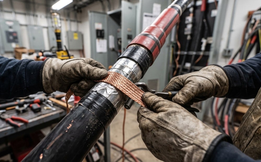

Figure 6 - Substation technician attaching a grounding braid to the copper screen of an MV termination. Precise stress control at this junction is important in unearthed networks.
A specialized technician attaching a grounding braid to the copper screen of an MV termination. Precise stress control at this junction is important in unearthed networks.
Figure 6 - A specialized technician attaching a grounding braid to the copper screen of an MV termination. Precise stress control at this junction is important in unearthed networks.
