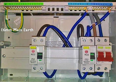

11. Additional equipotential links
These are used to ensure the continuity of the protective circuits:
  1. Between exposed conductive parts: the cross-section is at least that of the smaller protective conductor of the two exposed conductive parts to be linked.
  2. Between exposed conductive parts and conductive parts: the cross-section must be at least half that of the protective conductor of the exposed conductive part to be linked.
In both cases, a minimum of 2.5 mm2 is necessary if the link is protected mechanically (in an enclosure,  ducting, sleeve, etc.) and 4 mm2 if it is not protected (flexible wire). These rules are applicable to the removable panels and doors of electrical panels and enclosures when no equipment is fixed in them.
When equipment is fixed in them or there are specific risks of indirect contact with these exposed conductive parts (feed-throughs for controls, no faceplate, etc.), flexible braids provides an ideal solution for all installation requirements.
Earthing bolt on the switchboard roof

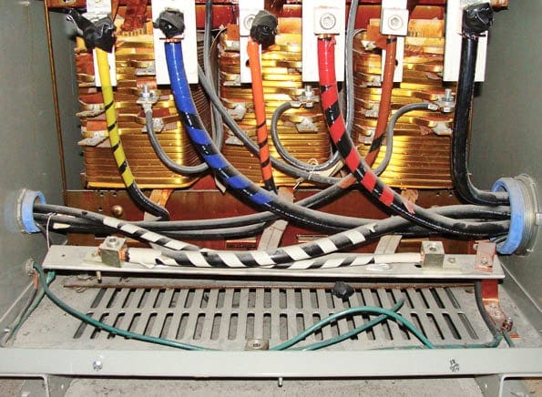

13. HV/LV transformer protective conductor
The cross-section is determined according to the type of conductor, the power of the transformer and the reaction time of the HV protection.
In practice, its cross-section is almost always identical to that of th main protective conductor.
